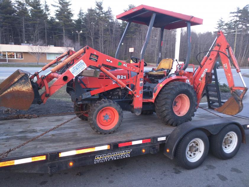

bought a B21 yesterday with ~1300 hours on it with a broken differential.
The official wording from dealership was:
"Removed the backhoe attachment, removed the seat assembly, removed the fenders to gain access to the transmission top cover. Removed the top cover and found ring gear bolts are sheared off, the ring and pinion gear set, carrier, rear axle case, and some transmission gears damaged. Estimated cost of repairs $6500."
Will any of the other B series rear cases/ differentials bolt right on? I'm capable of doing the work just don't really have ~20+ hours to tie up in it right now. I paid $1500 for it so I'm fine with putting some money into it.
What have people ended up spending to fix this type of issue and how many hours did it take you?
