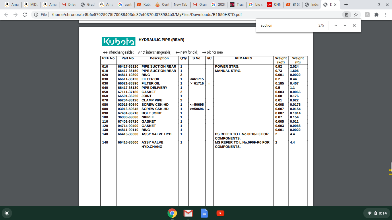

I have read that the hydraulic screen behind (next) to the passenger rear wheel may need to be cleaned. It is reference number 030. I plan on cleaning mine soon because my power steering is pretty weak right now. Good luck..even though I;m about a month late.
