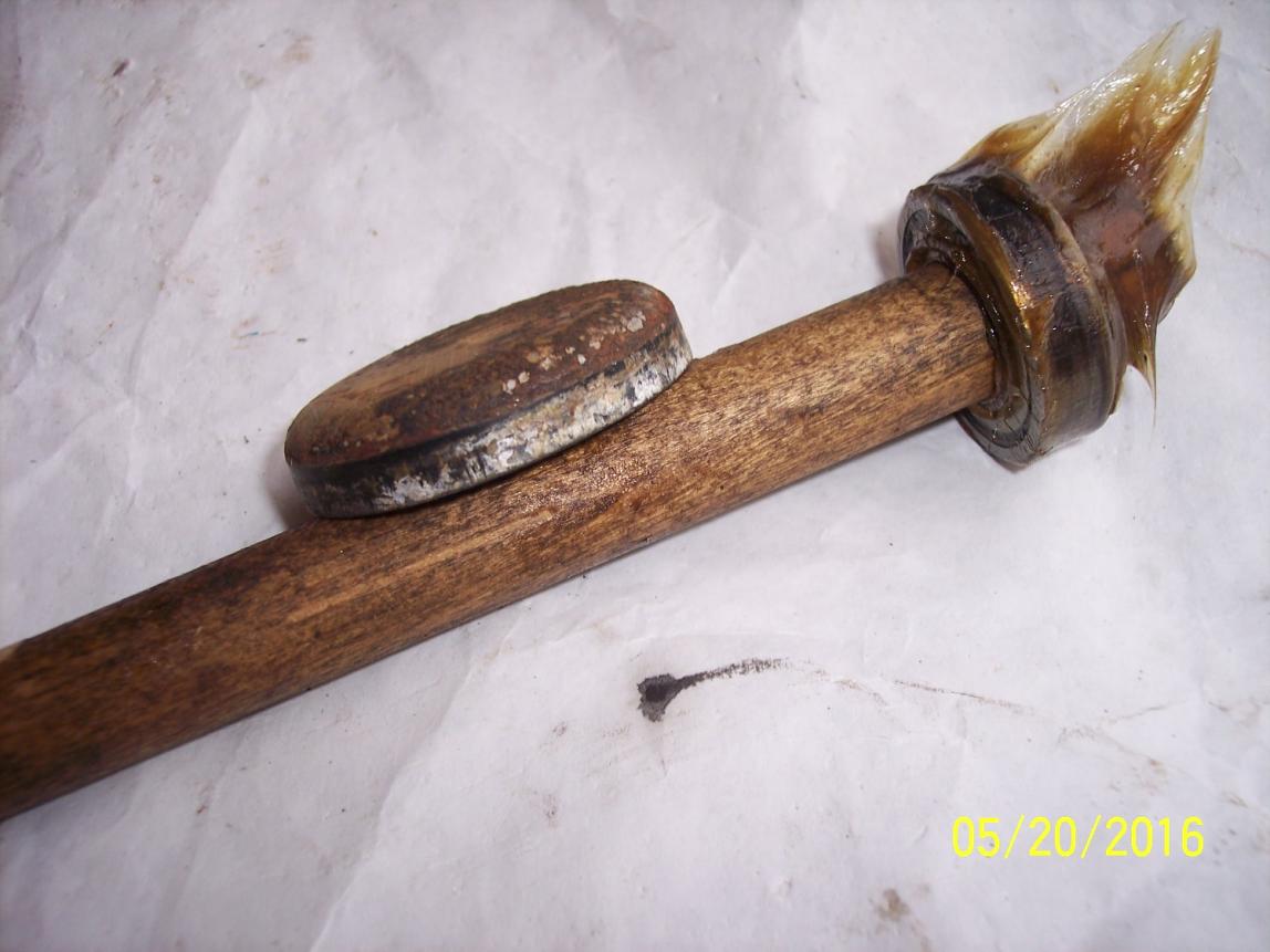

zmanfj40, make a wooden dowel that "just" fits into the existing bearing. You can make this from an existing piece of wood you may have, or use a piece of a broom handle and work the OD down on your bench grinder. Make it so it just barely fits into your new bearing.
Then fill the hole inside the bearing with grease from your grease gun. Put your dowel in the hole and tap it with a hammer. You may have to do this process a couple of times(and add some grease) but it will come out.
Hydraulic pressure at its best!!
10,003
6,809
Wow 'Cat - - that there is fascinating!
Ingenious is the other word that comes to mind....
The picture helped me, hope it helps the OP as much..
'Nuf said, don't want to get the thread off-track....
