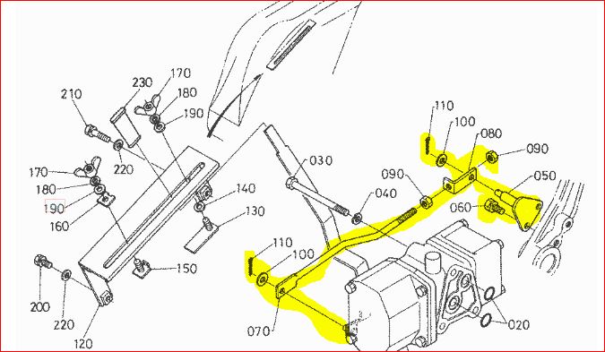

I will move it to the garage where it is warmer to work on. Temps down around 10F with significant snow forecast over the weekend. Based upon the schematic it appears I will need to tear this thing open. Not real confident I have the skills or tools needed.
14,370
6,635
Before you remove any parts, I think Wolfman was suggesting to only look at the parts highlighted in yellow to determine they are all connected as shown. Not bent, disconnected or broken.

Understood, thanks. I did check the linkage and everything seems to work properly. Nothing bent, disconnected or broken. I contacted another dealer and they indicated parts were available and they thought it could be fixed. The labor rate and time is what drives the cost obviously. Used it this weekend to plow snow and drag culled trees. Just inconvenient to keep holding the lever up when moving snow. Any other thoughts before I call the second dealer to come pick it up? I appreciate the advice.
