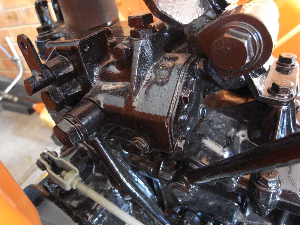

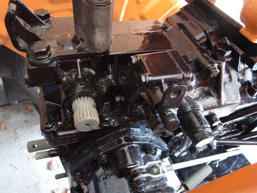

thanks for the response, much appreciated. I have another related question. Could the rear be missing any other parts around the PTO judging from the picture below? Sorry for the image size and quality. Also, I guess there's no way to test out the hydraulics without adding a 3 point hitch? I haven't managed to get out to the tractor yet, but will have the weekend for a good look around it.

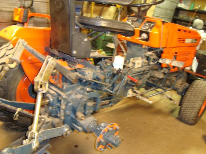

Hey Guys, GREAT FORUM! Really informative and enjoyable. Along the same lines of this topic, I have an old 5100 that which needs 3PH hard ware. It is classified as Cat. 1 and I am finding 2 different lengths: 28" lower arms with 20-25" lift arms and top link OR 23" lower arms with 15-19" lifts and top link. From what I can tell, the shorter hardware seems to be correct for my tractor but anyone know for sure? Thanks, Doc

thanks for taking a look for me. I got the tractor for a great price and she runs beautifully, but this might be her Achilles Heal? It would be great to know exactly what i'm up for installing.
As you can see, what you thought was some kind of cap is the previous owner being overzealous with a paintbrush, I think it's undercoat.

thanks for the info. I did see there was no horizontal depressions up the pto shaft, but it's still 18 splines. I'll confirm the direction, but i'm not expecting it to be different from the normal B6000.
Dusty-t, your picture shows quite well what I can't find in the B6000 parts manual, ie. (for want of a better word :confused:) the assemblage around the PTO Shaft for which the tractor just has holes or protruding threads for bolts or nuts.

There is nothing missing from your pto shaft. Its standard 18 spline b6000. The four bolts you see are too hook up a rotary hoe for the unit - S850. The hoe uses the 18 spline pto shaft and the four bolt holes for attachment rather than a standard 3 ph.
You will need to buy an adaptor to use a standard slasher though that converts your 18 spline pto shaft to the standard 6 spline 1 3/8 dia. shaft see http://www.bareco.com.au/files/pto2002/pto8.htm these are around $70 AUD.
Your pto will run CCW but I don't think this is much of a problem for slashers - see my earlier posts.

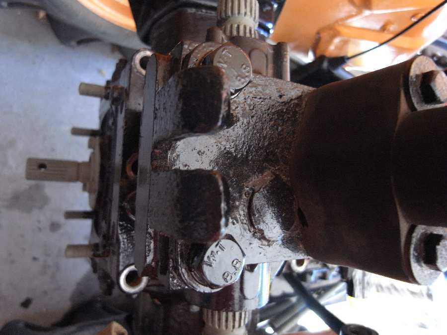

well, I finally got an opportunity to check out the B6000's hydraulic problems. For starters, I emptied out the transmission oil which I think is about a litre under what it should be....not a great start. It looked a bit dirty, and a little silty right at the bottom. No strange smell, no milkyness in the main fluid.
I then checked out the hydraulic filter and that was really very clean, just the odd, maybe 1mm square gummy white bits, which I cleaned off with Kerosene. Just inside the transmission bottom there's a few very fine metal shavings and a few grains of dirt.
Then I unscrewed and took off the control valve. Moving the valve with the pliers, it certainly was moving ok. It seems to partially cover the exit to the rockshaft and such on either side when moved backward and forward, one half covered, then the other. I guess this is correct behaviour! I decided against proceeding in taking apart the valve assembly further. One thing I couldn't look at or get to was the relief valve, which I believe is inside top.
One thing I noticed here was there didn't seem to be much oil really, and there was a little milkyness, only slight, in what came out of the valve.
Then, I removed the 9 top screws that appear to hold on the rear case top. However, it wouldn't budge for love or money! I then tried to remove the front section where you can feed off the hydraulics. On my Japanese B6000 there's just a bolt there. Here, the oil was quite dirty and there was a noticeable burnt kind of smell. Also, a fair small fingernails worth of white gummy material. I unscrewed the 4 bolts holding this on, but again, while there was some play, I couldn't get this to budge either.
I added a few pictures below. What's on the tip of the screwdriver is what looked a lot more milky in the other photo shining into the auxilliary hydraulic outlet. There are 2 showing what bolts I removed on the top to try to get the top off. The last just shows where I took off the control valve.
I don't have any easy way to check hydraulic pressure or flow, so I haven't done that.
So, onto my questions...
* is there enough evidence hear to start drawing a conclusion over the problem, what are your thoughts?
* could gummyness be due to this oil not having been changed for a long time (I have no idea when it was last done)? I guess milkyness is water? What could the burnt sort of smell be caused by up where the auxilliary hydraulics would exit?
* How do you remove the top rear case, and the front hydraulic feed? I'd like to see if the piston seals are ok. There are 2 screws on the horizontal below the top case on the back of the tractor that are connected by a piece of wire. The diagrams I have suggest these hold on a plate inside, so is not a good idea to take these out then? Is there anything else I need to undo to take this top off, or is just a matter of brute force? If I took it off, would I be up for a new case seal?

Hey dookanooka. I believe the rock shaft is the top shaft with the splines. Everything you have discovered at the back of the tractor seems to indicate that the hydraulics have not been used for a long time. I imagine the tph lever was cut off so that it didn't get used and make that awfull grinding sound. I would have a look at the hydraulic pump. That is where I would start. There may be nothing wrong with the rest of the hydraulic system. Just my opinion, and I have been wrong before. Good luck and keep us posted. :D:D Dusty

hi Vic/Dusty-t, so, it sounds like that piston cover should come off without much trouble...interesting! It did feel odd, it twists left and right, top and bottom about 2mm, but take pressure off and it returns back into position. I was reluctant to really give it some stick, but wasn't exactly gentle.To me it felt like something rubbery with a memory was holding it in. Maybe it was the O ring twisting and it's the piston that's seized then.
I'm still a bit confused over why the rockshaft had an inch odd of rotating play when I first got the tractor, and now having moved the lever forward and got the grinding noise, there's no movement whatsoever?
I'm thinking i'll get a new pump, swap it over and get some oil circulating round and hope that gets everything moving again. If that doesn't work, I have a feeling things might get complicated, and perhaps I should cross that bridge if I come to it!
