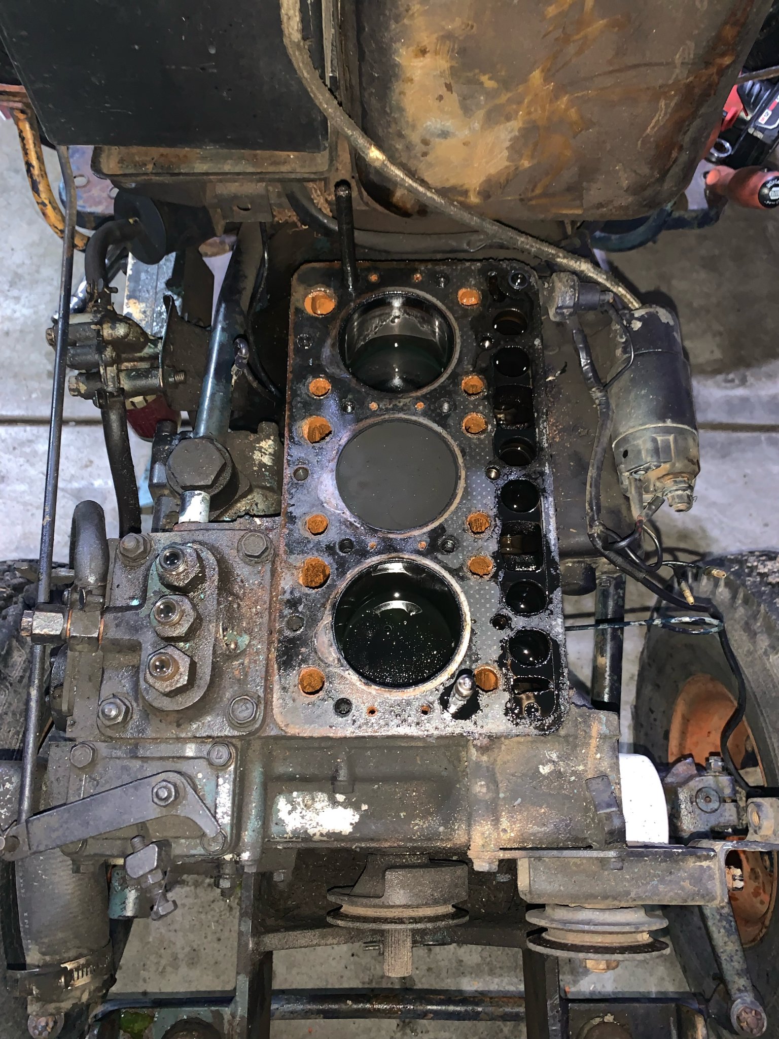

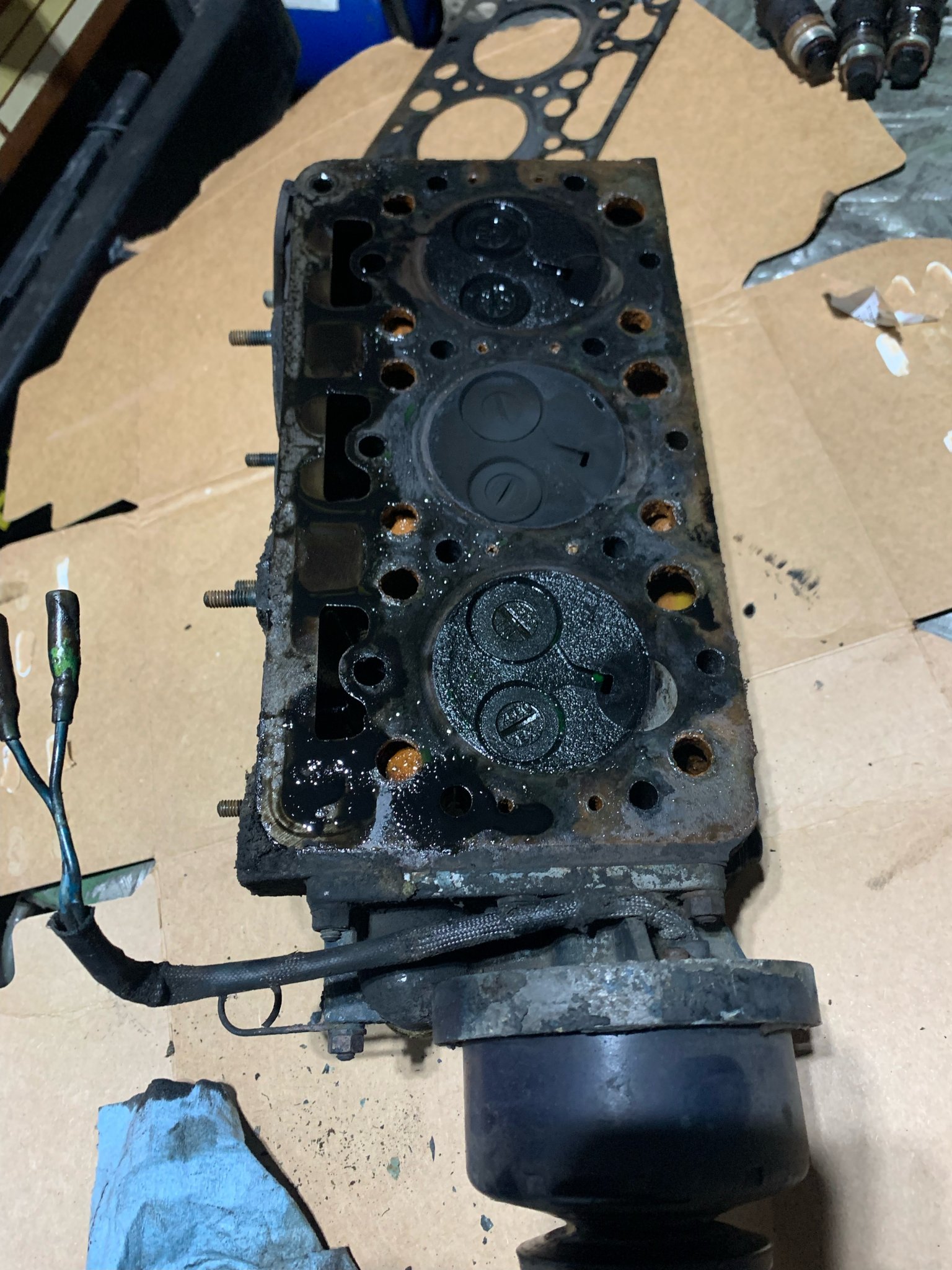

Ok, I know its been a while, but I received the compression tester and did a compression test. All the cylinders were about 250 psi dry and with a tiny bit of oil in them. When performing the test, I hooked it up to the glow plug and cranked on the engine. It did take almost a whole minute of cranking (total cranking time) to get to that number then it stopped climbing on the gauge. Makes me think the rings are just completely gone. I put the glow plugs back in, adjusted all the valves(all were loose by a few thou, one was loose so much so .010 slipped under the rocker easily), and tried to start it. Won't pop off or anything. Just blows lots of white/few puffs of black smoke when cranking. I did also bleed the hard fuel lines. As I'm writing this I' m realizing that I should of checked the compression again after adjusting the valves. Too late now.
So, I decided might as well as pull the head and have a look at this point because why not. Cylinders 1 and 3 were completely soaked and had a little bit of standing diesel in them. Number 2 was dry as a bone and was just carboned up. At this point the cylinder walls look great with no scarring and the pistons look great too. I'm beginning to think that the injectors are bad, which after 45 years is understandable, and the valves being out of spec were my problems. I'm new too diesels, but would this sound like a logical answer. I guess I can always buy new injectors, and a head gasket and see if that helps if not, then do a full tear down and rebuild. Attached are pics of the block and head, on cylinder 3 it is just a oily smudge from where I wiped the wall with my finger.

I think the wet your seeing is antifreeze and not fuel, but could be wrong.
While you have the head off measure the cylinder diameters, I bet they will be out of spec and it's going to need new liners and pistons.
FYI:
With the valves being loose, and you tightening them it will not change the cylinder PSI, if anything it's going to go lower not higher.
It won't start at 250 PSI.
With the compression numbers your posting it needs a complete rebuild.

After thinking about adjusting the valves, I realized that being loose the valves would be closed anyways. I thought at first it would be antifreeze but it was very green in the few drops that were from around the valves. So concluded that it was straight diesel. I would like to do a rebuild instead of just replacing it because from I've researched the prices are about the same. Does anyone have any good links to rebuild kits? Kumar bros has everything but the sleeves, would it be possible to just use that, I don't have the correct tools to measure the roundness of the cylinder.
Mark_BX25D
Bx25D
Jul 19, 2020
1,781
1,301
Diesel is not green. Antifreeze is green.
But it's a moot point since it needs a rebuild.
Looks like the coolant had been neglected, anyway. Lots of rust in the water passages.
Nothing a good hot tank won't clean up!
