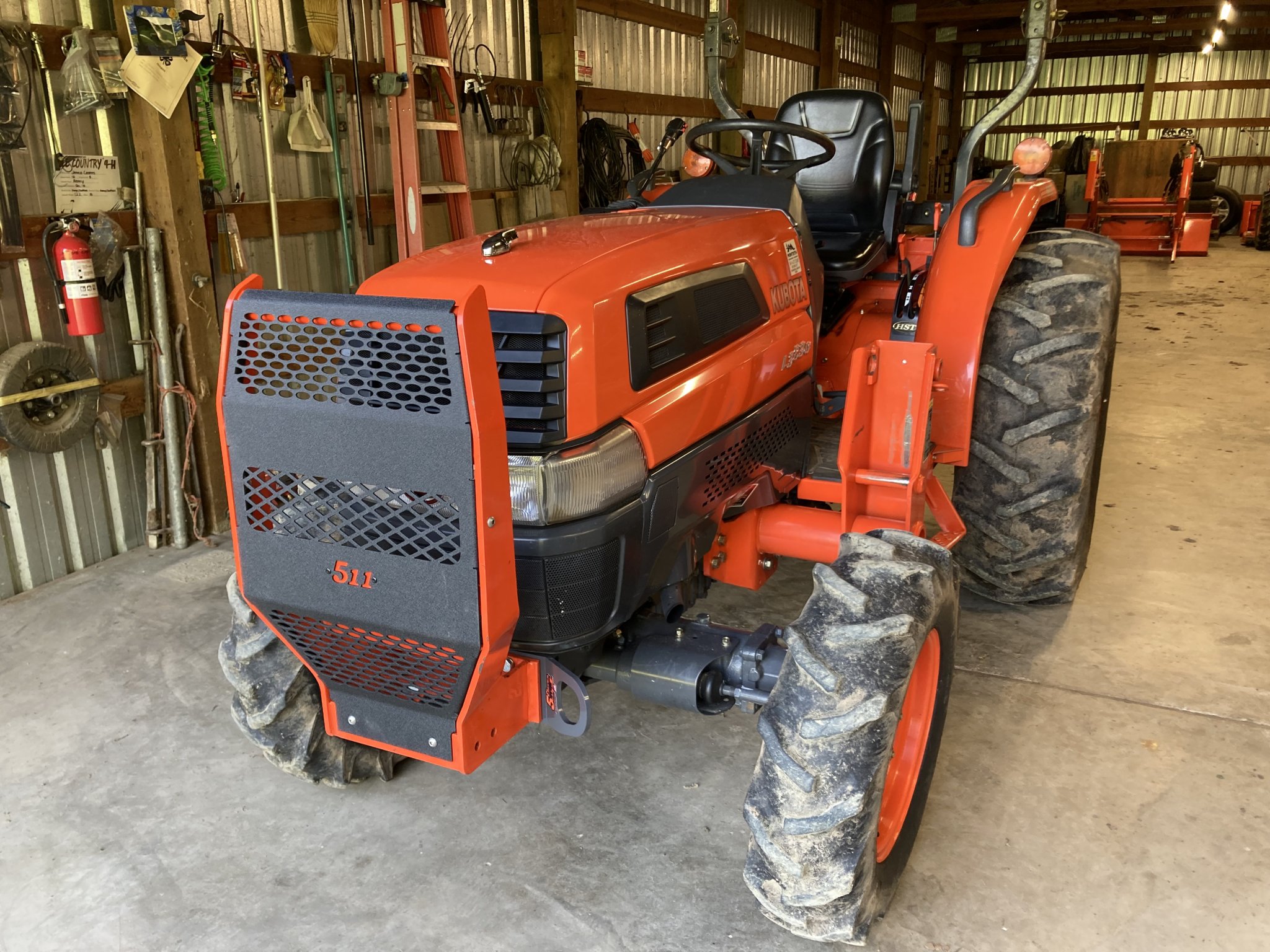

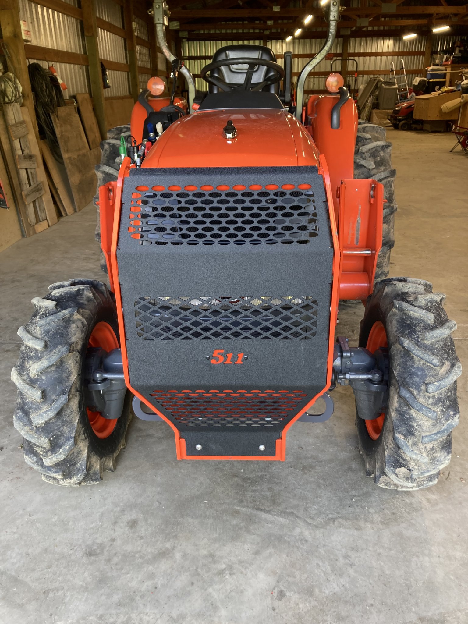

5Eleven design has some nice tie down points that mount between the brush guard and the frame. See attached photos of my tractor with them. Before that I ran a chain behind the brush guard with a piece of fire hose to protect the paint. Still do it thatvwayon my little B.

View attachment 106613 View attachment 106614
Nice rig. Thanks for the info.

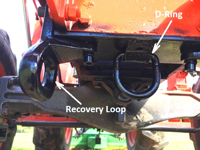

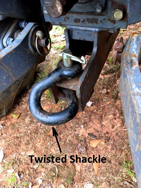

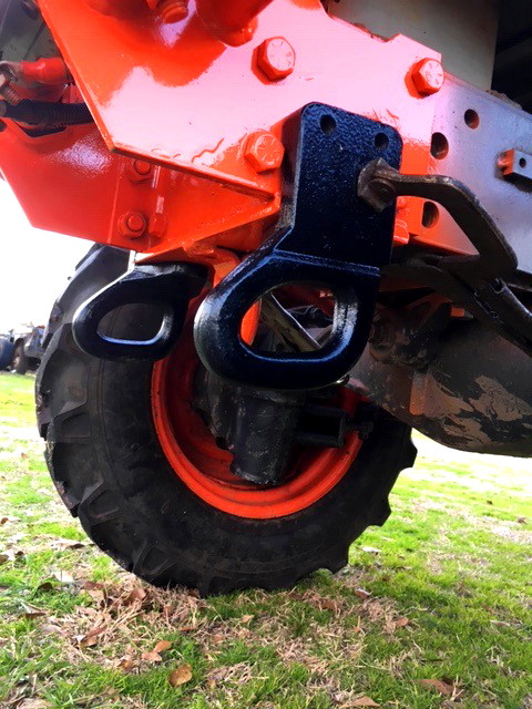

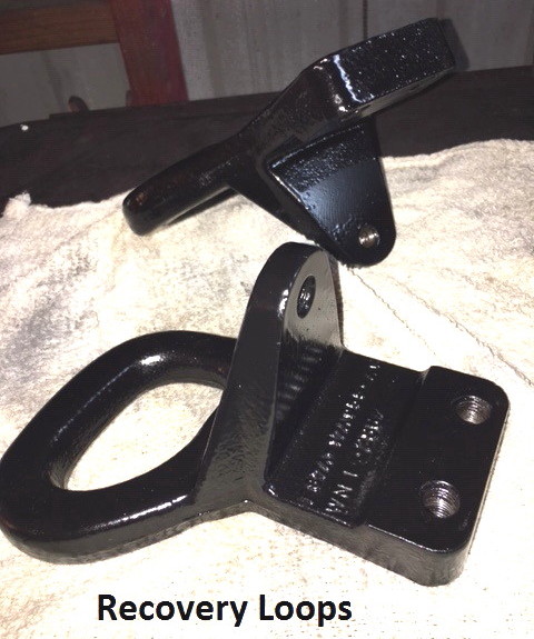

Agree that tiedown/recovery points would be the way to go.
My tractor had neither on the front....so I added some.

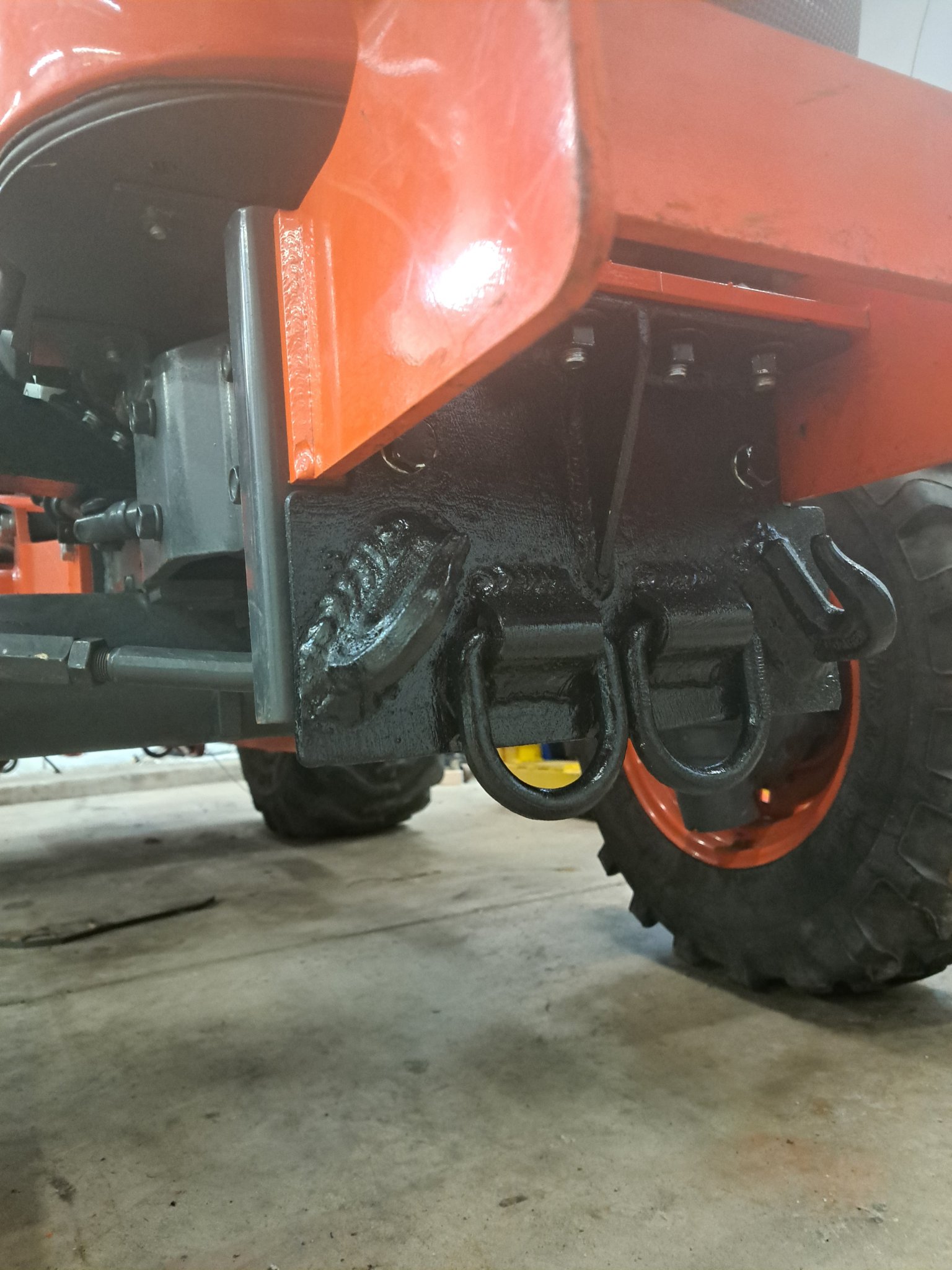

When I decided to switch to chains and binders, I fabbed up a plate and added hooks and some D-Rings for the front.
Back is just a Clevis/Shackle attached to drawbar when Stonewall isn't on.

Impressive fab work! I like it. Thanks for sharing. I think yours is the only front tie down system that has the chain hooks themselves right on the tie down plate itself. The rest allow for a chain and hook to be looped though or for the chain’s hook to be placed on the loop.

Thanks man.
I basically couldn't decide on hooks or D-rings so I figured why not put both on?
Overkill? Probably, but I got more weld time so theres that too...Hahahahha
I did a little write up about it if anyone is interested.
https://www.orangetractortalks.com/forums/threads/chain-mount-for-front-of-l2501.61672/
It was a pretty fun build and it makes tying the General Lee down very easy.
