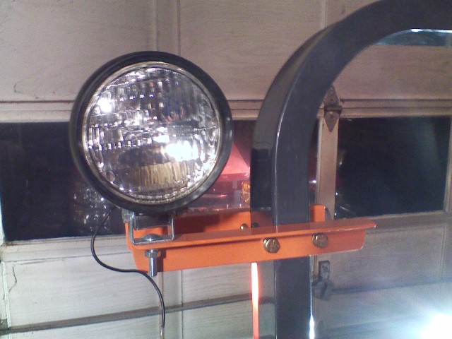

Dry fit so far...The light pointing to the back will be added later right behind the other. You might see the hole to mount it.
Not sure yet if it will be round or rectangle light.

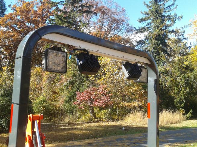

If you encounter a lot of tree branches, you might want to put them inside the ROPS to protect them.
15,341
4,653
What BAP said,, I put lights on top of the ROPS, and cleaned them off the first trip through the orchard..:eek: I tried them under the top of the ROPS but alas my big head and body got in the way of the lights. SO I take the over head lights off in the summer and put them back on after the mowing season is over and that way I can just use them for plowing snow.. MAYBE a very low profile set of LED lights would work on top of the ROPS covered with something heavy enough to keep them from being pealed off by low hanging branches,, just a thought

The ROPS on the 50 and 60 series is if your a bit on the tall side not much above your head, and the glare from the lights is more of a problem than a help, on the new 70 series the ROPS is higher and foldable so just being higher would help. I have a coupe of ideas for lights on top but I first need to figure out what kinds of lights. Wildfire has the lights that light up the night to be sure ,and I think a low profile LED will be the way to go, and I think something heavy like some aluminum diamond plate for a mounting bracket and cover/guard and a few stout bolts might be the ticket

Local hardware store is getting in some plain ol' round sealed beam tractor lights (like the one in the earlier picture) and some rectangle 55w halogens. I made the bracket long enough to take a rectangle if I chose that route.
The hardware store let me borrow the light in the picture to get me started. A small town is a good thing.
I like the idea of rotating the whole thing 90 degrees - that will be a "Plan B" if this is a problem.

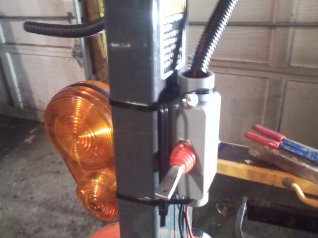

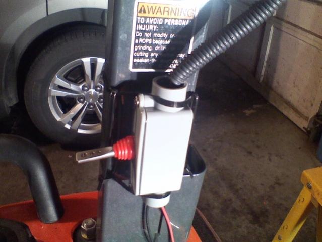

Switch is set ($8 at NAPA), but need something to make the top end shed water. Just zip ties to fasten - figure it better if it breaks away than break altogether.
The "switch box" is just a PVC 1/2" conduit fitting with rubber gasket cover. $2.83 at Lowes. The lights are 12V, so not too concerned about it being sealed.
Will bring conduit into the bottom of the fitting, etc.

I'm leaning toward the old style sealed beams for my work lights. For $20, they are replaced. Replacement sealed beam bulbs are now about $15 at the store, but at least you can get them quickly if the bulb blows.
They have some 55W halogens for about $20, but I'm not sure about the heat they produce in the rain/snow, etc. Those bulbs can be replaced as well.
The one in the picture was made in China ($17), and you can't replace the bulb. The owner of the store let me take it just to dry-fit. I made the bracket so it would take the round tractor light or the rectangle halogen - 3x5 or 4x6.
LED's are expensive, so I'm staying away from them for now for the tractor. Since I break stuff, a $20 loss is much better than $150.

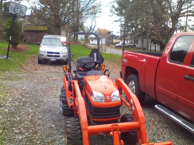

Got 'er done. Might want to think something similar for your 2360. I really like the position - but haven't tried in the dark yet. I don't think the lights will interfere with vision.
Lights are 55w halogens. $14 each at my local hardware store.
If you can see them, there are two large grain bins in the background, to the right of my kids' van. For scale reference, next to a bin there is a white Ford tandem axle truck with aluminum grain box that you can see between the trees.
Three brothers are picking corn on 1,500 acres and will fill both in the next month or so. They bought an old feed mill in town and make livestock feed. Also sell kernel corn this time of year to our New Jersey seasonal hunting residents for deer.
They made an ingenious wood-fired drier for the picked corn between the bins. Takes about a pickup load of firewood at a time. They also made their own wood processor to feed it.
The guys are real workers. They milk about 100 head as well.
As with many farmers, they are great neighbors.

Figured out a way to shed some water off the top of the switch.
Won't be water tight, but its 12v.
Its a rubber adapter for a dishwasher fitting ($2 at Lowes). Used the pipe clamps for something else, and had to slit both connections so they fit.
All tied with zip-ties, just like the mount of the switch box itself.
