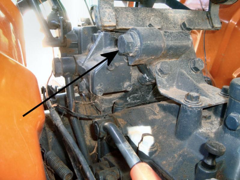

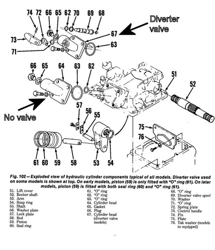

I don't know if this is any help, but here is a breakdown of the hydraulics to my b205 blade. Take note where the hydraulic supply and return tie into the tractor. My setup is actually fed from a hydraulic block next to the break pedal so I don't know exactly where the pressure line ties into. But if you can make this work at least it gives you the size of the parts you need.

Seen the same set up on a b6001 I looked at and it had a diverter valve like a big switch fitted there so you could work a snow blade on the front. You just switched the valve to what you needed and controlled the lift by using the linkage lever
Yes you are correct, had to read through the directions and it does tie into that diverter valve. :rolleyes::D

Thats a lot of useful information!
Best thing would be to find a second hand diverter valve to put in.

I don't know if your tractor has one but is there a block inline of the hydraulic lines next to your brake pedal? If you do you can get a diverter plate that bolts in place of the existing cover plate. It is part number 70070-00385.
