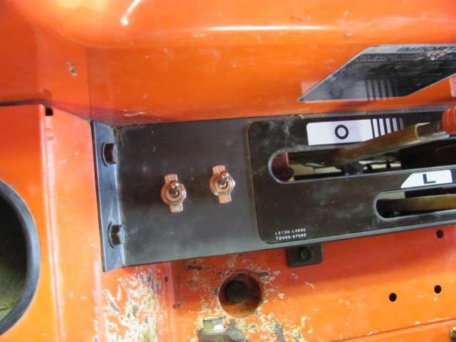

If you look close at the picture of the left side light, you will notice the switch just to the right of that. Same for the front lights. It is up out of the way and out of the weather. I was going to mount the switches in dash, but could not get myself to drill holes in the new tractor. Besides that, I would have had to run more wire to get to and from the switch. I thought this way would have been a little neater job!

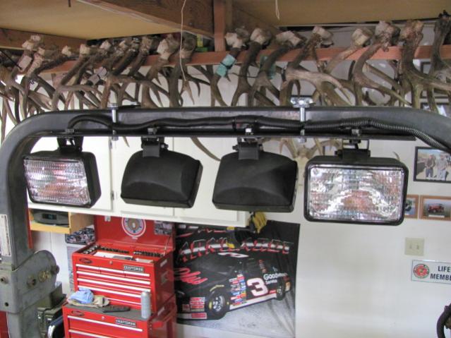

Howdy gang... I want to add work lights to my L3830. Ive been looking at lights on several web sites and I think what Im going to do is mount 2 trapezoids facing forward and one flood light facing rearward ( all 55 watt ). Front lights on seperate switch than the rears, my question is do you agree with trapezoids to the front and flood to the rear, I wont be working in the snow Ill be farming in So Cal discing , ripping and general work . These lights will be mounted to the ROPS and no im not going to drill or weld. I dont work much after dark but its always nice to get an early start in the morning, and occasionally I need and extra 30 to 45 min in the evening to finish what Im working on . Ill take any suggestions of any diffrent lighting you may use .... Dan

I mounted the two Traps on front and two floods to the rear and am very happy with my coverage. I also did the two switches so I can control the lighting. My lights were also 55 watts each. I am sure you will do just fine with one flood in rear. I had to put two floods for using my backhoe attachment on mine so I have good light on either side of the backhoe when swinging the boom and bucket.

I insatlled my new lights a few days ago and used them this evening 2 trapezoids to the front and 2 floods to the rear. I like alota light and theres more than enoght light to farm at night.

Nice looking set-up there. should do you very well.

TSC sells 4 different Blazer flood lights, can you tell me which r the ones you guys used ?
I have the Blazer flood lights in the rear, but I have Peterson trapezoid lights in the front.
Trapezoid will give a nice forward beam like the car headlight does. The rear I have mounted floods so it gives a wide light pattern to surround the entire area of the rear of tractor.
If you are only going to use one type of light, you may want to consider using the Blazer Multi Purpose Tractor Light Spotlight Beam. It should give you the best of both worlds.
That's how I ended up with 4 sets on my 9000. No 1 light did what I needed at any given time. I have different light mounted for different jobs.
