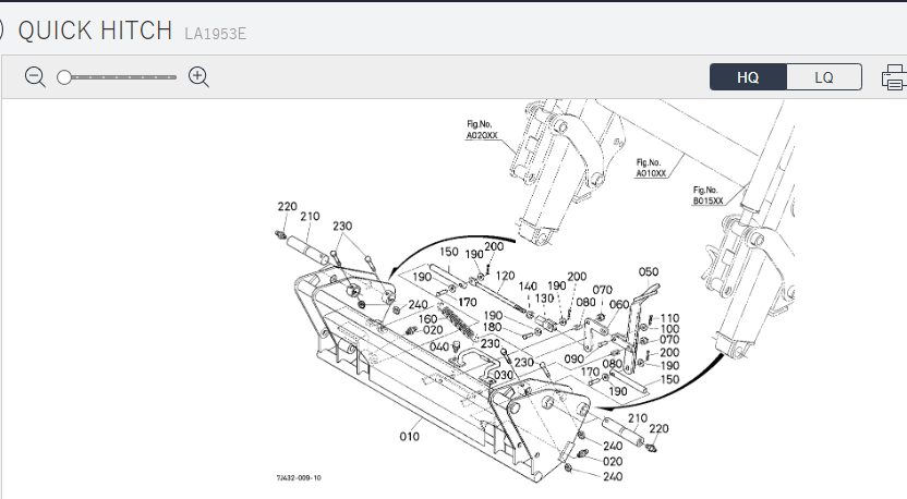

I have an M110X with an LA1953 loader. It has the euro global quick connection bucket system with the single manual lever for the two lower pins. Has anyone seen a kit or fabricated a system to convert this to an auto pin system, something I can control from in the cab when switching buckets? I have seen the Komatsu system which has a hydraulic diverter on the 3rd function valve connected to a cylinder controlling the pins. The euro global is similar in design but I have not found a kit to make the conversion. It seems like this kit should exist as this is a common attachment system, either factory Kubota or aftermarket, hydraulic or possibly electric actuated. Anyone know where to look for this? If nobody has seen a kit for this, has anyone fabricated something they are happy with and willing to share your design? Thanks!

I looked up all the options, I don't see a Factory option for hydraulic closer for that style loader attachment.
I don't see why you couldn't do it, it's just going to take a little design and fabrication.
Yes, that is the setup. I think I can remove the lever system and add a cylinder or actuator between the pins. Just need to figure out a stop so I don't pull the pins to far. If that looks like a hard issue to work around, I might leave the lever system on and connect the cylinder to that instead. That way I retain the stops for the pins. Still thinking that one through. Thanks.
