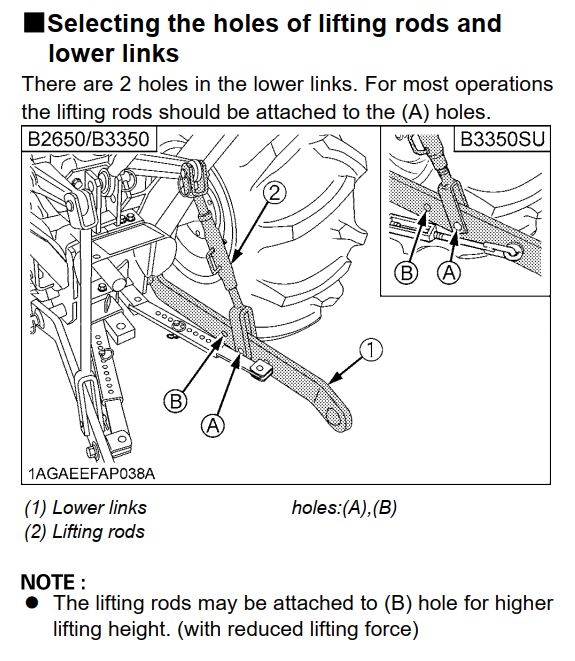

I did buy a longer 6" bit (50" vs 30") which should help me get a little deeper. Also, when looking at the links on the tractor they do not bind on anything but thy will not go all the way down. If there is no bit on the auger I do not think the links will allow the motor to go all the way down to the ground.

What position are your lifting rods in? The closest position (B) should allow your three point to drop lower to the ground. Second, are you sure that the position control lever is allowing you to move it all the way to the lowest position? There is a lock that can prevent that depending on where it's installed (above/below) the position control handle.
They are not in position B so I will have to try this. As an update, I ordered a longer 6” bit (50” vs 36”). The test hole I dug went all the way down without issue. This time I went slow and steady and allowed dirt to pile high before digging further down. Before, I used the arm to kind of pick up the dirt and clear it. The slow method does work better and I was able
To dig a perfect 4’ hole
