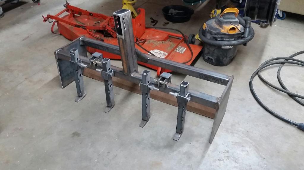

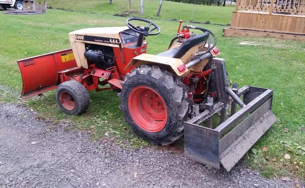

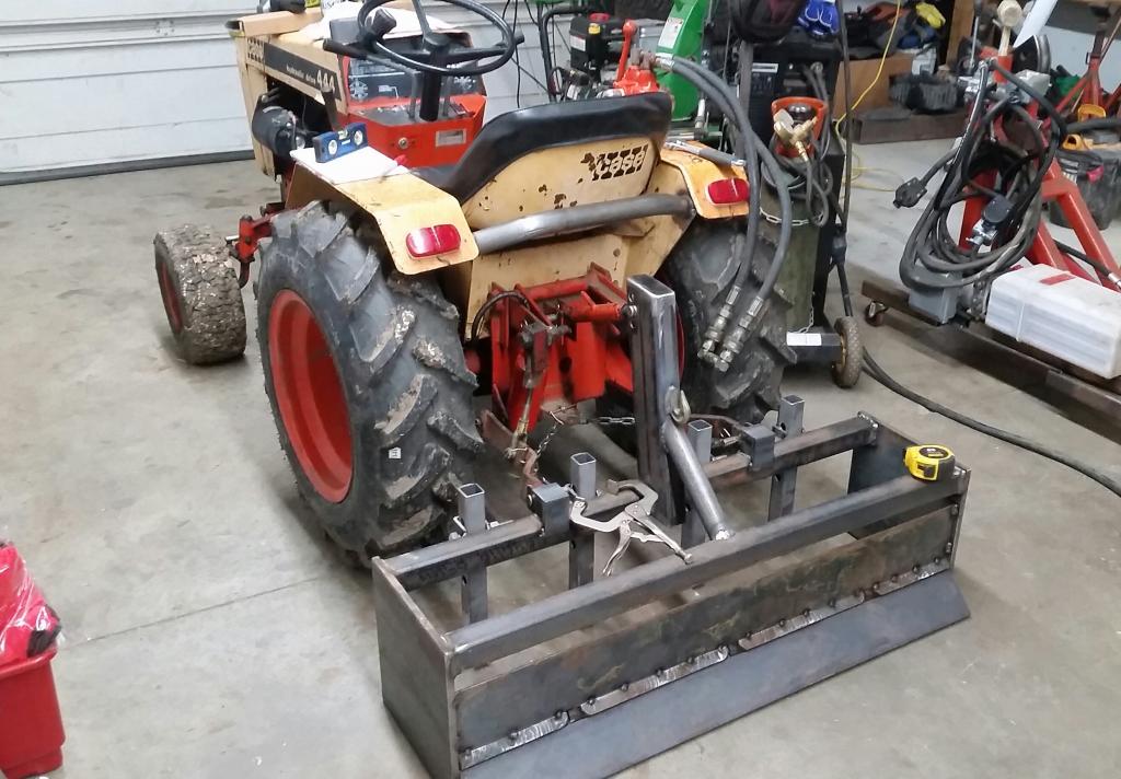

Hello, new to the Kubota world after years using a subcompact (I guess?) 1974 Case 444. Built every attachment I've ever needed. 24" ground ripper, 52" box blade, 52" triple articulating scraper blade, 2-harrow plow, front end loader, roll over bar, etc.. Picking up a used B1550 for a price I can't pass up. Mid mount mower and low hours.
