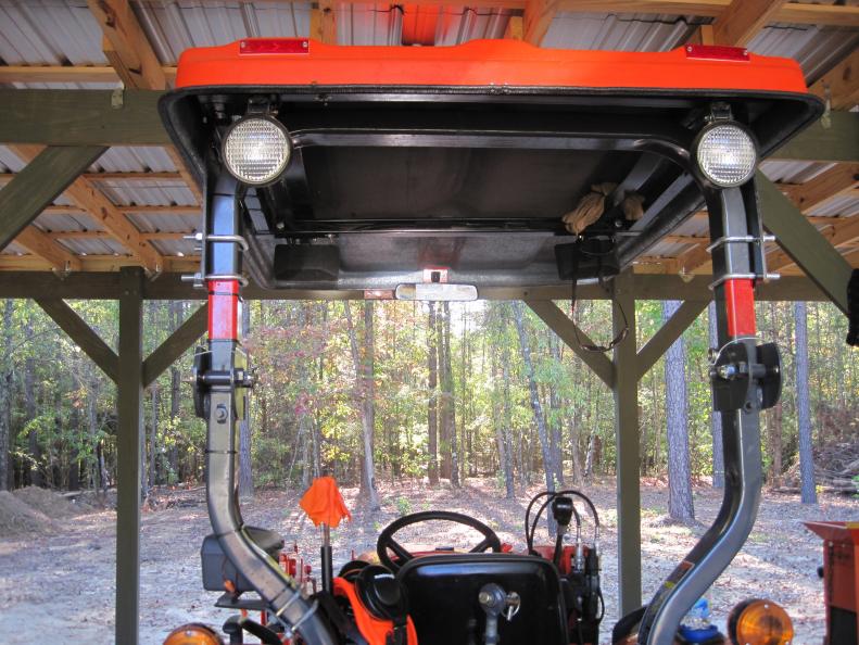

Finished attaching the mirror to the canopy.
I mounted a piece of 2"x3" rubber behind the mounting plate to help absorb any vibration in the mirror so I don't crack the canopy while going over bumps and holes.
Here are a couple pics of the finished product.

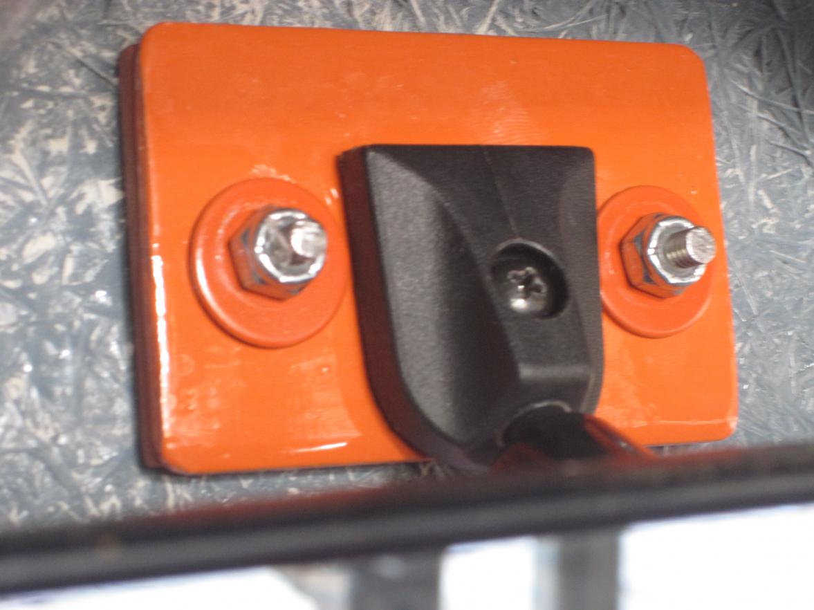

Here is a pic of inside close-up.
If you notice, I had to mount the mirror button upside down in order to be able to see into the mirror behind me. If I had mounted the button the correct way, I would not have enough angle adjustment to lift the mirror up to see the traffic behind me. I would only be able to see my lap!
I did drill a deeper indent into the button so the retaining screw seats deeper into the button so the mirror would not slide off the mount. It was the only way to do it that I could see. I tried every angle and this was the only way it would work for me.
