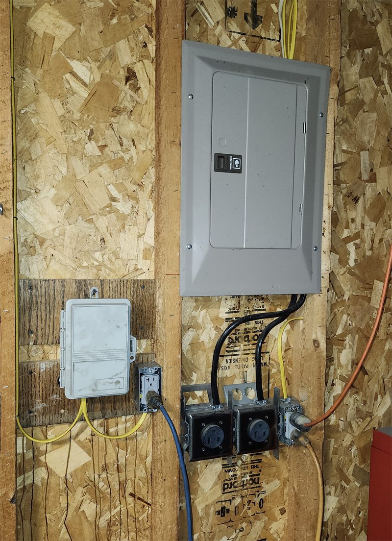

Here's what I have in the garage. It's a 50A water heater controller which can be turned on, turned off or set to timer mode. I have a GFCI 20A outlet connected to the timer, and the on/off intervals are in 30 minute increments. In the image below I have the timer set to turn on at 7:00am and turn off at 10:00am so the extension cord plugged into the outlet and the truck will provide power to the block heater for a maximum of 3 hours.
