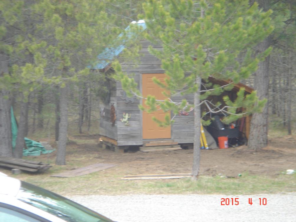

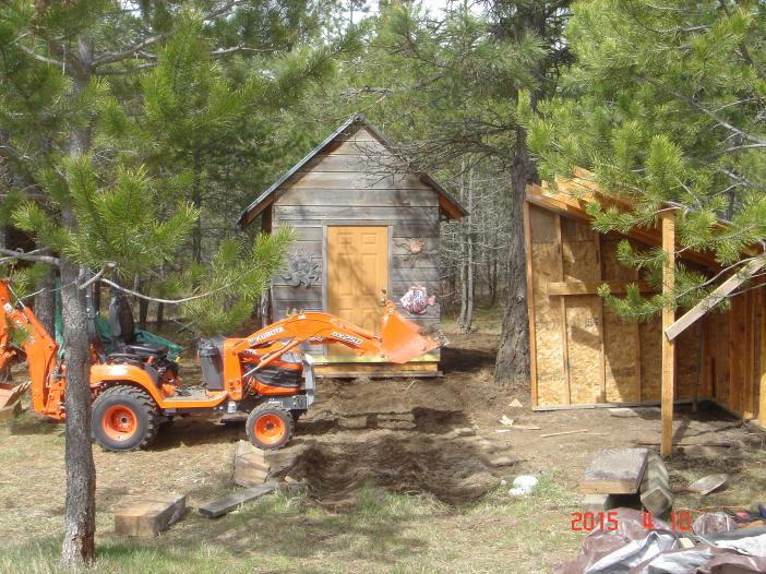

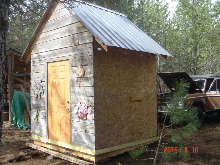

I decided to move a 10'x12' storage building, with a lean to attached to one side. The goal is to widen the driveway turn around in front of the shop by about 35'. Fortunately the PO hung the lean to with Simpson ties, although it was screwed, stapled and nailed with an assortment of misc pieces from a parts pile. I knew my little BX couldn't push it, so I cleared a few extra trees behind and rigged my Bronco, and used the Warn winch. After removing about 20 little saplings ( gotta love how the Piranha hooks small trees and pulls them out of the ground) back dragging off all the pine needles, cutting and unscrewing the lean to, it moved fairly easy. Got it jacked up, leveled and on some PT 6x6's. I had to get some help from the neighbors as it took 4 of us to move the lean to, and get it close enough to re-attach it. I used Ticos on the Simpson ties, instead of the mish-mash of drywall screws etc.

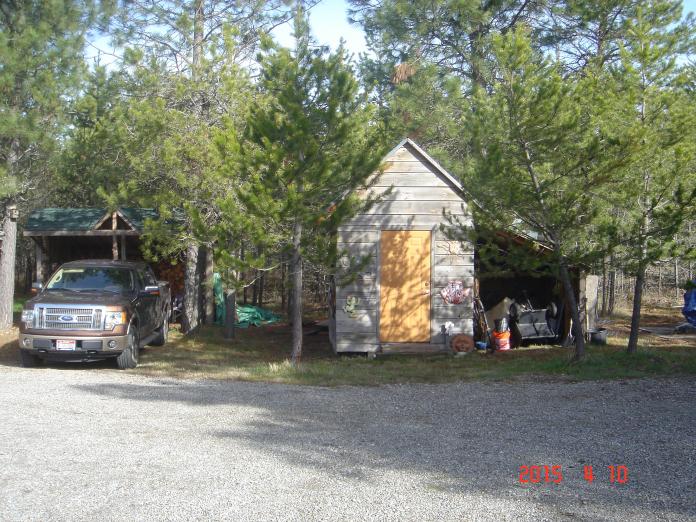

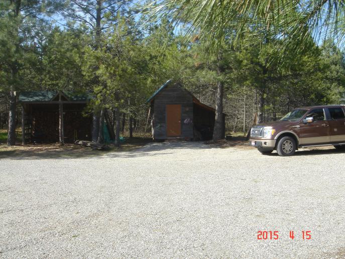

got the last 3 trees taken out. No more than two pushes with the Piranha on each tree, to pluck them out, roots and all. Sawed them up, then laid weed screen and about 15 buckets of gravel. Now there's way more room at the end of the driveway to turn around, and extra gravel to park on. The UPS guy came to make a delivery, and was really happy he could easily U turn instead of backing and doing a 3 point turn.
here's with the last three trees in place, then all graveled in.
