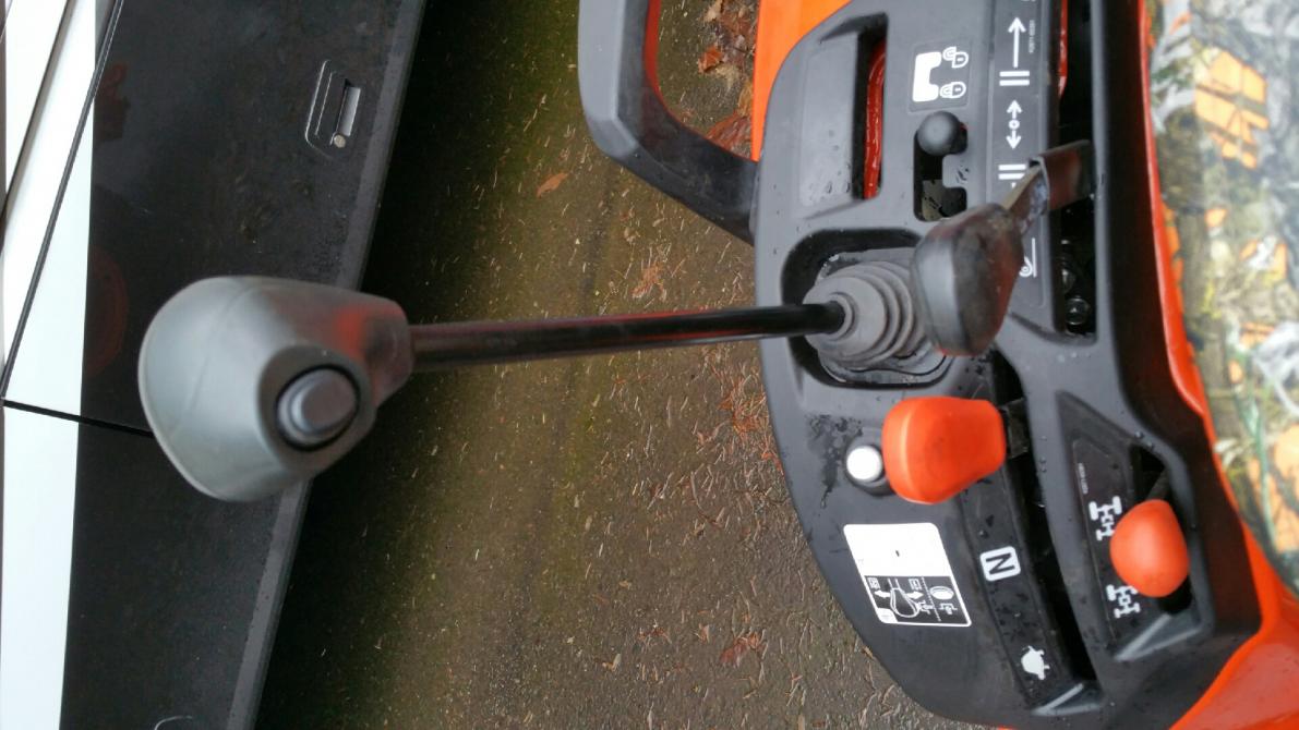

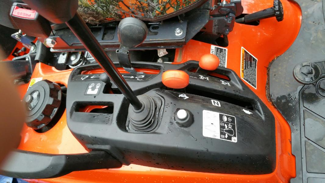

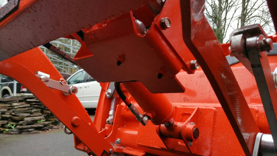

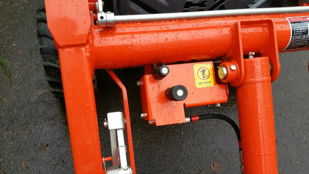

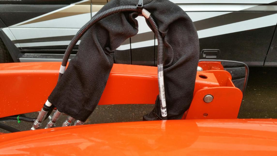

Resurrecting an old thread to add info about the newer BX 80 series Kubota 3rd function kit. I had my dealer install this (PN: BX2412) kit this week.
Kit includes the new FEL handle with button, new right side fender trim plastic piece with molded in power on/off button, hoses, wiring, valve, metal shielding at front of FEL. Kit does not include hydraulic connectors.
My dealer did a very nice job, it looks factory installed even running the stick button wiring inside the handle, no exposed wiring.
In addition to the kit plan on connectors, a hydraulic fluid top off (less than a quart) and 1.5 hours labor.
One consideration for BX tractors: This functions as a diverter valve instead of a true 3rd function. The information I got was the BX was lacking hydraulic capacity so it cannot curl and clamp at the same time. So, with the button pressed left & right on the FEL controller clamps & releases, button released the FEL curls with left & right.
Dealer was Dan's Tractors in Battleground, WA. As always superb service and fair price working with Dan's!
I've included some photos of the install.

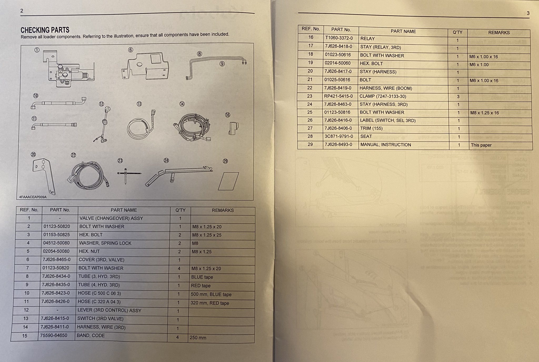

I found a BX2412 kit. Brand new. Can someone help me find a list of contents it is supposed to have so I can verify? I've been all over Kubota's site and can't find a BOM for the kit. My dealer is clueless.
Also, another dealer out of state said that his screen showed there was an additional part required to purchase when getting the BX2412 kit, does anyone know what that additional part is or what it costs?

Hi, new to the forum but I just happened to have picked one of these up this week. Attached is the parts list. The kit was $650 without installation.
As a clarification to an earlier post, it doesn’t come with a new cover (lever guide). There’s already a hole with a plug in the existing cover that you pop out, insert the on/off switch. and then put a sticker on it.
The on/off switch does not have a rubber boot unfortunately. Hopefully that’s not an issue someday.
The rubber booted switch that actuates the valve is at the top of the control lever and the wire runs inside the stick which is slick.
The kit does not come with the quick release hydraulic connectors pictured in Post #8 (Redbusdriver’s post, 2nd photo) which appear black. Instead, the ports are just capped off. I think that this is the only additional parts that are needed to connect to the hoses of the grapple, etc.
The BX# for the kit is BX2412. The part number is 7J626-97020. Including this as most dealers tried to sell me the Land Pride kit which (as I understand it) appears more aftermarket than stock once installed but performs the same function.

Thanks for the pics. I have had an issue with the hydrolic terminals on my bx2680 where the top most terminal will start to lose and then I have to remove the guard plate and tighten that back down. This is the top terminal in pic number 2. This is the one that is attached via an "s" shaped pipe fittings. Have you had similar issues? Any fix?
