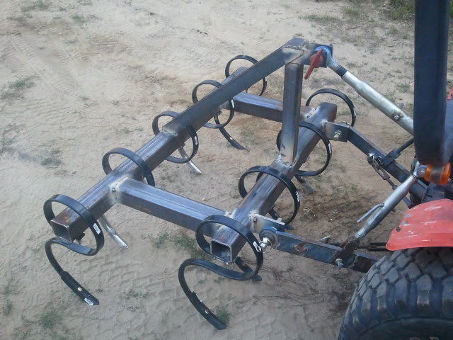

I just did an arena with exactly the same issue, but in the US version of your grass! :D
This is what you need to pluck all the grass out.

Another option worthy of mention is to change out the cutting edge on your grader blade to one that has some short "teeth" on it, or attach teeth to the existing cutting edge. The suggestion of a spring tine cultivator is an excellent one as well.
