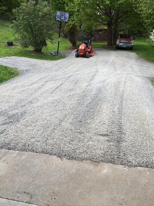

Joe - Not a snowblower, but I've used my BX2360 with a 4 foot box blade (300 pounds) a few times without the FEL.
Worked fine, but I wasn't doing anything heavy duty. Front end wasn't too light.
Guessing you'd be fine. Good luck.

In reply to my own post earlier - I was usually just moving/smoothing stone, but no problems at all.
Actually, not a hell of a lot different than what you'd be doing, but in reverse. You'd have extra weight on the rears for traction; a lighter front end won't bother much.
Like Wolfman said - absent FEL, much shorter and more maneuverable.
I'd give it a go!
