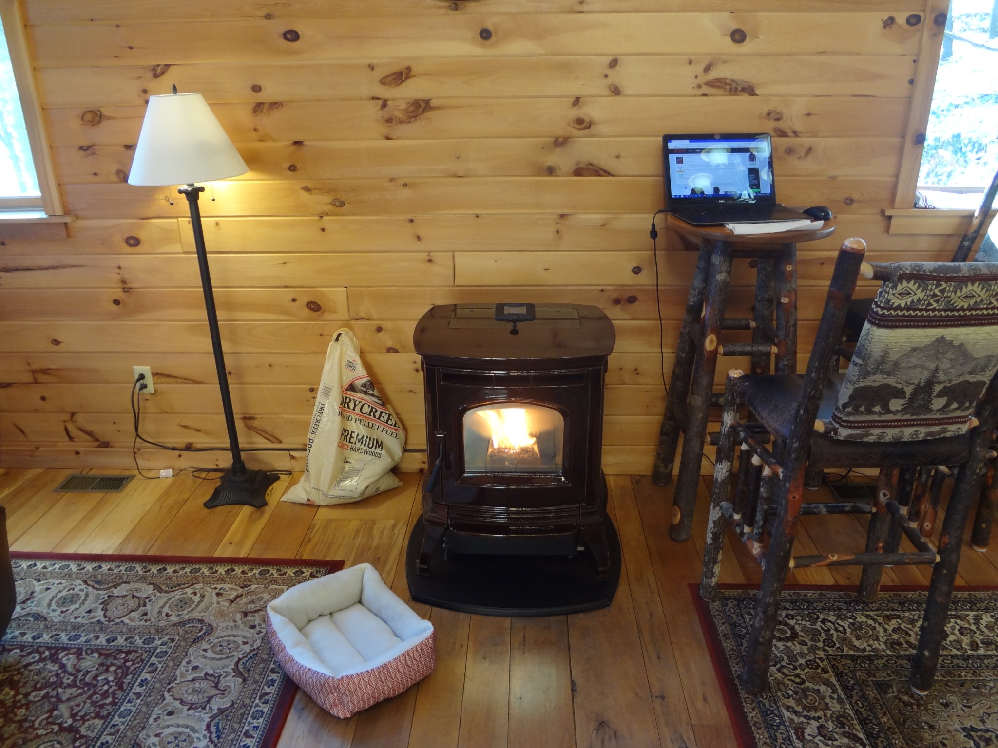

This is my 4th Harman and love it as much as all the others.

bear - like Tom, there’s a few other guys here with Harman stoves. I’ve had mine 15 years and have run almost 80 tons through it.
Can’t help with your investigation, but my first questions were hopper storage and BTU capacity of the unit.
I’m a little pessimistic about it’s operating capacity given its so small. Concern it’s components aren’t very stout, and it’s run-time may be short given it’s configuration.
I found the Harman site, but did not easily find an answer to the question I had.
I take it this is a pellet stove and has a flue that probably comes out the back and through the wall? And might pull in combustion air the same way?
I was hoping to find the answer by looking at some installation instructions, or a manual or something, on the site, but gave up as this information was not immediately apparent...
Also, second question. If one has natural gas available for heating, does the pellet stove end up being cheaper as far as cost for energy input into the home goes? Granted the ambiance is much better!
HERE'S THE install Manual for the one I have. As far as venting and intake you need to look at who makes the Thimble , I used Dura-Vent and the intake air is built-in to it. Absolute43C_3-90-00772i_Install.pdf (hearthnhome.com)
We go back to the main heater if the O/A Temp goes below 25F or so, the up stairs bed room and Bath get cold and worry about freezing the water lines in the walls as well as getting some heat into the basement.
I burn about 40 Lbs a day so it's like $5 Bucks a day.

Henro - - I think Tom's Install Guide should be self-explanatory.
I have a Top Vent Adaptor on my XXV that runs into a normal 6" tile thimble as you would use for a woodstove. Several new Harman models use the same style top vent adapter.
I do not use a fresh air intake. Our house is drafty enough that I didn't think it needed.
A newer or more insulated house should use one.
As far as comparative prices, there are MANY calculators on-line that can help you.
Fuel Comparison Calculator for Home Heating | Coalpail.com
My break-point is around $1.80/gallon of home heating oil, and a pellet cost of about $250/ton.
Like Tom, I use on average about 1.25 bags per day over a season. 5 tons total for a year, +/-... I burn less than 30 gallons of heating oil....pellets are main source.

Thanks for that!
Tom’s installation guide answered my question, and the link you provided RCW was very enlightening regarding comparative costs of using differ energy sources.
Thanks to you both for posting these details.
