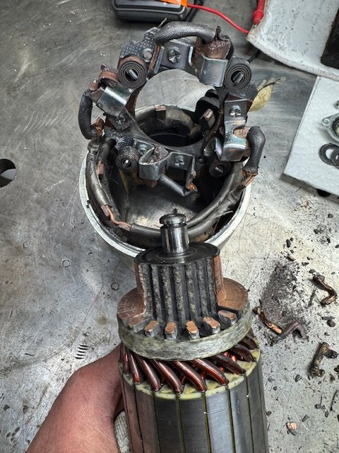

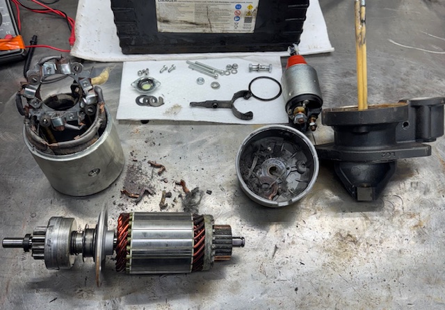

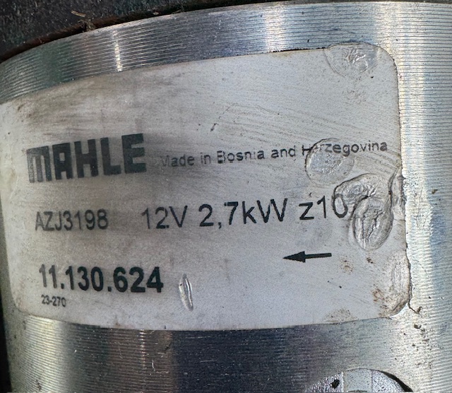

as far as my electrical issue... pretty sure the starter solenoid is bad. I jumped the relay and the solenoid clicks with a tap of a hammer.... then nothing. (thats with a good battery AND a booster on it)

I think you're getting warm. Looks like your starter did too.
I'm actually thinking it's the starter RELAY on the firewall...
This is the second starter the previous owner installed....
My thought is... keyswitch sends signal to RELAY ... Relay turns on and sends power to the solenoid trigger wire... (on the starter)
So if the relay sticks and continues to send power... The starter will continue to run AFTER the engine starts.... Probably can't hear it with the machine running....
that would explain the end of the Armature roasting against the brushes
hedgerow
Jan 2, 2015
392
376
Malcolm NE
I would go over the wiring primary and secondary with a fine tooth comb. I have seen bad relays, battery cables and half bad batteries burn up good starters. If he bought that starter aftermarket that can be a issue also. There are a lot of junk starters out there. Had a friend that didn't want to buy a complete set of batteries for his semi and kept screwing around charging batteries and jumping the truck and ended up burning the starter up and still had to buy four batteries and a starter also.

New starter installed... new fuel filter/fuel tank flushed and refilled.

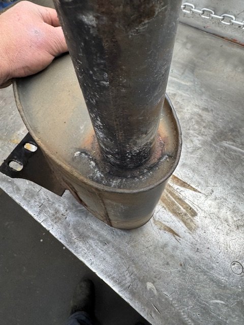

Got things cleaned up and lubed... fixed the seat pan/support ... Installed a new seat
found a hairline crack in the tailpipe coming off the muffler.... stitched the crack and made a support cover ....... it ain't going anywhere now.... :LOL:

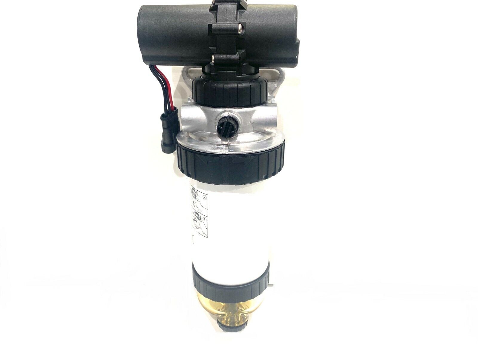

This New Holland 3 cyl. diesel uses a lift pump and filter like this picture....
I'm wondering...
Can I replace it with an Inline pump (Like the BX uses) put an inline filter before and after the pump....
Not sure what the specs are on the stock pump.... But after it goes into the injector pump there is a return line that feeds back into the fuel tank.....
I'm assuming the IP takes what it needs and returns the rest to the tank?
Original pump is working fine but an inline pump would clean up the area and take up less space....
thoughts?

Im sure you could replace it, but why?
If you continue to own the machine until its junked it may not be an issue.
However if you sell it, and there are problems associated with the pump or filters, be aware that there are lots of people who couldnt figure out whats going on when the situation was different than their manual and parts book showed. If it was mine, Id leave well enough alone.

I am in the same camp. I ran a couple of New Holland skid loaders for a number of years and never had any issues with there pumps or filters. I would leave well enough alone.
