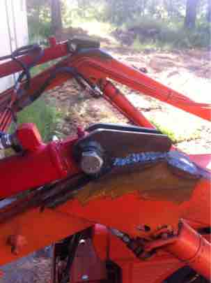

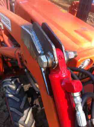

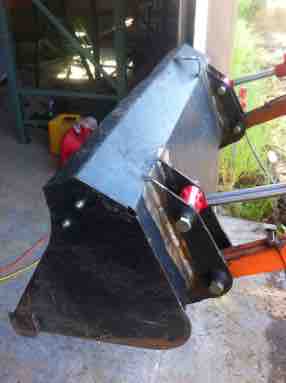

I gave up looking for a replacement cylinder, bought two with similar dimensions (same bore though) and repositioned the brackets. :)
Granted, I did it to accommodate a replacement bucket.
