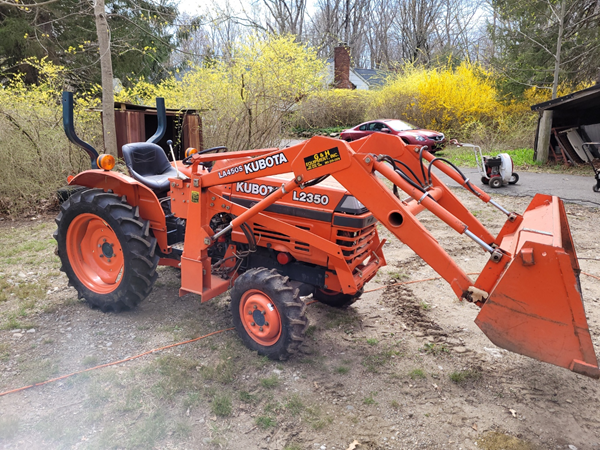

I don't know the overall length, but the tractordata on the LA450s loader says "reach at ground" is 63" so maybe that's added to the 104"? Here's a picture of one I'm about to buy that might help you scale the loader to the tractor. It looks like it will surely overhang your trailer, but maybe by only a couple feet.
I'm curious, how much did/will you pay for yours? We're trying to figure out a fair price.

If that loader were tucked back all the way and the bucket level it would take up less space. I think its going to be a very close fit (it fits at all). I am looking at the exact same tractor as pictured. L2350 4wd with FEL.
I will have more pics of the one I am considering when the present owner sends some this evening, but I would say it is basically in the same shape (aesthetically) as you have posted. Of course 'condition' and past maintenance (as well as market location) all make a difference....with respect to what a 'fair' price is.
