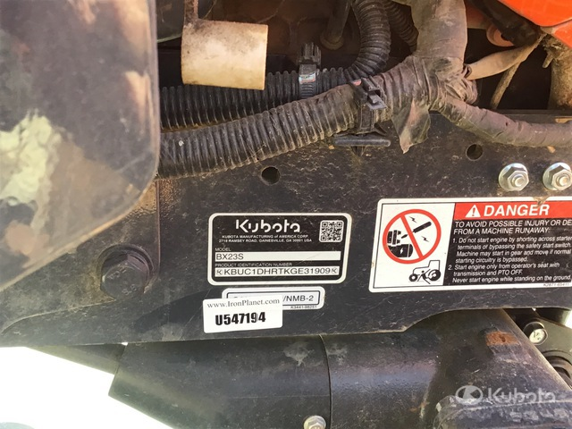

I'd like to know the meaning of each character placement and the meaning each character in the placement.
Better yet, a tool like the automotive vin decipher tools online.
Here is an example : View attachment 61614

Hello GSW911. I believe that the picture you supplied is a picture of a Canadian tractor. The abbreviation at the bottom of the label is " Canadian Interference Causing Equipment Standard" followed by the particular standard designation. I am sure that all those letters have a meaning. Perhaps one of our Canadian friends can help you with this.

Good morning 19TH,
The photo I supplied was for illustration purposes.
Seeing as the new Vin/serial number has only been around
on kubota tractors for just over a year, most owners haven't
seen the new Identification labels. Just wanted folks to know
what I was referring to. But thanks for the input.
