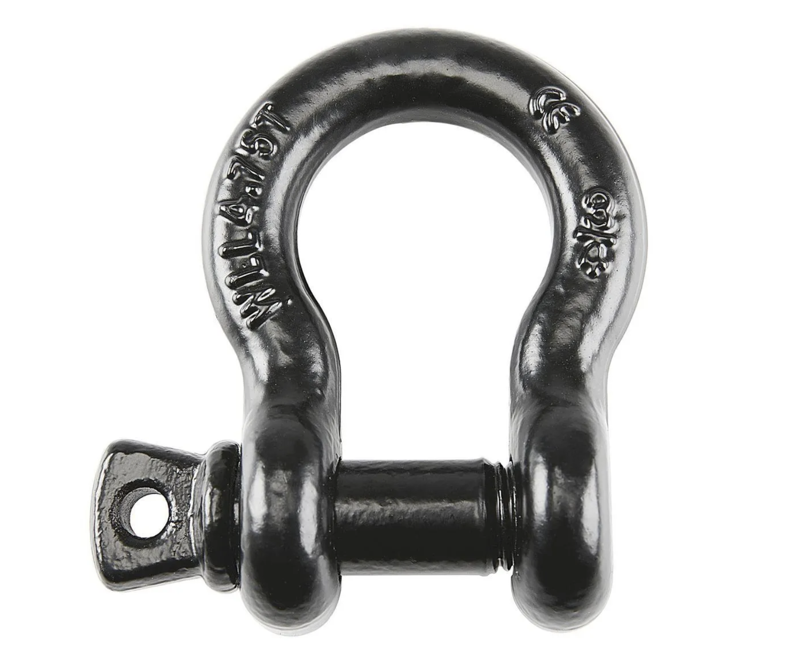

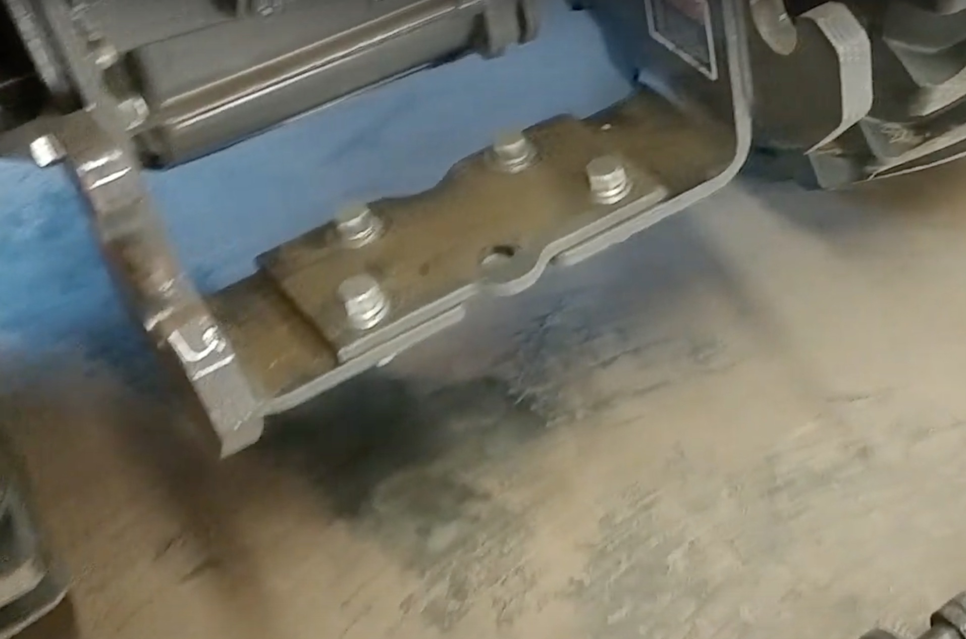

Any issue with adding a D-ring shackle to the rear of the tractor where some would put a ball or a hitch receiver? I've seen people mount a shackle/clevis back there with a 90-degree bend. Any concern if you mounted the D-ring without a bend in it?
Back of tractor:

D-ring shackles:
Back of tractor:
D-ring shackles:
Nope. I do that to attach a choker cable for skidding logs and brush.

I have a draw bar under the tractor and the shackle attached to the draw bar. Much better support by the way it's attached to the tractor.

long as your keeping it within your drawbar weight raiting do not see how it matters
