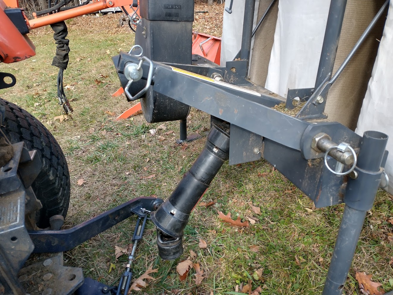

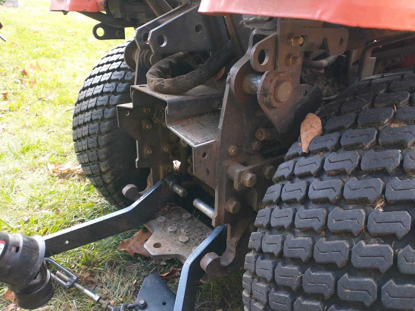

I may be very late with my reply, but here goes. About 5 years ago, I purchased a GCK60 bagger setup from my local Kubota dealer. I have been using it for at least 5 seasons now. I really like it and use it for all mowing.
A couple of minor complaints. If the grass is even slightly damp, the deck boot plugs up. I did have one shear bolt location that shearing the shear bolts. I eventually replaced it with a cheap low grade grade bolt to keep from having to buy the more expensive shear bolts from my local Kubota dealer. I have since learned that my wife and I were not engaging the PTO while at the slowest idle and that was typically when the bolt sheared (at mower engagement)..
Here are some photos of the hitch and mount system. I hope these photos are worth a thousand words for you?
