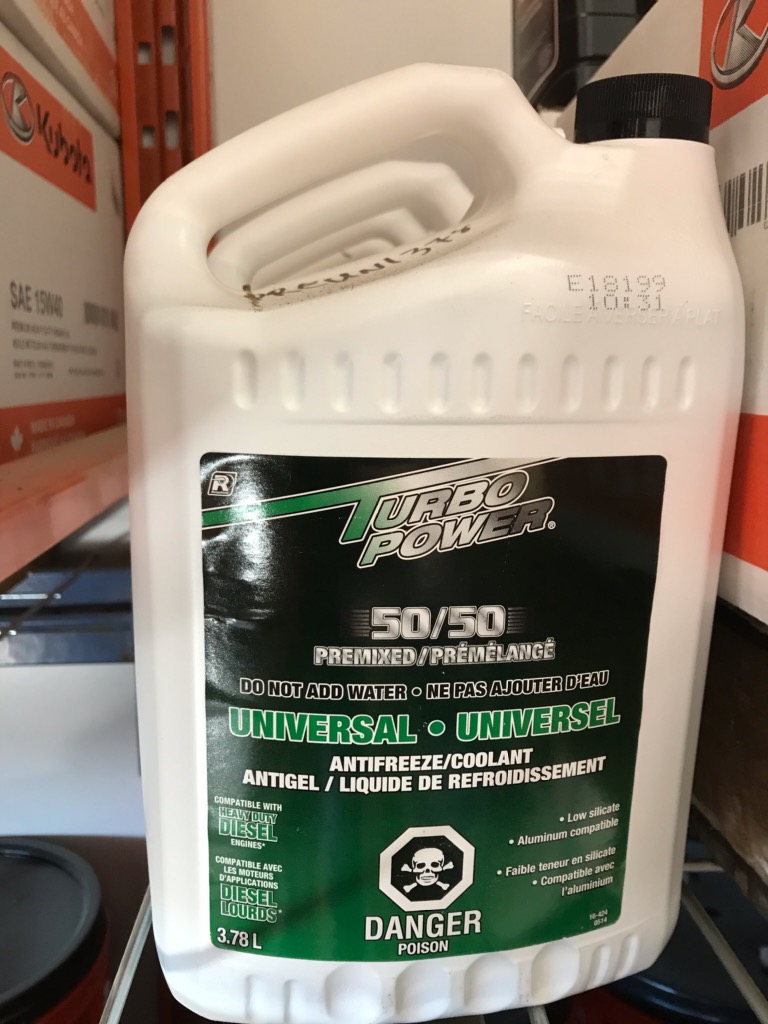

Well, we certainly have a lot of technical information. Thank you to those who provided it. We still, however are left with the question that started the conversation.
Can anyone name a specific coolant (Brand and type) to use in our Kubota's (including topping off factory filled cooling systems) other than the Kubota (private branded by CCI MFG) coolant?
This is what my Kubota dealer here in Canada sells and told me they use in all of their equipment.

This is what my Kubota dealer here in Canada sells and told me they use in all of their equipment. View attachment 53365 View attachment 53366
The Turbo Power jug in the picture is 50/50 premixed, label shows “DO NOT ADD WATER”. And doesn’t display LLC. So the manual says “Premix 50% LLC and 50% clean soft water“. Premixes shouldn’t require water, just flush system 2 to 3 times with water a pour straight from the premix jug. No?
The pic from the manual was sent to me by the parts girl when she sent me the pic of the antifreeze that they use. I'm not sure of the context, but it appears that's the procedure Kubota recommends if you were switching to an LLC, maybe?
Either way, the owner of the dealership told me they use that brand in all the diesel powered equipment they sell / service.
Their mechanic came to my place to do a recall on the coolant reservoir on my ZD1211 mower and that's the stuff he topped it up with, for what that's worth.

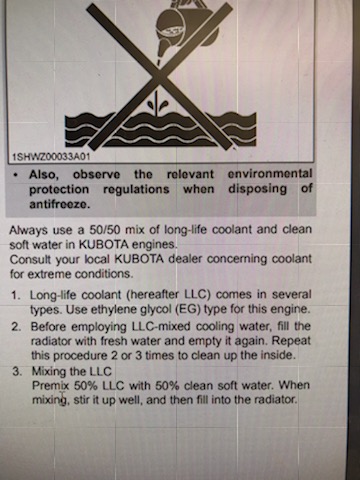

First picture is antifreeze mug of 50/50 premixed long life coolant.
Second picture is Kubota manual requireing to put 50/50 mix into tractor and giving instructions on what to dilute concentrate with.
Kubota manual may have been in existence before premixed anti freeze.
On my Nissan Frontier 2016 vintage the owners manual states that they use their branded Blue extended life and it has a 7 year life. But they have green long life that is good for 3 years (may have been 4). It can be used with the blue but if mixed then life is per green at 3 years.
That falls under the idiots guide to making thing way more complicated than they needed to. Never stated what type of anti freeze it was. Frustrating at best
