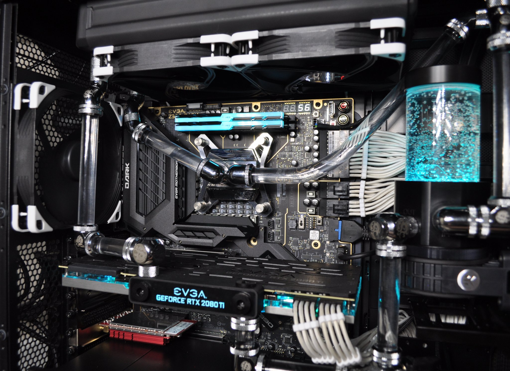

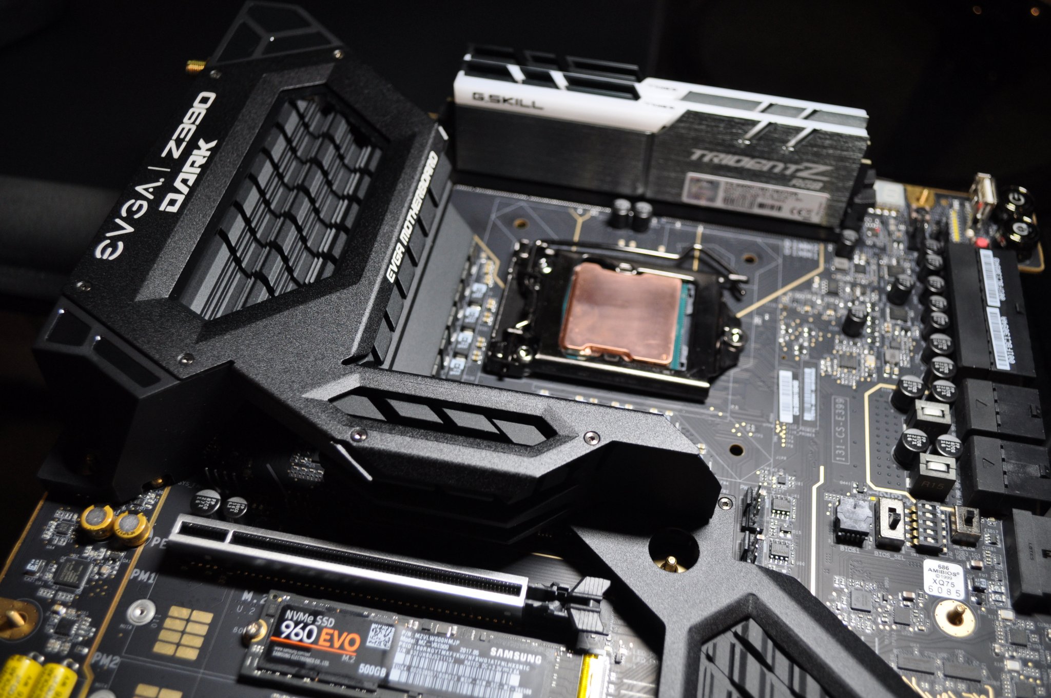

I built this a couple years ago and have been fighting the urge to upgrade...
i9-9900k @ 5.1GHz - Dellided with liquid metal and copper IHS.
EVGA z390 Dark
EVGA 2080 ti FTW3 Hydro Copper
32gb TridentZ 4000cl17
970 Pro 1tb
860 Evo 2tb
BeQuiet Dark Base Pro 900
EVGA P2 1200w
Cooled by: Heatkiller, Hardware Labs, EKWB, Bitspower, Noctua

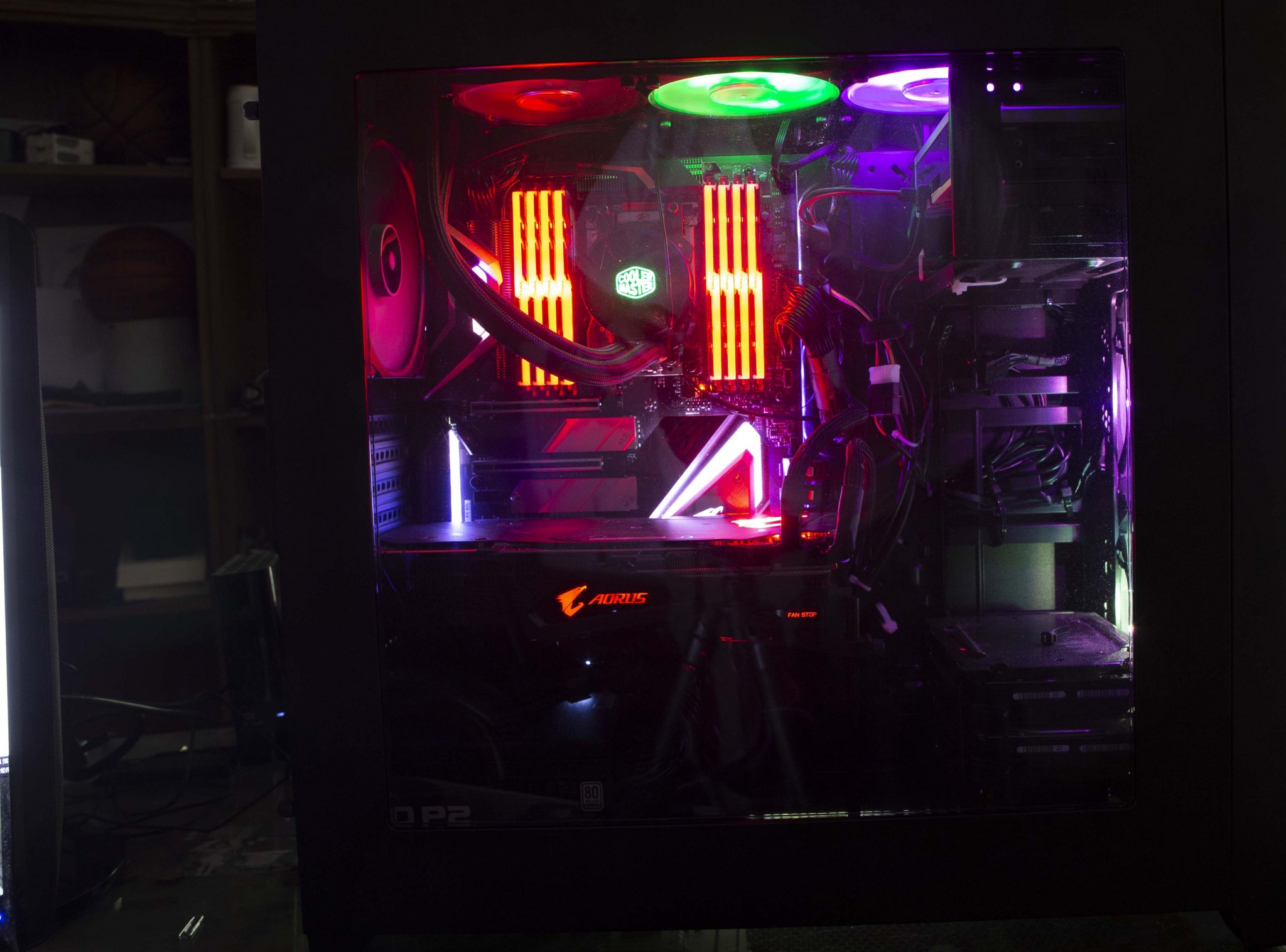

The machine I'm replacing (Monster)
I got carried away with the rgb at first. Now it's toned down quite a bit :)
2950X, 64gb, Gigabyte 2080 ti, 2tb NVMe, 2X 6tb spinners

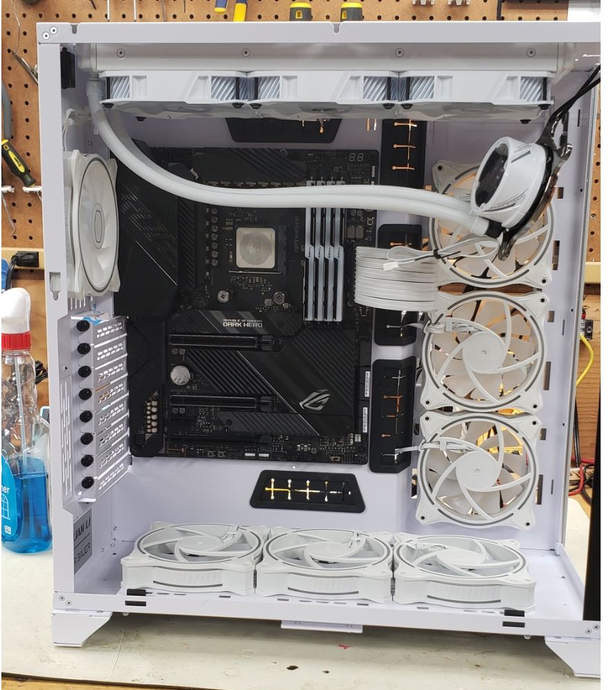

Here is my progress today on the new machine:
I'm kind of stuck here, missing of all things, thermal paste. Amazon will deliver tomorrow. I know I have an unopened tube, somewhere.

Nice build. very clean and really like the white theme. I'm still team blue at the moment. Next next build think I'll go red. AMD has really made a come back in recent years. I'm also waiting to get a new GPU and agree with you - not going to encourage scalpers by paying inflated prices. Would rather wait it out.

From your first set of pictures it appears there is already thermal paste on the CPU cooler. From my experience preapplied stuff is pretty good as long as you aren't looking to push the clock to the limit of the chip.
good eyes :)
Yes there is some that came on the cooler. A small amount got smudged in handling but I do plan on overclocking it so wanted a good quality thermal paste on there anyway. You can see the imprint on the cpu when I test fit it. I have some Grizzly Kryonaut on order. It came out highly rated on a paste comparison.
I am not planning on pushing the cpu to the ragged edge but would like the temps as low as practical.

Also good plan I have heard good things about Thermal Grizzly. Make sure that you clean everything off with isopropyl alcohol and a cloth that will not leave scraps behind. If you are willing to put in the work you can lap the CPU and cooler so they have as flat of surface as possible. Conduction loves surface area. Although it might void your warranties depending on how much is needed done to make the faces flat.
