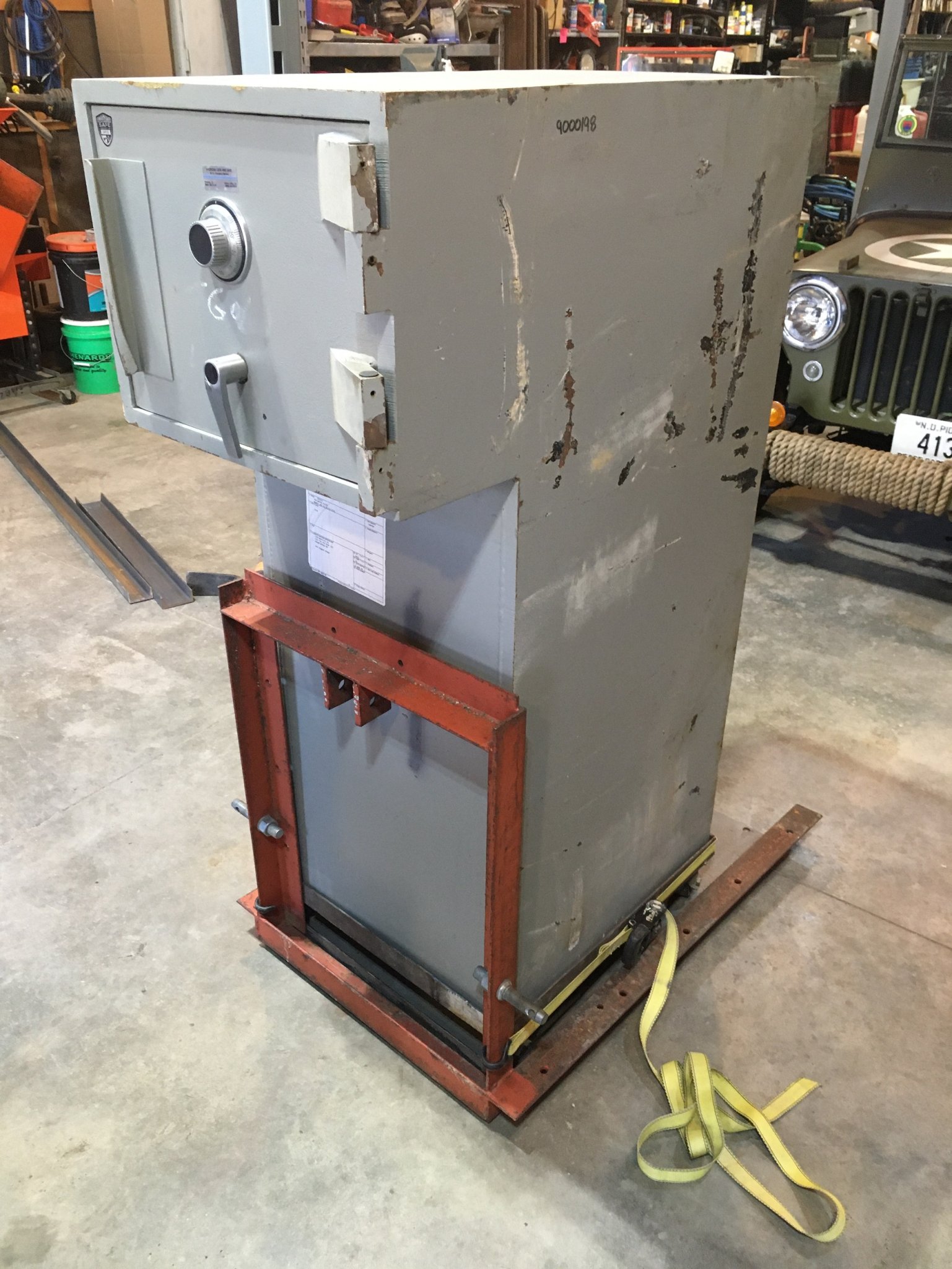

My Locksmith buddy has had this heavy double safe in storage for years. It was time to get it out of storage and try to get it open. He bought it at a government surplus sale years ago with no known combination. The story had it being moved between two different AirForce bases by a disgruntled serviceman truck driver who threw the combo away. LOL! No one knows what’s in it or why the real combo wasn’t recorded and retrievable.
The structure is 1” solid steel throughout and weighs 2052 lbs according to the freight sticker on it. It was recently delivered to my place and unloaded by a large skidster with forks and placed inside my storage building, which had room at the time.
With winter here, it would be nice to have this in the heated shop so we can work on cracking the combination of the two locks. If left in the cold storage shed, I’m afraid the locks would be too stiff to decipher anything. But how to move the beast without hiring a wrecker!??! And it’s only about 100 ft. away from my heated shop.
I noticed my carry-all framework fit nicely around the mobile base we made for the safe to roll on. Maybe something could be added to the carry-all to roll the safe onto? In the metal parts storage, there sat a nice thick former steel door panel. It was a perfect fit between the carry-all arms. With one end lip cut off (to allow the safe to roll up onto it) it was welded to the framework while protruding just below the bottom of the arms.
With the safe rolled up onto and secured to the front of the carry-all, it will (I hope) just be pulled along like a stone boat…..not lifted off the ground by my B2650. While loaded….if it will slide on the concrete floor then it should easily slide on a snow packed gravel drive with some careful pulling. We shall see.

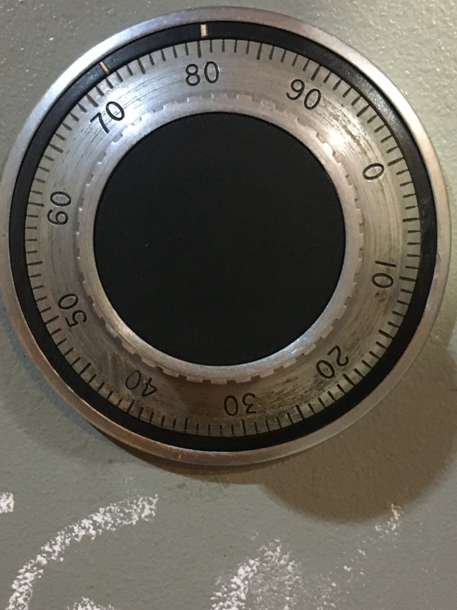

Here's a pic of the lock's dial:
IMG_0687.JPG No hint of manufacture. I agree, though, most likely Sargent Greenleaf lock
But there's no hint of how the lock body is mounted....vertical up? vertical down? horizontal right/left??
No hint of anything inside pertaining to the actual locking mechanism locations. Is there hardened plates between the lock body and door? and then how far back inside is the actual lock body itself.
Too many unknowns yet, to consider drilling first. :) I think our best bet is to try cracking the combo first as I believe the locks are both just a class 2 lock. Plus, it'll be a lot less work and sweat than drilling through all that steel maybe multiple times. Well, hopefully!! And more bragging rights when successful.

FWIW, the dial looks like a La Gard. I never liked working on them.

I think you're right about the LaGard look. the dial/ring look identical. We're not sure how old this safe actually is. From the AirForce paperwork stuck on the side it looks like it might have been readied for shipment back in '96, some 25+ yrs ago. Been in storage a long time apparently!
The LaGards seem to be a cheap version of the S&G. This one is well worn. At least the front dial must have undergone a lot of spinning.....the bushing is very sloppy! I'm sure the new owner is going to want a nice S&G lock or two for replacements.

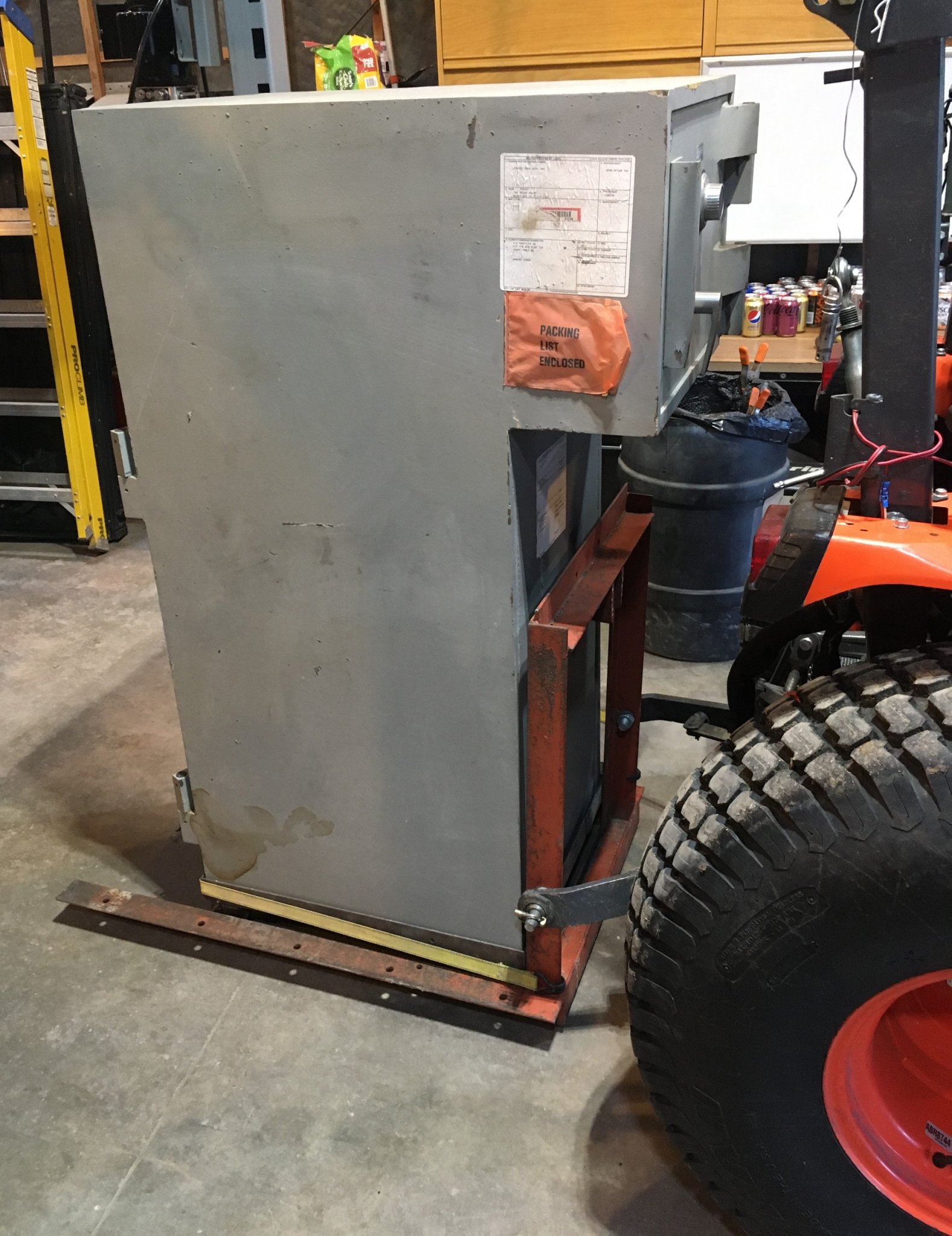

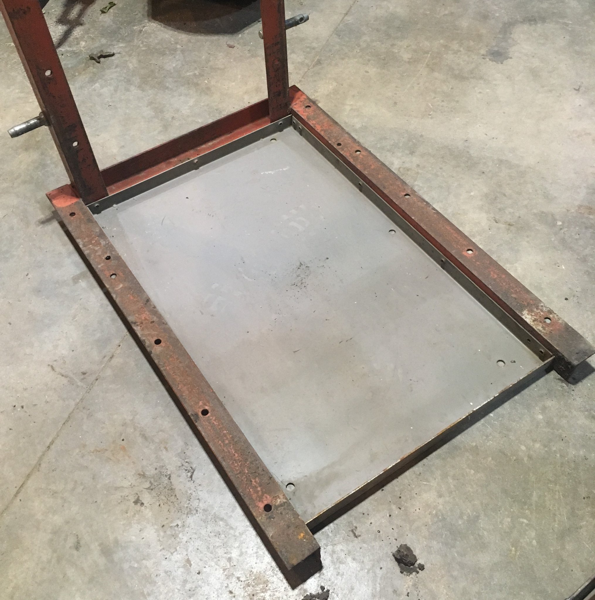

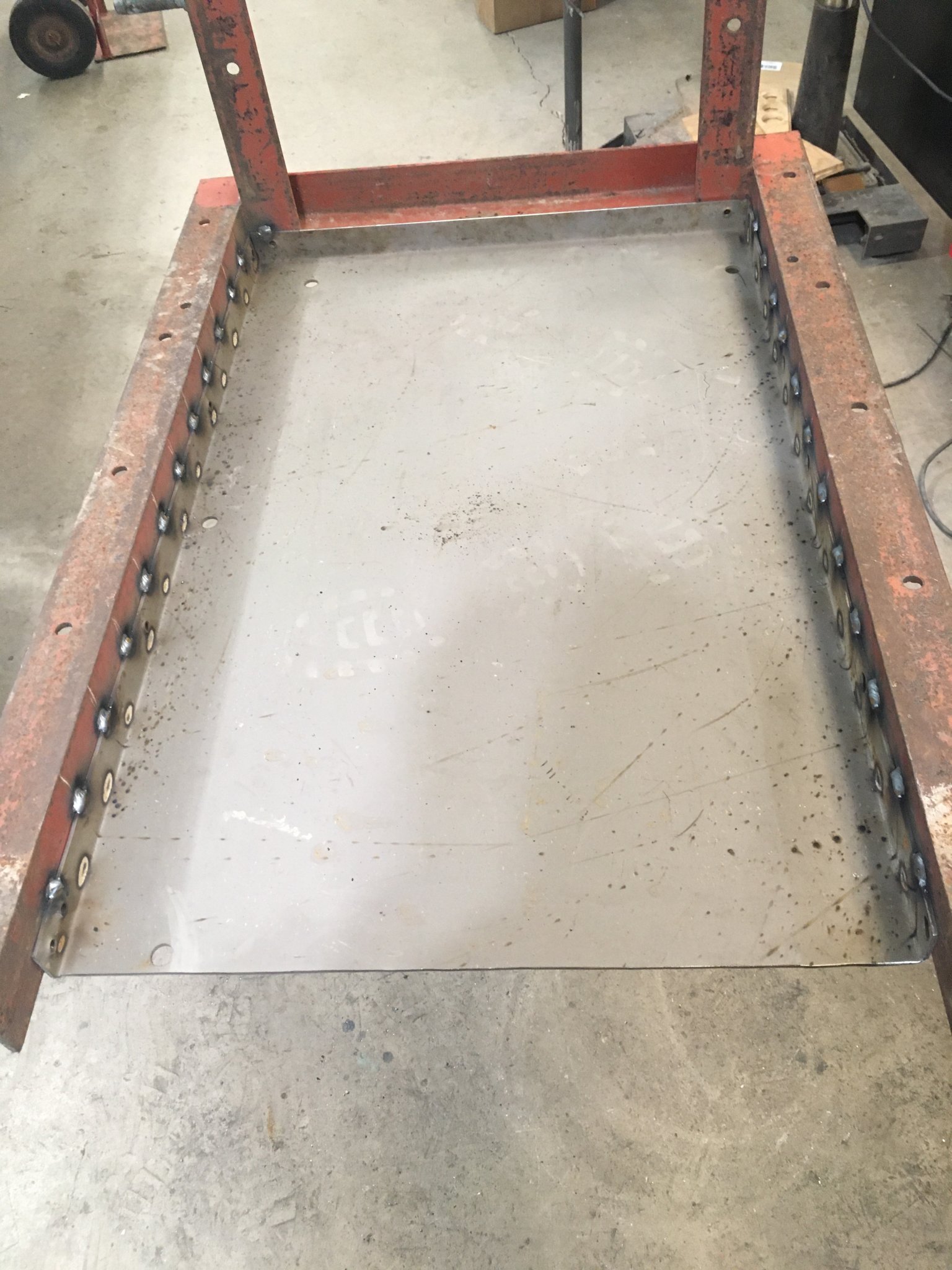

Today, I thought I'd see how hard it would be to get the safe rolled up onto the 1/8" steel plate welded to the bottom of the carry-all framework. It wouldn't go up on by just pushing (had to try :ROFLMAO:) so a ratchet strap around the frame and cart was used to pull a little tension between the two. A little boost from a prybar on the back side and the safe popped right up onto the bottom plate. The same method to get the cart's back wheels on was used next. Then the whole shebang ratchet-strapped to the framework.
That went so slick, I had to hook up the B2650 to the carry-all to test my thoughts on some bracing in case the safe started to lean during the short trip to the other shop. Here's what it looks like with the lower link arms hooked up.

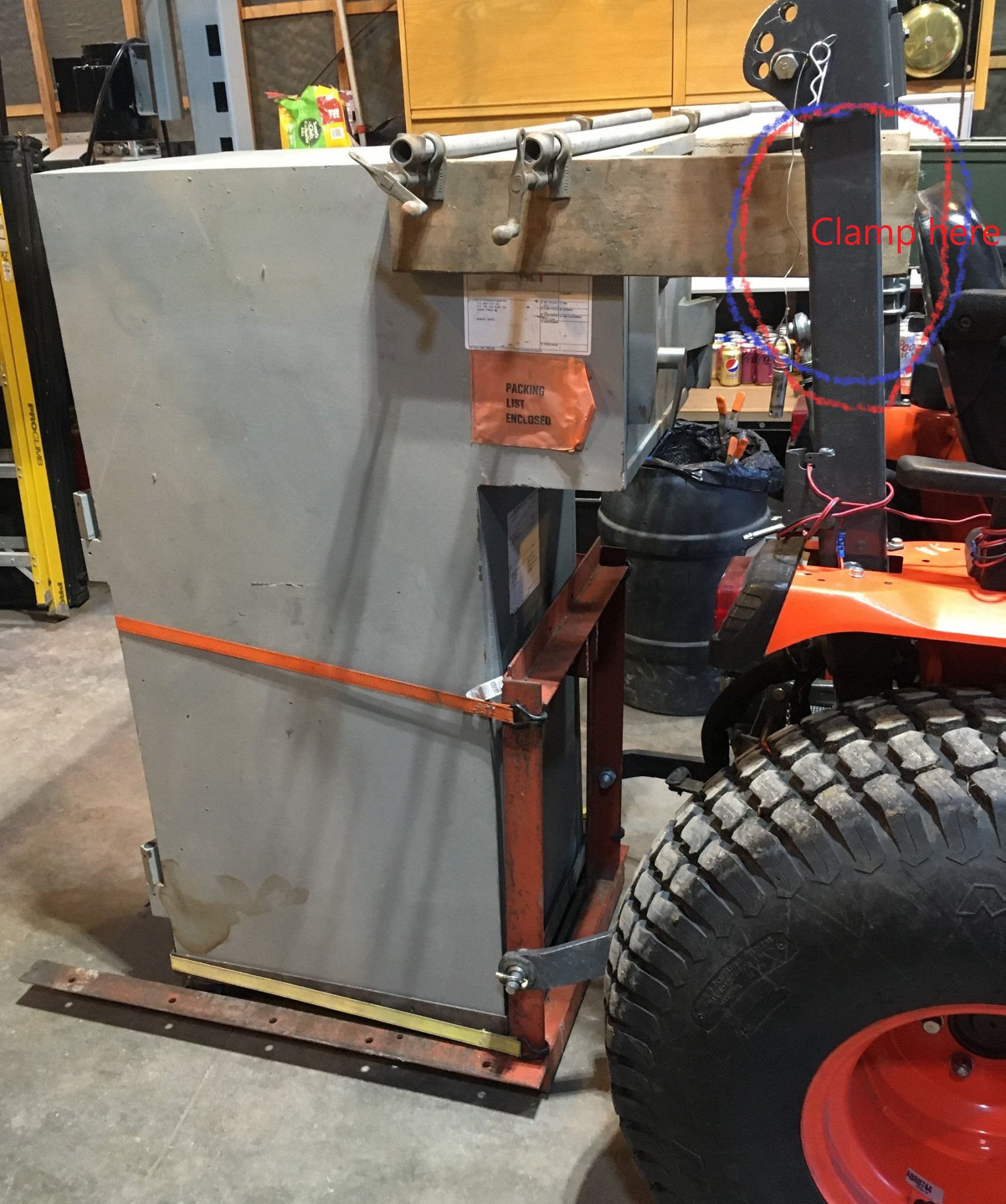

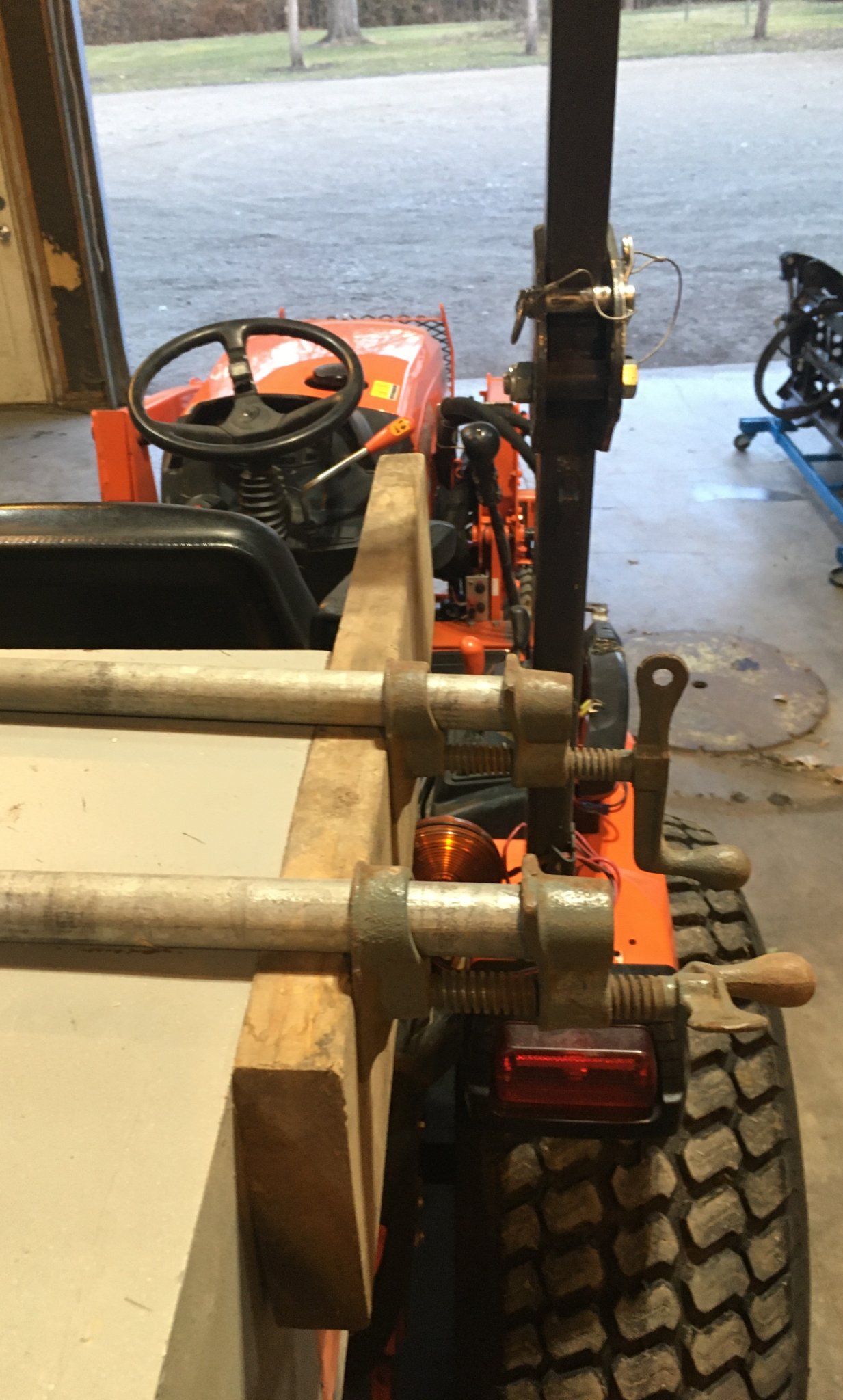

For some safety bracing, a couple of 2x6 boards clamped to the top and protruding forward between the Rops uprights should work slick. I could close the gap with a small wood block screwed to the ends on each side if necessary.
Bear in mind this is just a test setup. More strapping and clamps will be used for the actual move. But this looked so slick that I had to give it a very short test pull of a couple feet. Surprise, surprise,.....it hardly new the safe was back there. The terrain to be traversed is perfectly flat so no worries of the wood bracing causing any issues as if it were to cross a ditch or other slope.
It looks like it'll be an easy 5 minute move in low gear as soon as I can get a buddy over for an extra set of eyes and a burger/beer lunch afterwards.

Looks great man.
My only possible suggestion is to have some sort of "Fore and Aft" tipping protection. Maybe as simple as doing that "rops shim job" you were talking about, and clamping it to the rops bar itself?

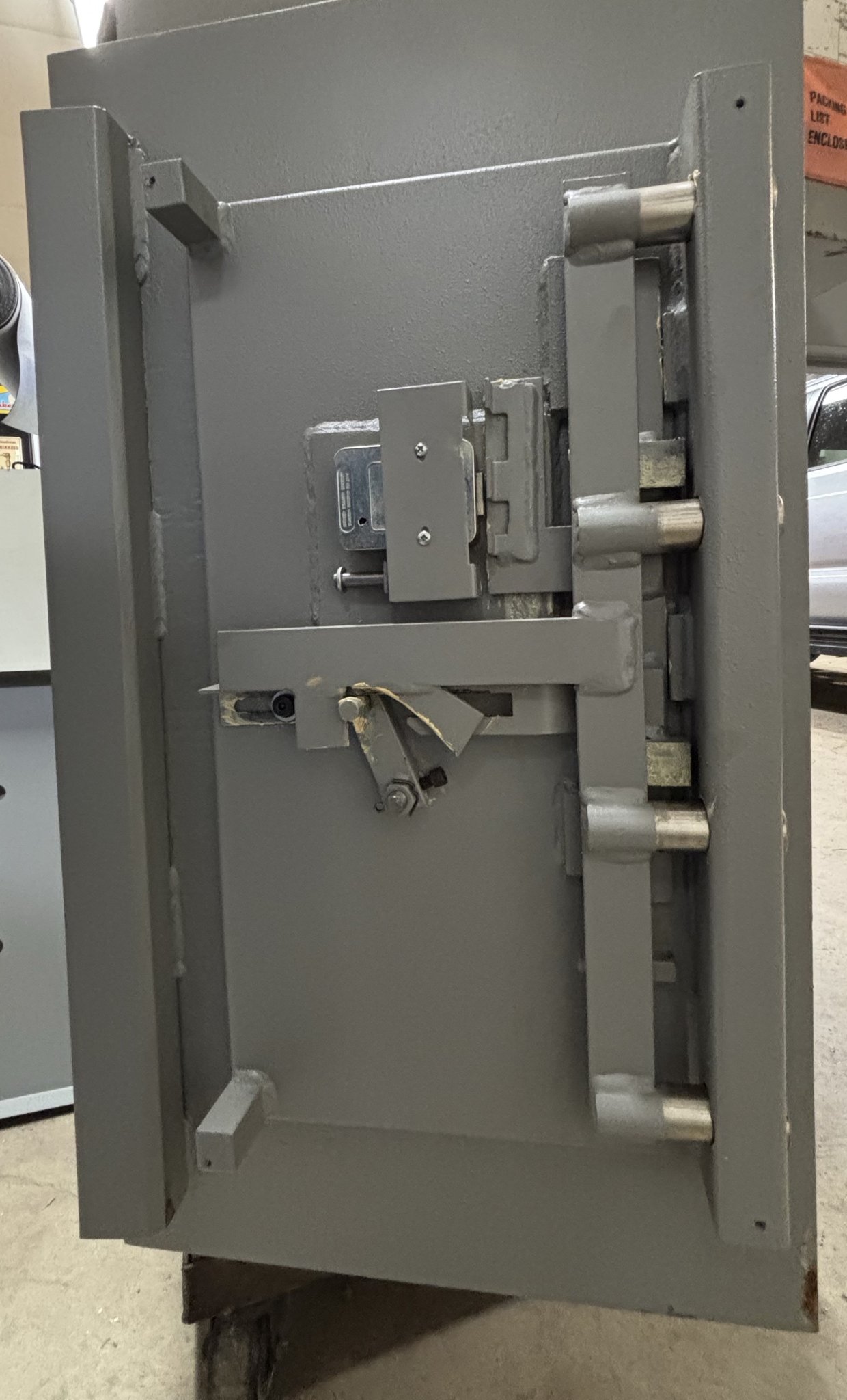

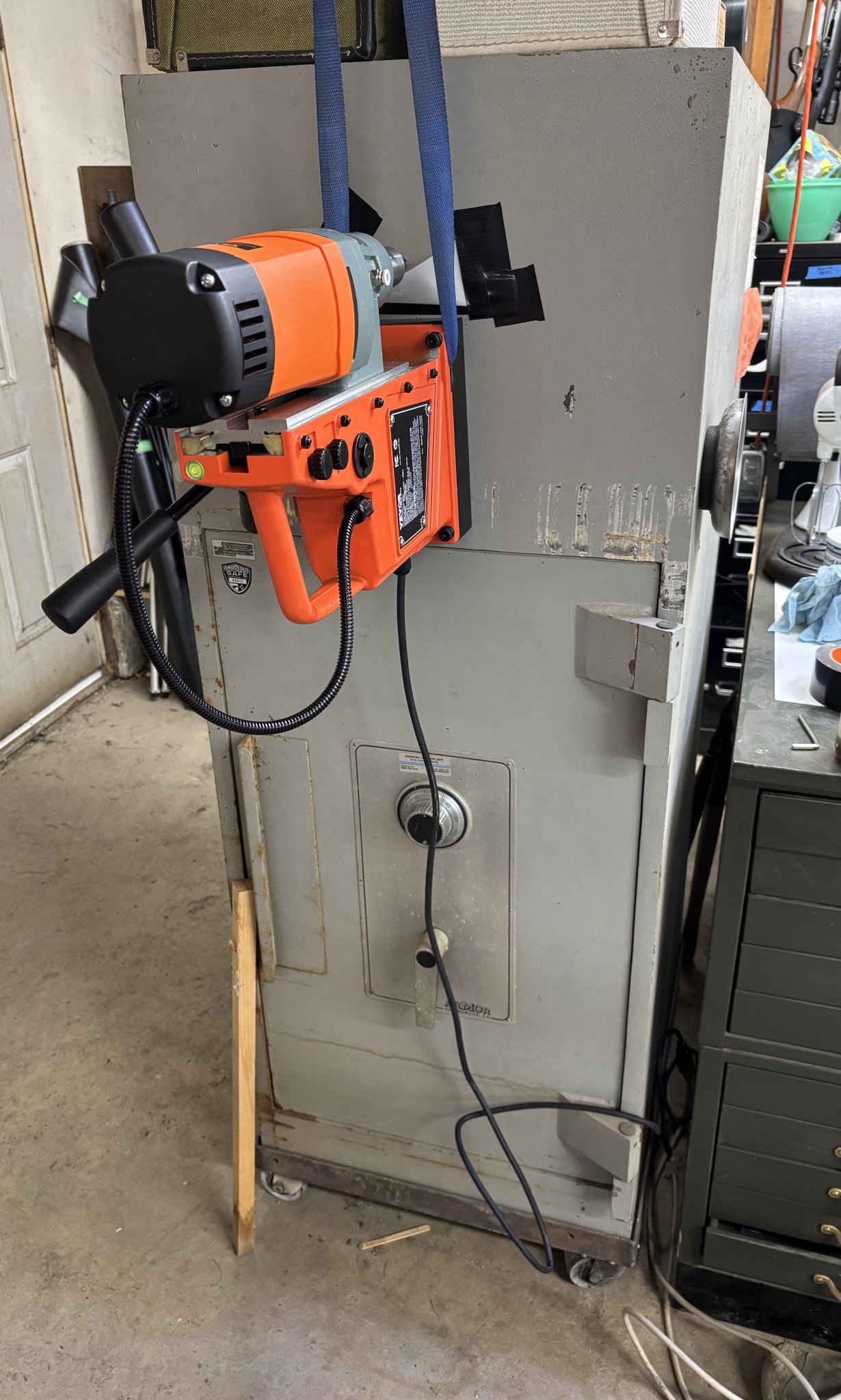

Finally, an update on the heavy safe move and cracking the combinations!
It's hard to believe it’s been over 2 yrs since I moved this safe into the heated shop to work on. It’s sat unmolested mostly because the locksmith buddy and myself just couldn’t seem to find a common spare day to try crack the combos. Also, to our disadvantage, the locks are pretty worn and sticky which really made it tough to graph the numbers and the combination.
However, fast forward to recent days with the purchase of a mag drill for another project. Looking for a test subject to test it out on, we thought why not drill an inspection hole in one of the safe cavities to have a look inside with a borescope. When we were lucky to see a “Change Key” hole in the lock body, I knew we had a chance for success in opening these two vaults.

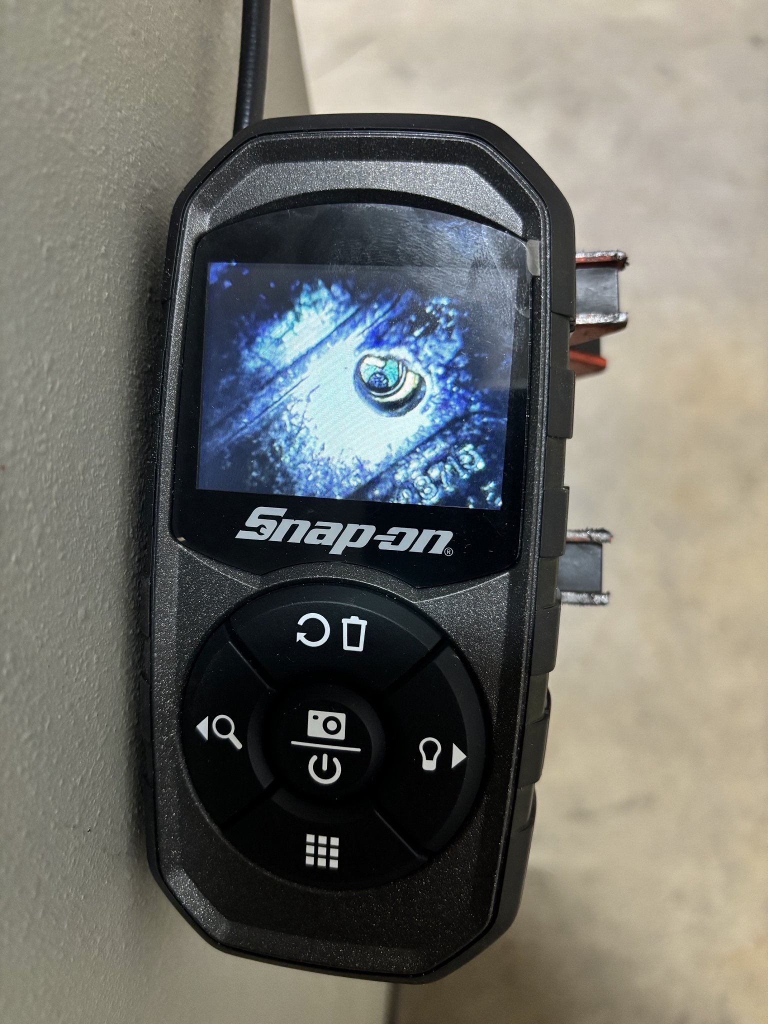

With the borescope taped to a steel rod, lined up closely to the change key hole, held in place with some welding magnets so we could view and dial numbers at the same time…..we were soon making headway.
It didn’t take but an hour or two to figure out how to compensate for the scopes misalignment looking at the change key hole (parallax). Dialing and noting the numbers on the change key index mark to align the 3 wheels up for the change key as viewed in the scope….gave us the proper combination.
The first try on the upper vault didn’t work for some reason. We thought a re-locker had been tripped due to the safe’s apparent tipping over at some point in its life (most likely during the shipping between AFBs).
Drilling and setting up for the bottom safe gave the same results at first. There seemed to be another mechanical stop to the handle even though we were fairly certain we had the proper combination. After a bunch of slapping the handle against the “stop” to try to discern the location of the issue (in case we needed to drill another inspection hole)…..all of a sudden, the handle moved to the full open position. The old lubrication grease had become so dry and solid that it wouldn’t allow the mechanisms to retract. The jarring of the handle finally broke things loose.
Back to the top vault and the same procedure had it open as well

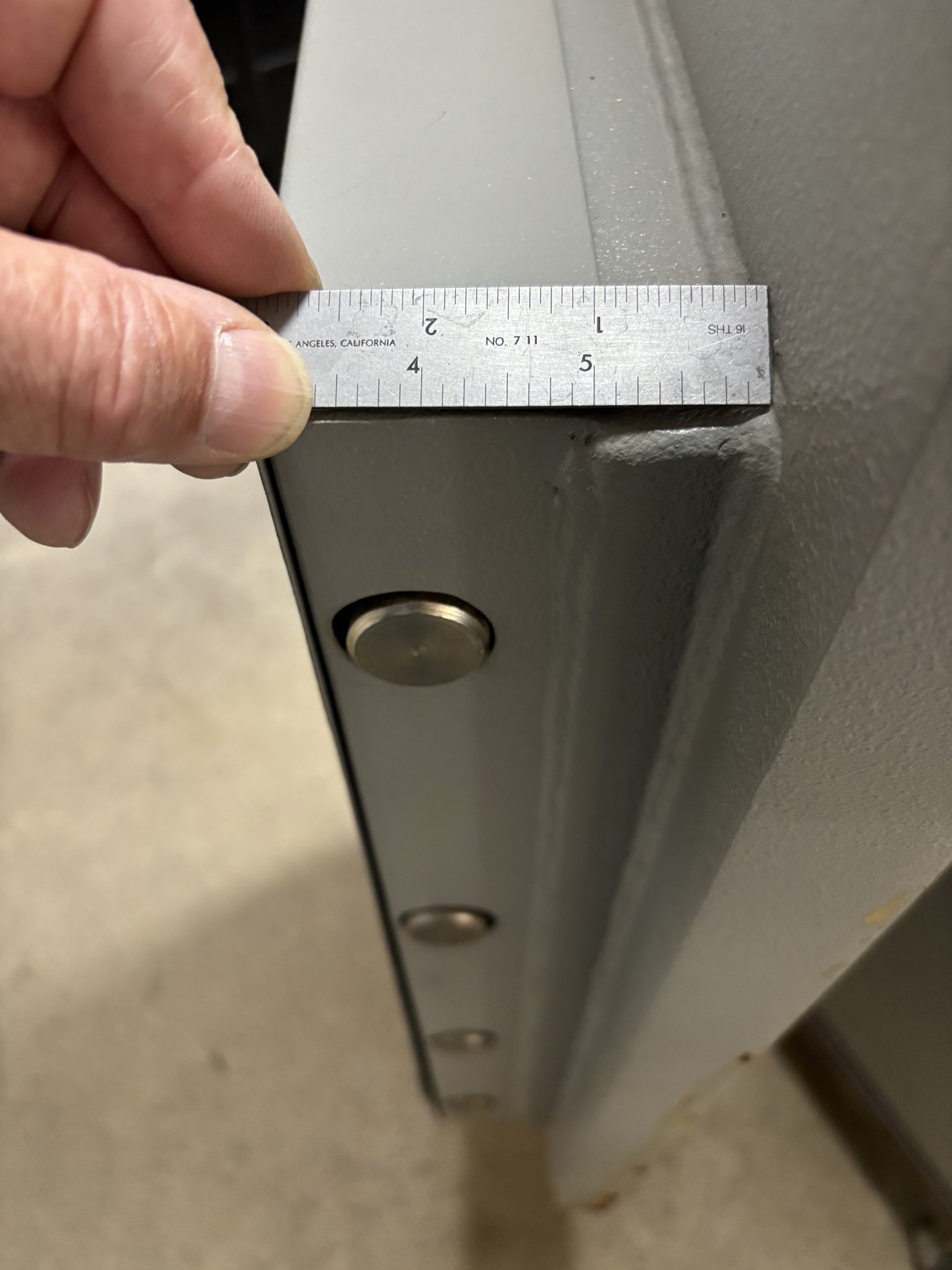

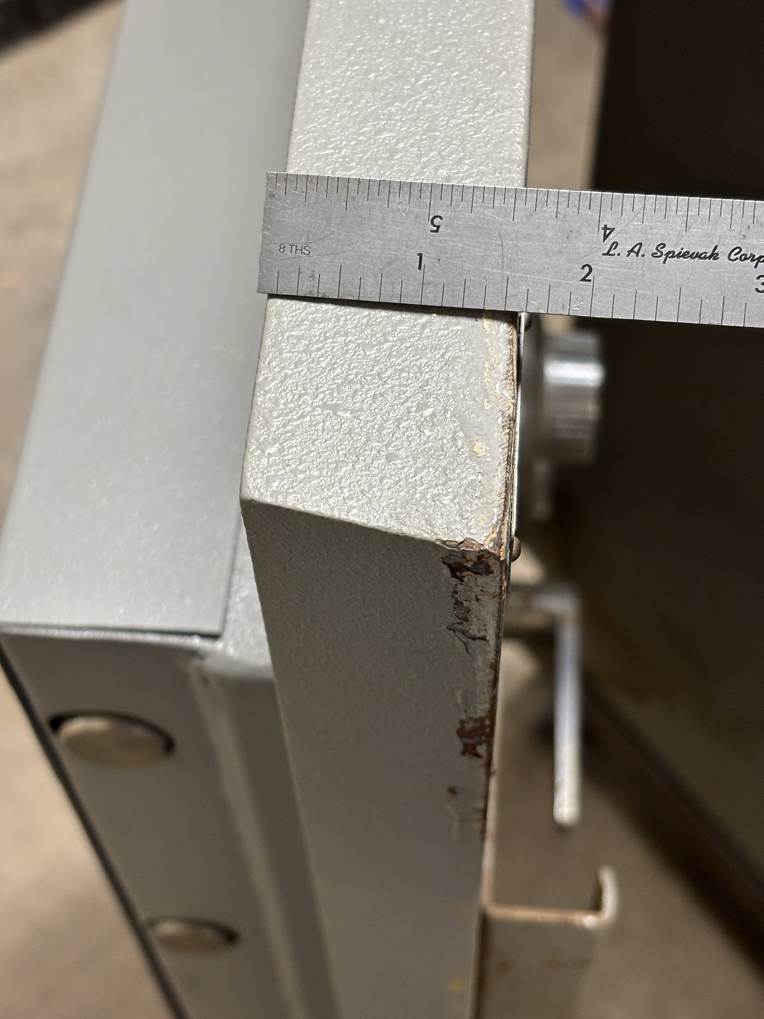

The doors are 1.5 inches thick steel with another 1 inch plate where the lock mechanism mounts for a total of 2.5 inches. Those doors are heavy!
