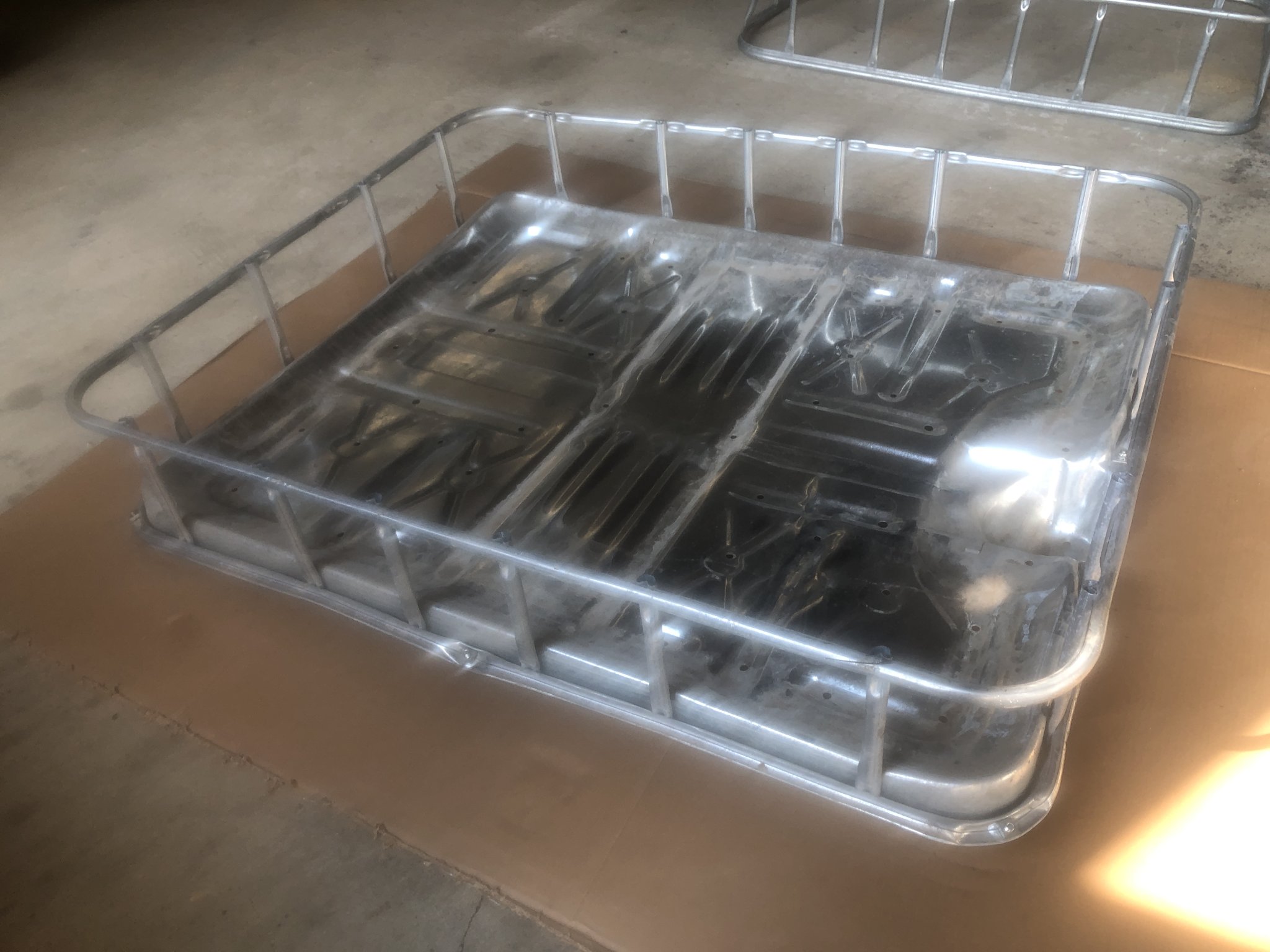

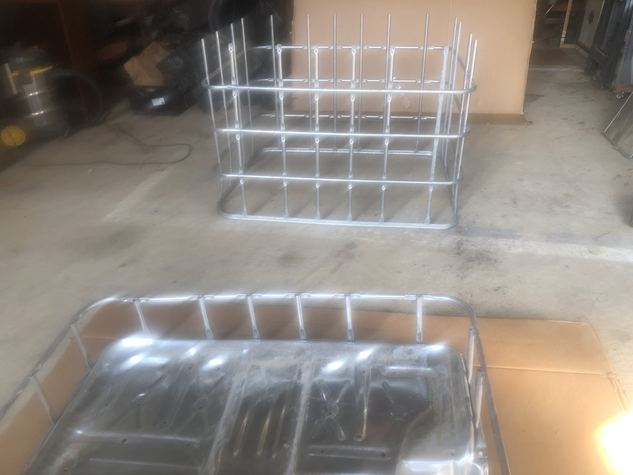

Got to looking at an IBC tote that I made a lift basket for the FEL and had a thought. Some scrap items, a $25 IBC tote with steel pallet, and few hours later here it is...more tinkering to come.

Flip it and go overlanding😁
Ha!
I did think about leaving the base to the IBC cage on it. Would be cargo rack on top, brush cage underneath!
In the end, I didn't want too much over the pan to catch limbs. If I decide to remove it for more mods, I'll flip the pan so the drain recess is facing downwards.
My wife, always skeptical of my ideas, actually kinda likes the Mad Max look it has going on. Maybe I need to add some chains and skulls...

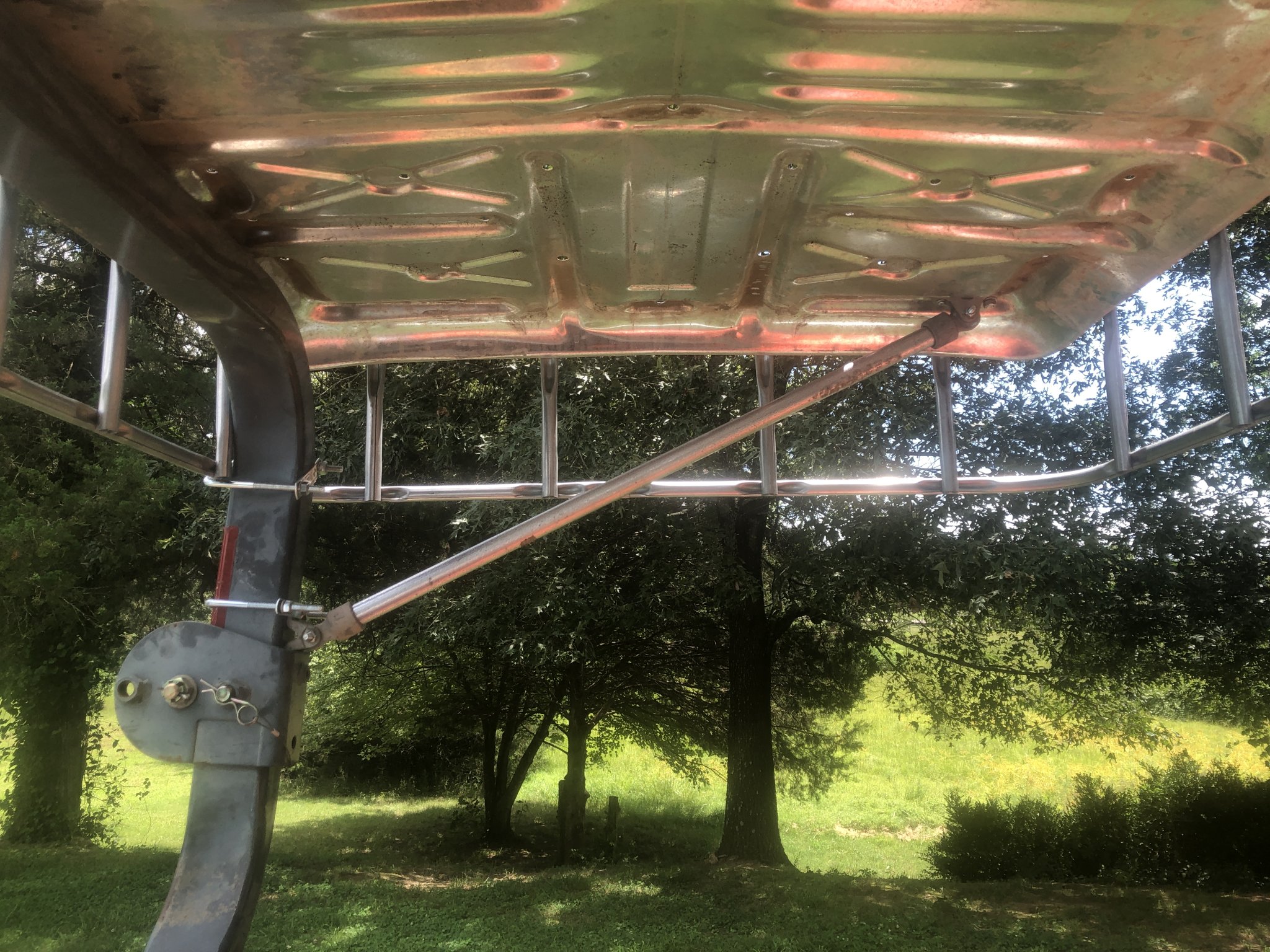

Wow, we are at $100 around here. Looks like it could fry some eggs out in the sun. I like it
Found a guy who worked on a big farm operation that had some on FB Marketplace. The top of the bladders were cut open to store feed but the cages were good. Good, complete IBCs are going between $60-80 around here.
It was hot on my initial outing with it and it wasn't bad. The shiny surface reflects a lot of heat I'm guessing. The cage is 40"x48" and for my ROPS I had to use the 48" to span the width. That means I only have 40" front to back to block the sun...later in the afternoon, it seemed like only my head and neck were shaded at times.

I like the idea but wonder if the smaller limbs I still push through would tear it. I suppose I could wrap them in a stout tape or something to offer some protection.
So far, no issues on bumping the head into the cage, but the jeep style mirror I hung underneath gets me some. Got a couple of lower profile wide angle mirrors coming that should give me good rear views while backing the brush cutter along my pond banks.

The ones I bought have cages intact, just the top of the bladder cut on three sides with the 4th being the "hinge".

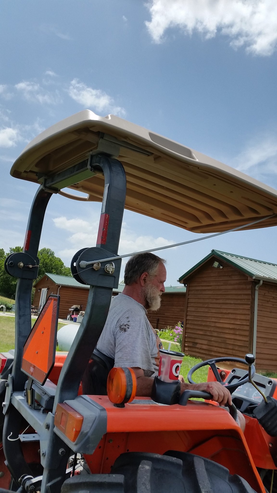

Here's how the cart tops look. I made this one for my neighbor's Kubota tractor his wife uses most of the time for raking hay. I used unistrut to mount to ROPS and did not need to drill a hole anywhere in the EZGo top.
I've been on the hunt for something to make a top, since last year. I have seen a couple, but they were too far away. Slim pickings on the West Coast!
