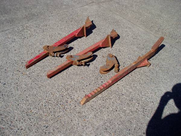

I don't know; I built a set of stabilizers for a customer, and she now wants to know if I can make a toothed bar to fit the bottom of her 5' blade. I've never seen one, so the idea intrigues me.
I've seen several methods for various needs.
1. I've heard of people putting a Ratchet Rake on a blade. Or a serrated edge instead of straight.
http://www.ratchetrake.com/
2. These are common in ads from China:
http://www.offermachines.com/rear-grader-blade-with-ripper-230/
http://farmer-helper.en.alibaba.com/product/522729602-213175298/grader_blade_with_ripper.html
3. Something like box blade scarifiers with a hooked clamp top and bottom of the straight shank, to clamp onto the rear blade where and how many as needed. See attached image.
4. A perforated square tube like box blades have, welded to the rear of a blade.
