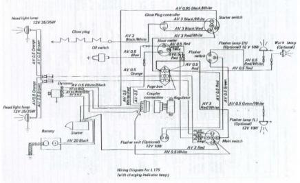

This is quoted from the previous referenced thread by lblevins “run power to starter power and lead off headlight wiring to top cross spade connector and done”
So I have no idea what lblevins or td100 mean since I see no charge light in the schematic posted by Dave to help me help you.
Here are the L175 wiring diagrams with and without the charge lamp. Hope this helps.
EDIT: Don't ask me why one shows three glow plugs :confused:
5,255
1,058
If you look closely at the WSM I think your wiring diagrams came from, that WSM covers several models of tractors and also covers both serial and parallel glow plugs.
Since the Denso alternator I recommend is a one wire design, a volt meter is a far easier item to install than getting a charge light to work as resistance values of bulbs and sometimes wiring become very important and likely wont match what is on the tractor now. To be extra clear with the one wire alternator, there will have to be a short jumper wire between the output post on the alternator and one of the two spade terminals on the alternator.
About 4" long. Rarely suppliers put this jumper on internally.
Tractors like the B7100. one with a long long reputation for reliability, did not have a charging light. With a brand new alternator on an older tractor, the engine is far more likely to fail than the new alternator.
Study this wiring diagram for a B7100 and note the rectifier has 4 leads. Two from the dynamo, one ground and one DC output to charge battery. No warning light circuit.
If you absolutely have to have a charge light, then go with MTD's charge indicator which is a self contained voltage sensor which turns on the lamp if the voltage goes below a set threshold. Absolutely as simple to install as a voltmeter. It has no interaction with the alternator nor its wiring. One wire to ground and the other to the battery +.

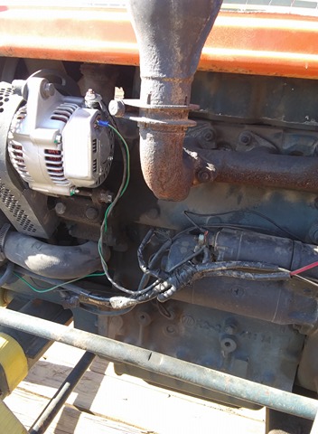

Got the new alternator installed the other day, very simple installation without having to make any mechanical changes.
Used the original battery + terminal and cut off the old 4 pin connector.
Thought about it for while and decided to connect the new LED voltmeter to the key switch.
Left everything else as was. This way if I forget to turn the key off the old idiot light will stay light and remind me to turn it off.
Worked great, 14.8v at startup and idle.

Might have been able to get the alternator cheaper, but this is the one I bought.
Free shipping, and it showed up earlier than expected.
https://www.ebay.com/itm/CHEVY-GM-M...e=STRK:MEBIDX:IT&_trksid=p2057872.m2749.l2649
For the LED voltmeter I went with this one.
https://www.amazon.com/gp/product/B06ZZJ48VQ/ref=oh_aui_detailpage_o00_s00?ie=UTF8&psc=1
After much thinking (and man does that ever make my head hurt I decided to stay with a single wire right from the alternator to the solenoid and I even used the old wire.
For the voltmeter I ran a wire from the key switch to the gauge and a ground wire from the meter to a small bolt I mounted on the dash keeping the wire under the dash.
That left me with a functioning volt meter and the old "idiot" light that doesn't respond to the alternator output, but does stay on until I turn the key off.
