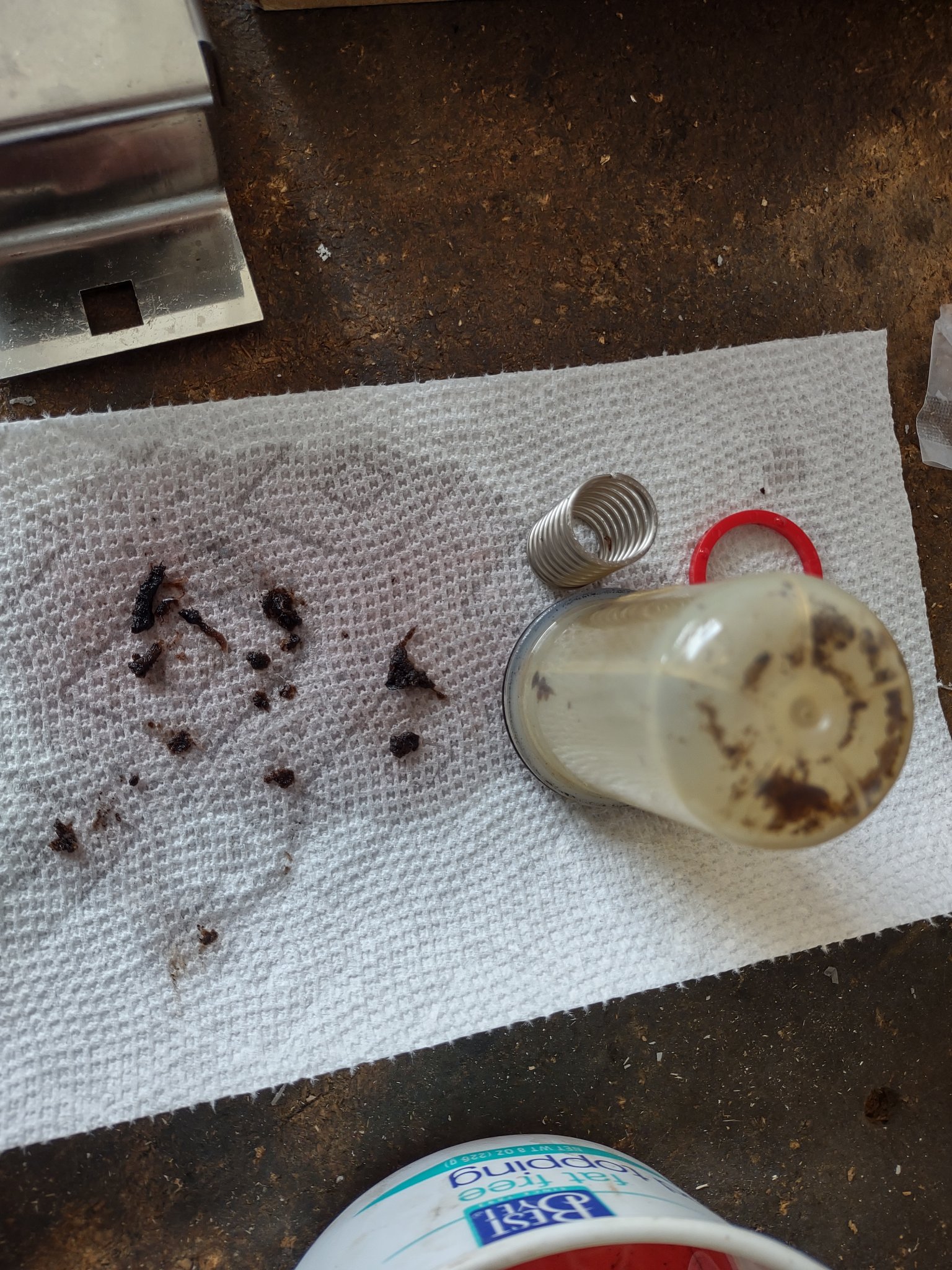

My water separator was getting algae in it. I am using PS Bio Kleen. The big pieces on the paper towel is grease. The small stuff is algae.
I have 6 5 gal. gas cans. They have maybe a pint of fuel left in them. I emptied them into the coffee filter and found grease and algae in the cans.
The fuel station is giving this to me. I heard from someone else that was getting there with the same issue.
I reported it to the owner but he says he does not have a problem. It is the last time I buy fuel from him.
The water separator seems to stop it.
I tore apart the spin on filter and found nothing in it.

Anytime water is introduced to diesel fuel, bacteria (not algae) can grow. It could come from the station, but it can also happen in your fuel cans or tank. It is best to maintenance treat it, so that it can't grow.

You either have water in the fuel storage container and/or the tractor fuel tank That will allow bacteria to grown in the fuel as it lives in the fuel/water interface. When you use BioKleen it will kill the bacteria but you still have to deal with bacteria and its waste. It doesn't disappear.
