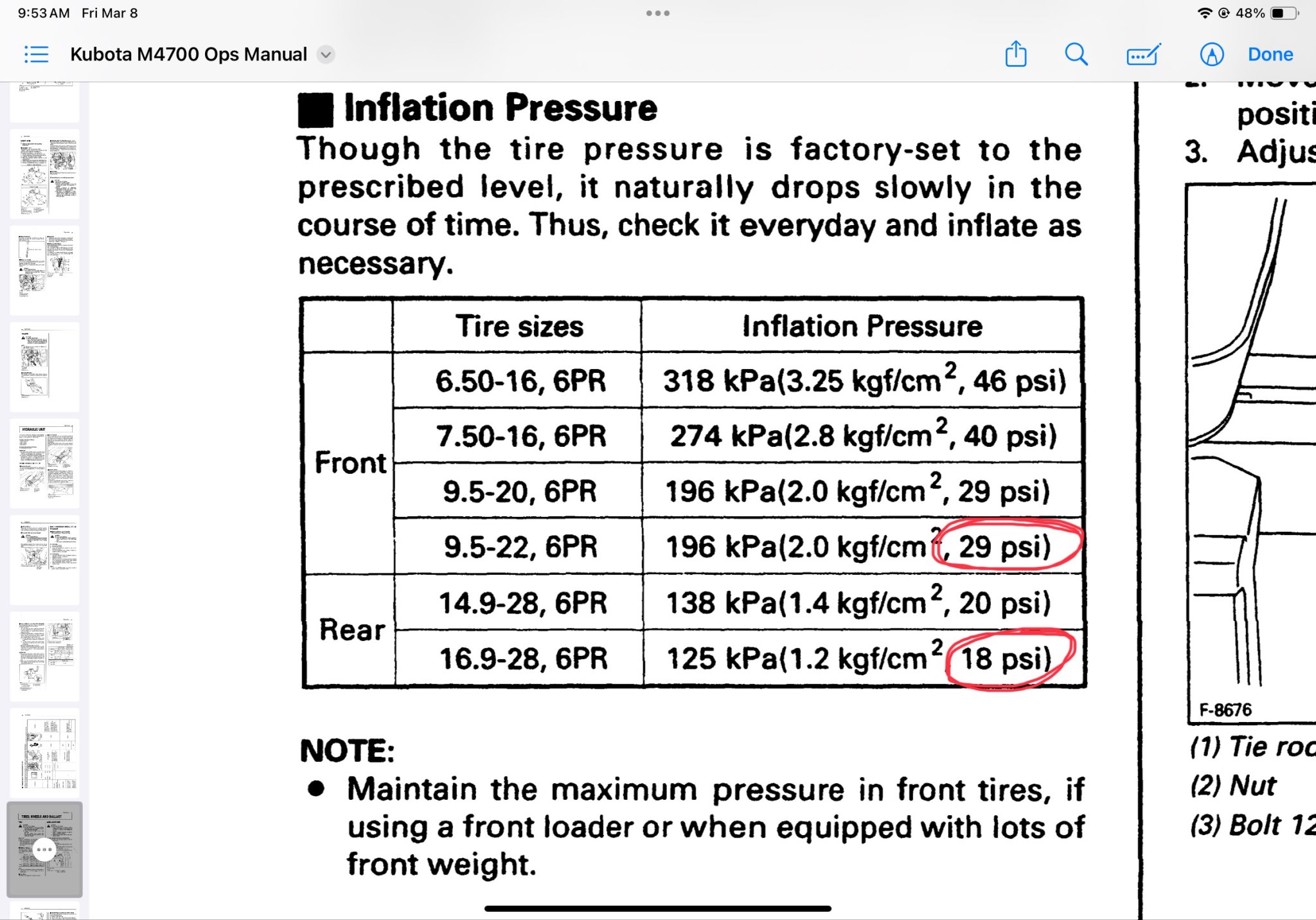

Sooo… I went out to my M4700 which has it’s original OEM tires and the front tires have on the sidewalls “32 psi… Max” No weight rating is noted. (Bridgestones - Japan)
And the rear tires have “Do not exceed…. (blank) psi at (blank) max load” and then just-below that “(Blank) MPH max speed” (Firestones - U.S.)

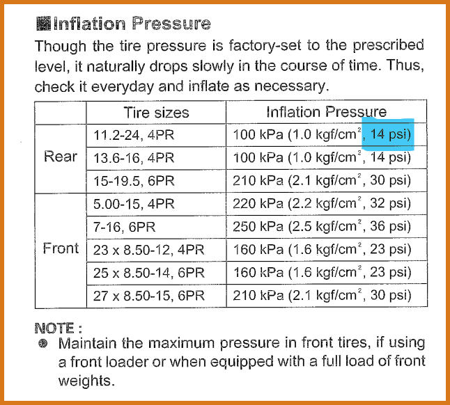

The Operators Manual shows the following:

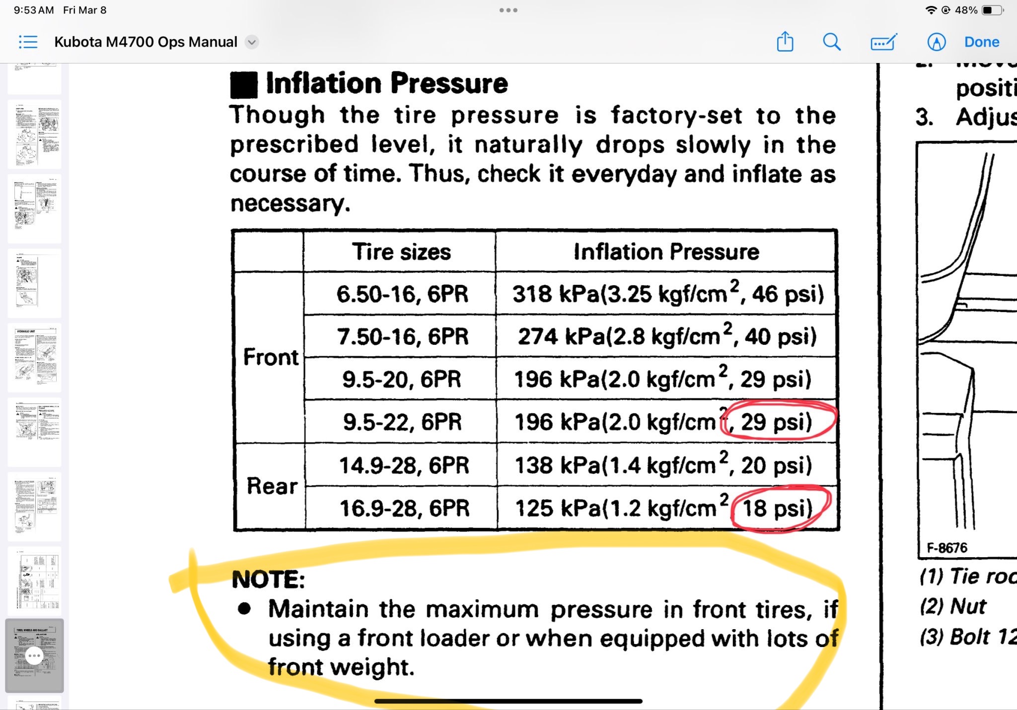

Thanks for looking it up in the OM and making my point so I didn’t have to… IMG_2018.jpeg

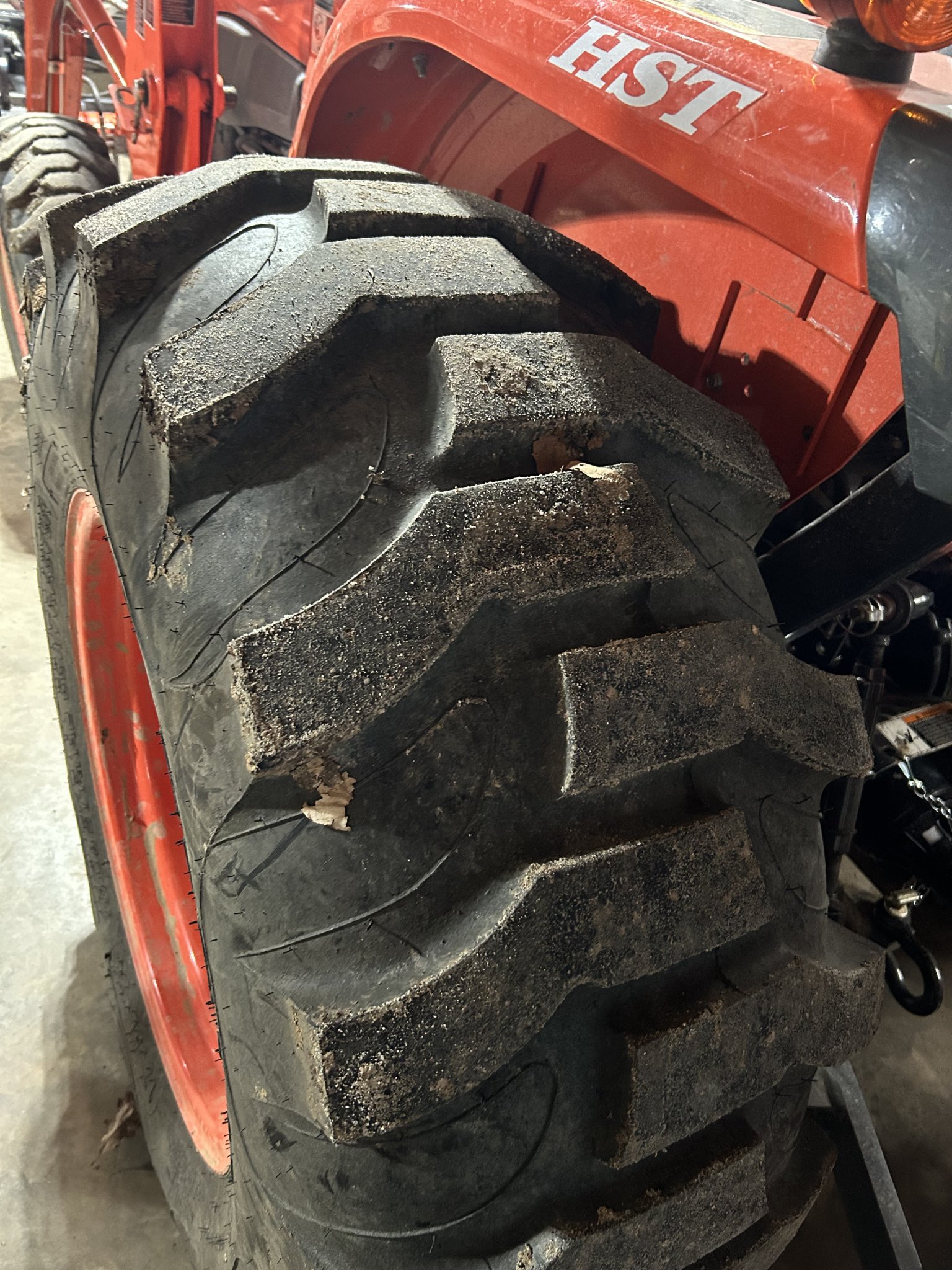

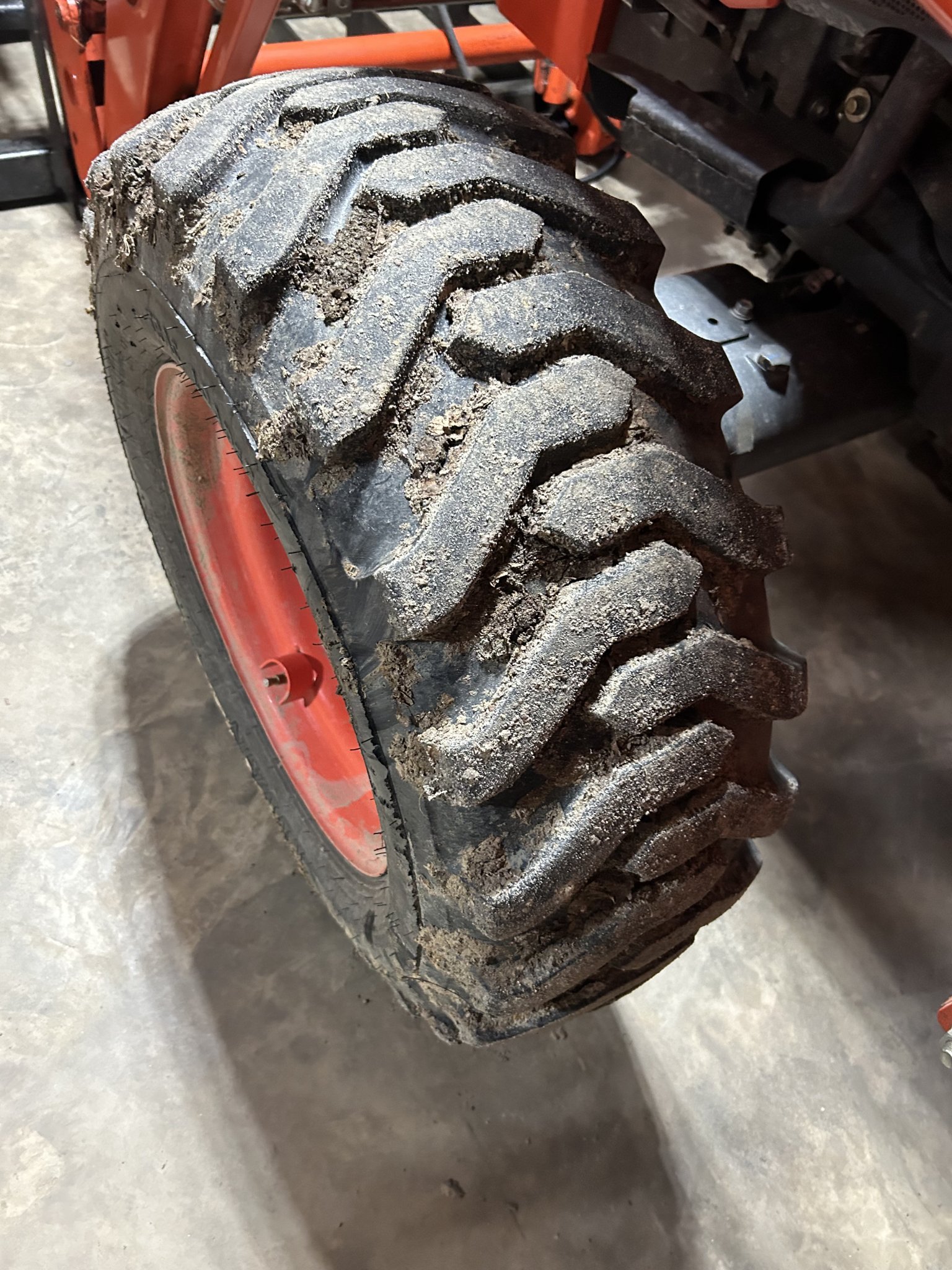

So far as wearing out the center of the tread due to over inflation…
This front tire is running 45psi (max per sidewall)
This rear tire is running 15psi…
See how the tread profile of one is rounded and the other isn’t?
Yeah, me neither. We’re not discussing passenger car tires.

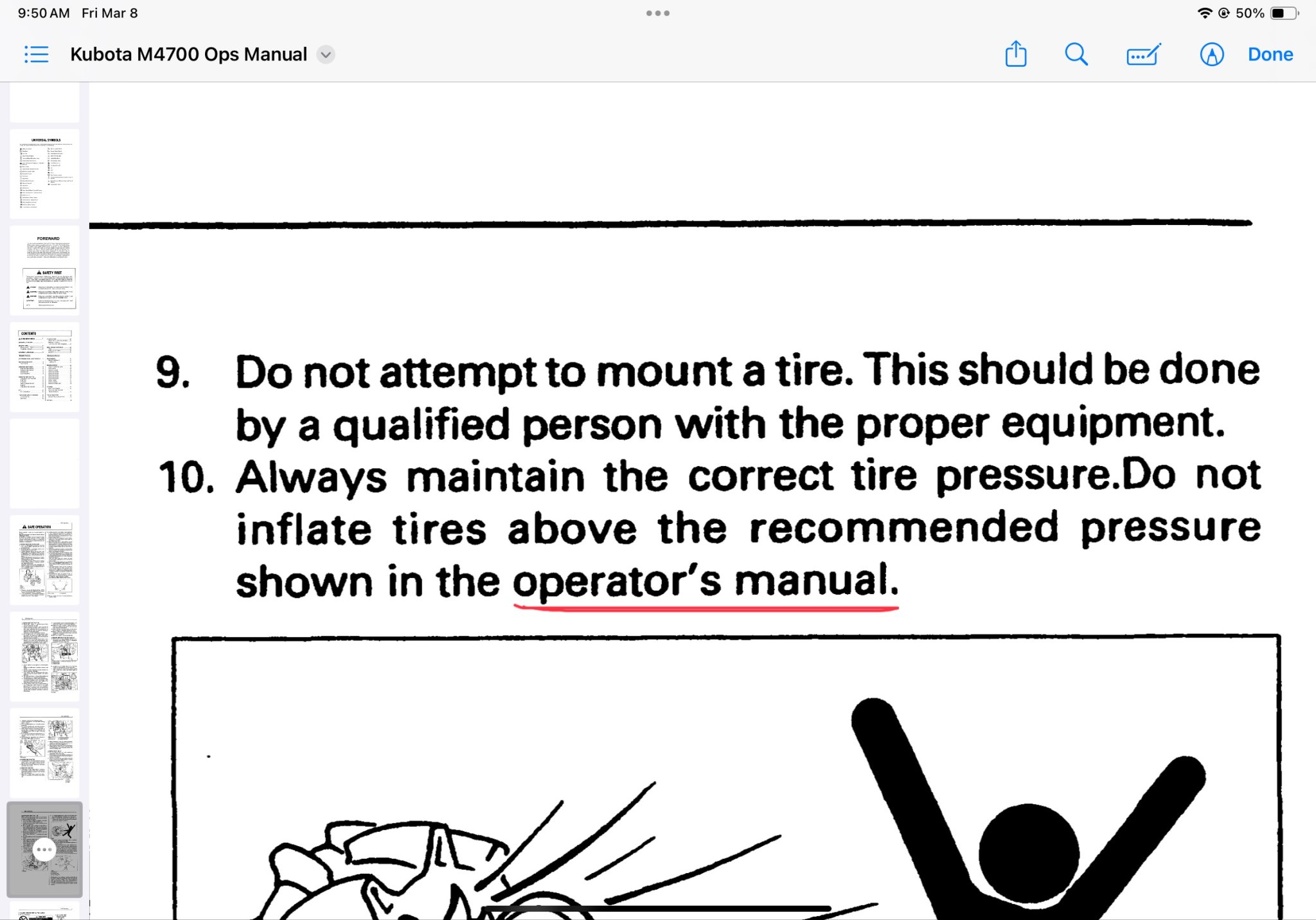

Thanks for looking it up in the OM and making my point so I didn’t have to… View attachment 123869
Yes …BUT….the Max pressure.. AS SHOWN IN THE OPERTORS MANUAL….is 29 psi….. NOT the Max Pressure as shown on the SideWall.
But… your machine, your rules.
Sorry my friend…but clearly there IS a Crown (rounded tread) evident…. Although ..Agreed….the tread IS also designed to provide maximum traction contact… with whatever psi is used.
Obviously there’s a crown in both the high pressure tire and low pressure tire. That’s the way they’re designed, both R4 and R1, but you already know that so I really shouldn’t have to say it.

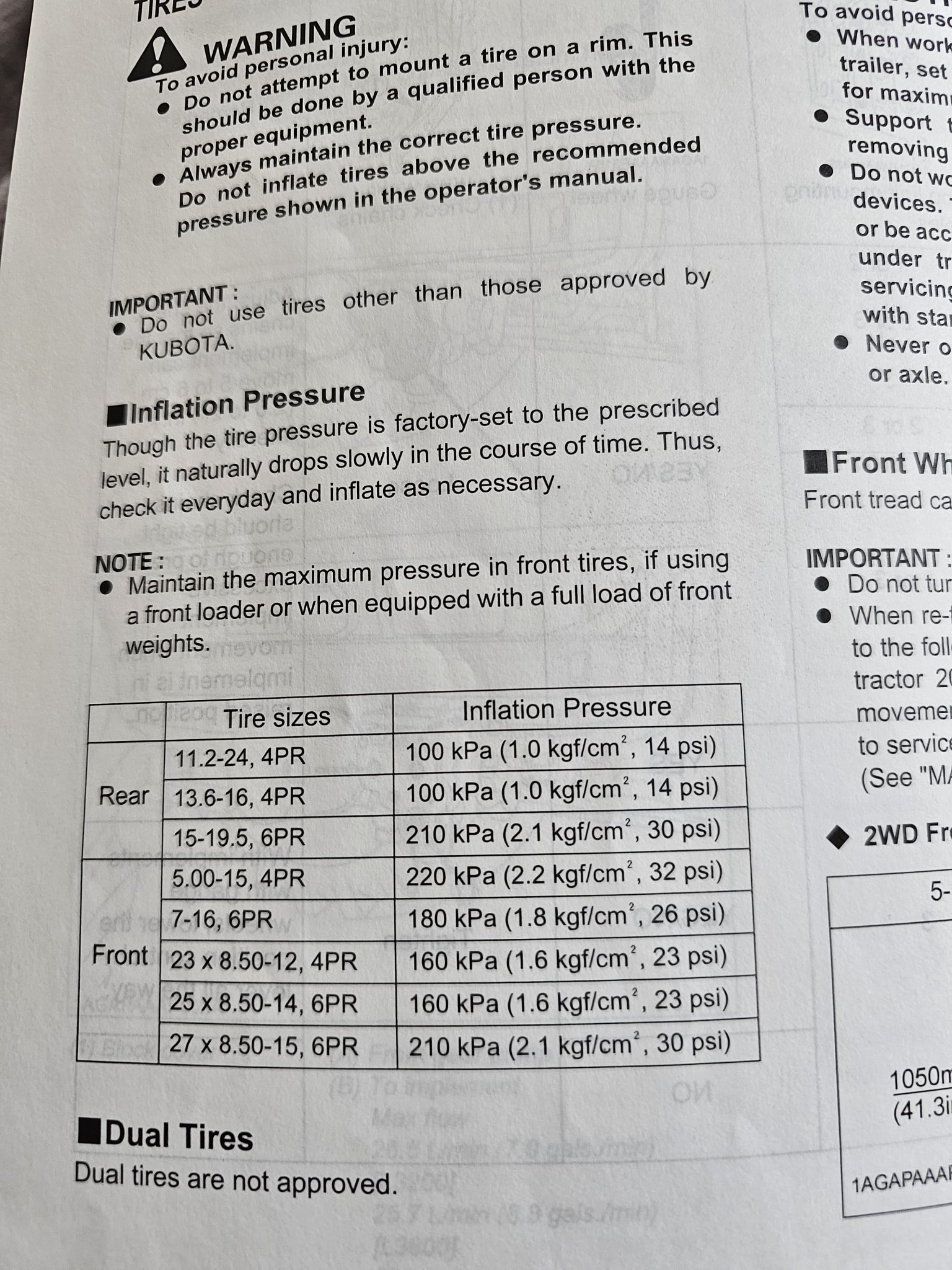

Worth noting that the OP asked about the REAR tires, not the front. The answer is 14 psi.
Yes…maintain the “maximum pressure” in the front tires if using a loader…. That “maximum pressure is the Max pressure listed in the Tractor Owner Manual Chart…..NOT the Max pressure on the sidewall…

BTW, In my case (B7510 w/ 23x8.50x12 fronts) the sidewall MAX is 35 PSI and the chart in the owners manual is exactly the same. IOW, for the FRONTS I run the max sidewall rated pressure. NOT the case for the rears, which again, are the topic of this thread.
