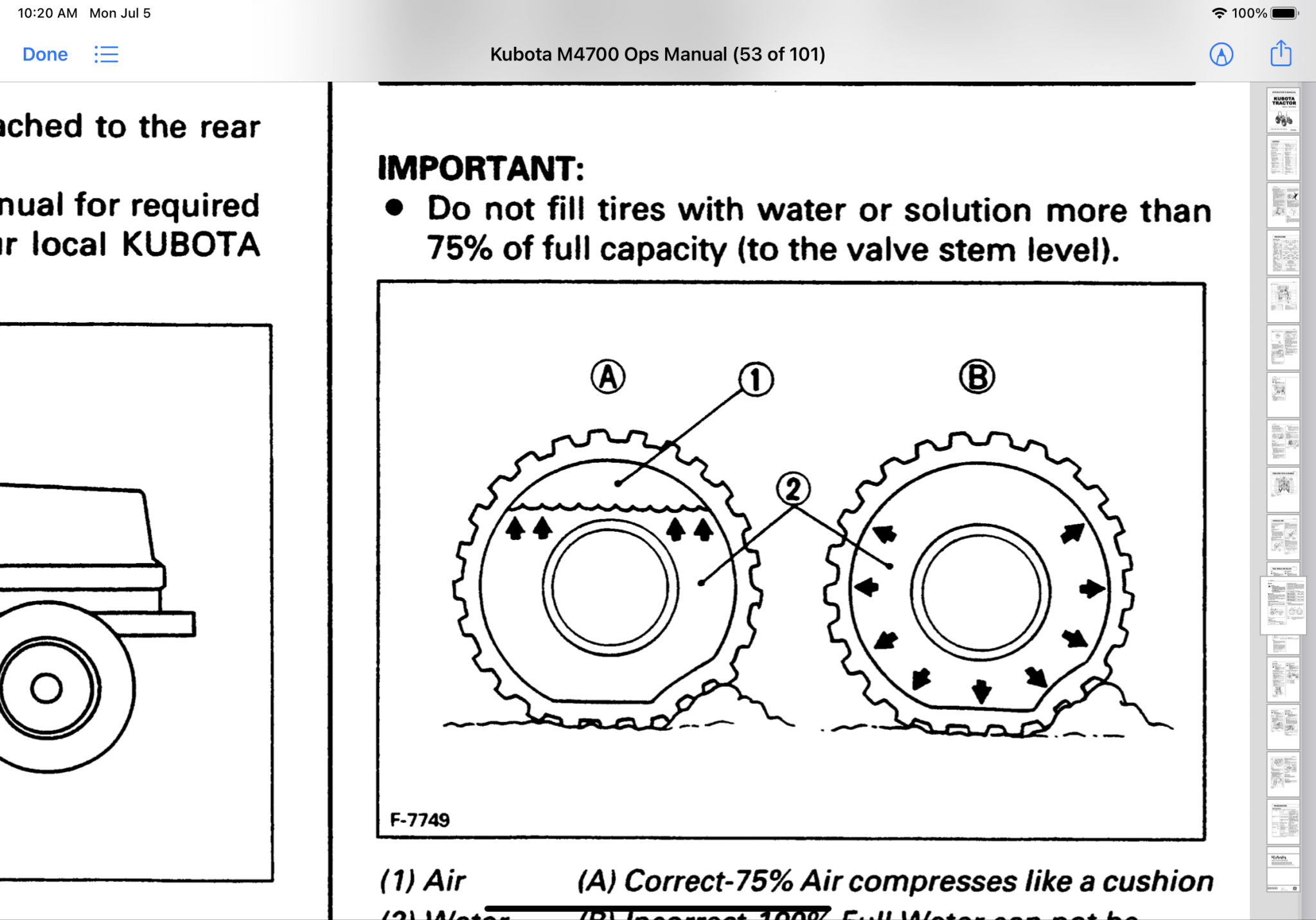

One of my rear tire looks low. They are loaded from the deal. I’m a newbie with tractors and have posted lots. Trying to learn as much as I can and I have learned lots from OTT. My question is how do I check the air I’m loaded tires and how much air should be in them........... thanks for all the help

Move the tractor until the schrader valve is at the 12-o’clock position (where it’s in the air-pocket that is indicated by the numeral “1” arrowed in the depiction…) and THAT is where the valve should be to check air pressure. (Your Owner’s Manual is your friend.)

To check air pressure rotate the tire until the valve is at the top. That will put air behind the valve. The tire should be no more than 3/4 full so there will be air space. If it's a rear tire it should have about fifteen pounds of pressure.
