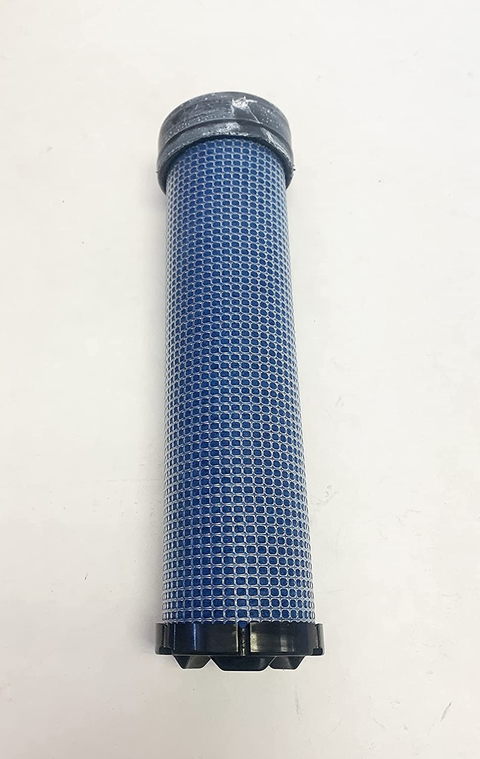

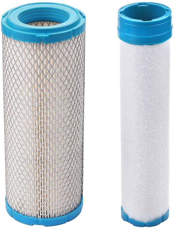

Amazon sells the generic TA040-93230 and the inner filter for 1/3 of the price as the OEM ones. Does anyone see a problem with an aftermarket air filter? I wouldn't probably use an aftermarket oil filter but, reviews on the air filter seem great.
Is there really a difference? If so, I don't mind paying the extra. Just want to get some feedback.

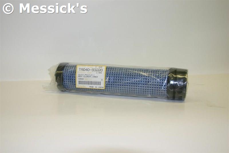

I used your advice and went and just looked at the photos to compare them. I decided to go with the Kubota ones. There was a complete difference on the inside filter--difference in the materials used and actual design. Maybe it would have been fine but in the end saving $26.00 is great but not if it doesn't work properly.
