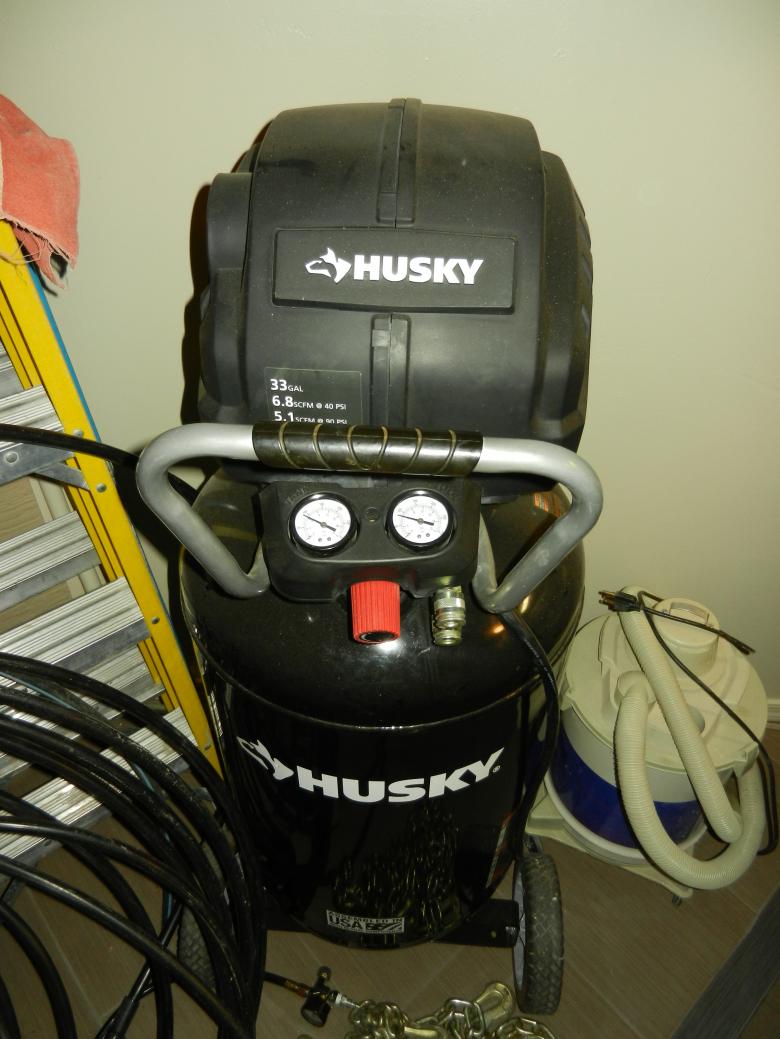

I have a 26 gal 220v horizontal Campbell Hausfeld. Its nearly 20 years old and runs like clockwork with a 6hp motor. Of course, during the early part of my remodel, it was in storage. I had no 220v yet anyway, so I was getting by on a nice little 10 gal diaphragm Husky a friend had used for years and then gave me when he moved.
I had arranged for an entire framing crew to come over and tear out about 80' of exterior wall and replace it. A HUGE days work. At 8:00 PM the night before, the contractor who was loaning me his crew texted me and said their compressor had gone down. I would have to supply the entire crew with air!
I hit Home Depot that morning and it was the Saturday after Black Friday and they had some deals. I grabbed this Husky for $200 and hauled it home. That dadgummed compressor has been one of the best investments through this whole remodel. Its easy to move, fairly quiet for its size, it has a big 33 gal tank, and it re-fills fairly quickly. And, its footprint is about 18" x 18" while its over 48" high. Runs on 110v and I couldn't be happier. And, it ran the whole crew of ten guys (three air nailers going non-stop) all day and didn't break a sweat.
Here are the specs...
