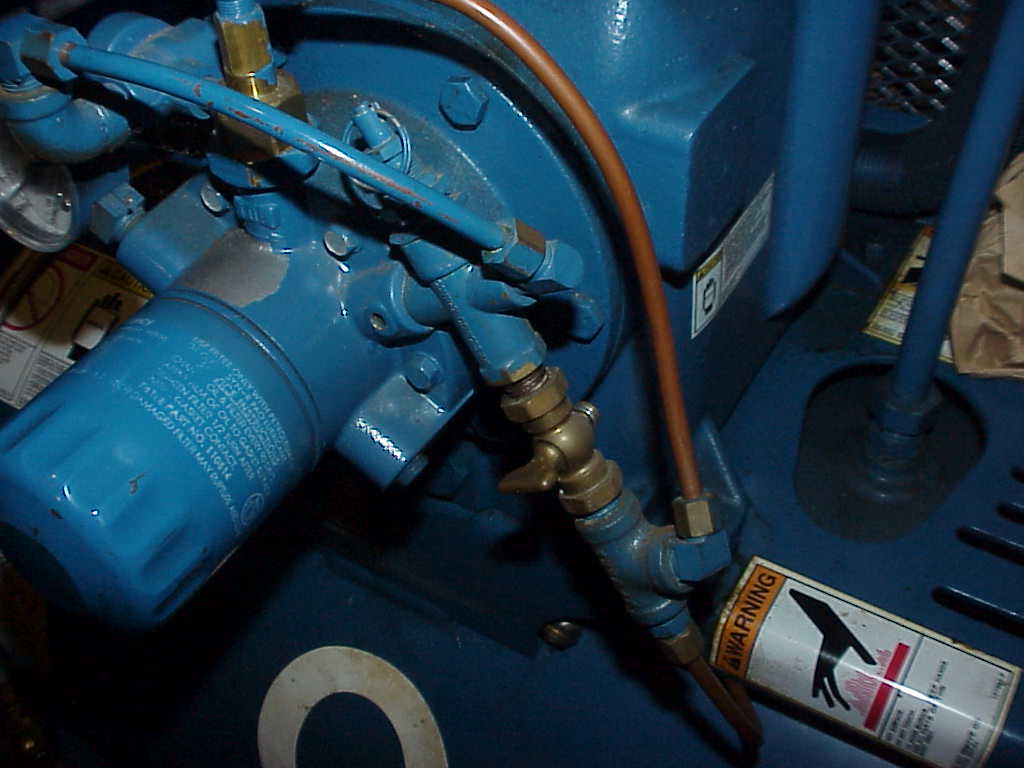

I have the same compressor and there is a twist valve on the compressor head plumbing that allows to motor to keep spinning when the cut-off switch tells it to stop. I use it for sandblasting and the compressor keeps up with my blasting.

Those valves seem to have a design problem. Mine were "reconditioned" under the warranty, and they still leaked. Then they replaced them under the same warranty. Today they still leak, and I have learned to live with it.
Below is a picture of the valve. I doubt that you have one on you Quincy since mine was a "special offer" and I had to install it myself. I don't remember if the driver handed it to me along with the instructions on how to mount it or if he told me how to do it and what to buy. That is darn near 40 years ago, and I am not even certain about that timeline. I guess it was too much for them to install it before the compressor was delivered. I installed the brass valve and the copper line. I will have to get a picture of how the copper line connects to the painted blue line. There might be something in the manuals about this, however, I am not even certain where they are.
Nope!
Totally different location, and very different valve!
The valve I have a leak problem with, is an automatic pressure release type valve, and is on the head of the
compressor.

Nope!
compressor.
Yep, that is the one that I was referring to, there are 2 of them on the top of the head. One for the high-pressure piston and one for the low-pressure piston. The other valve is the constant run valve with the copper tubing. Two entirely different things.

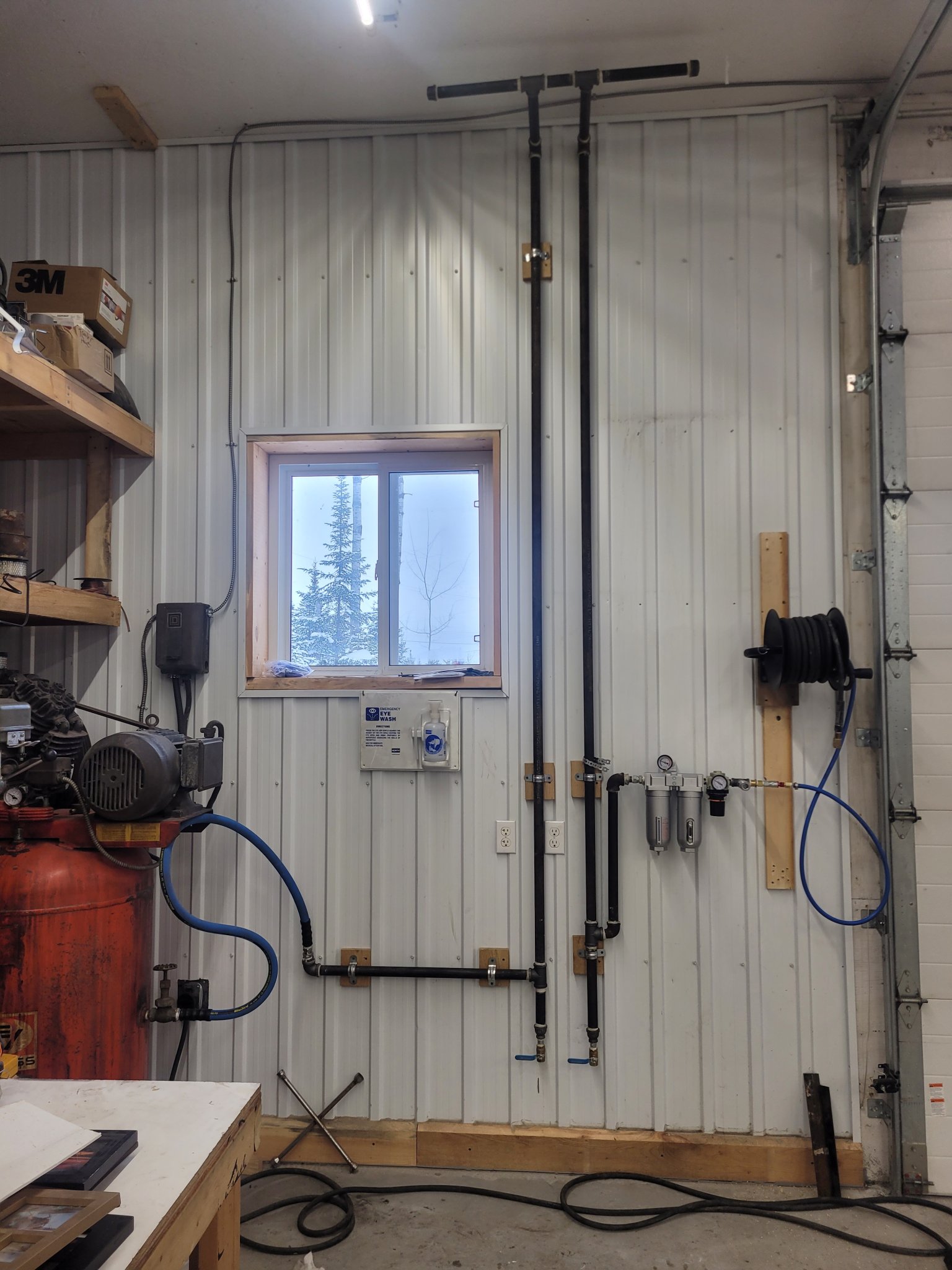

Well i finally finished plumbing some air lines. I had 1" black pipe on hand so thats what I used. I have one 1/2" coupler and a 1/2" hose for my little sand blaster, it wont starve for air! The reel has a small water seperator on it as well, so this should be pretty dry air. Certinally overkill for the odd nailer or cleaning a rad! But, im future proofed now for a pretty good price!
I borrowed a plasma cutter and sure was glad to have the air supply from this rig.
A new tank in the 60-80gal range is well over $1g for those that suggested that.

Your install looks very nice!
BX23-S,57 A-C D-14,
13,846
6,295
yes, looks real good but....
when you have time, please reinstall the belt guard on the air compressor..
..not that the belt will break and cause you harm.but when the pressor 'magically' cutsin while yo're standing here, scares the beejeebers out of you and your hand lightly touches the belt and gets pulled round the little pulley
