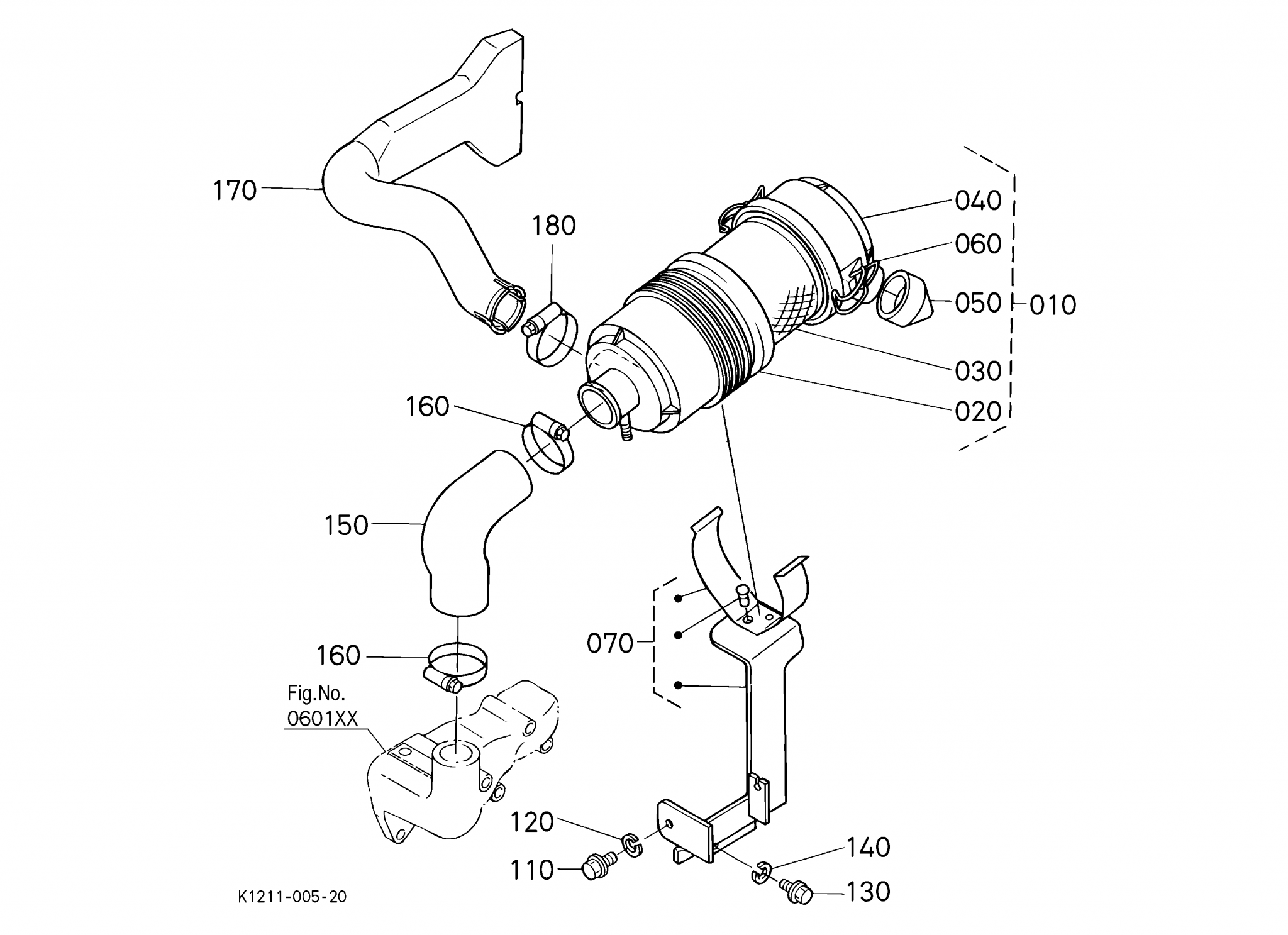

So I noticed what appears to be an air chuck on my air filter housing. It doesn't fit a standard tire chuck though. It opens to the inside of the filter and I have to assume sending air through there blows out the filter element so debris can escape through the funny looking rubber "lips"? What type of air chuck fits on it?

hmm.. wonder if it's the thing at 6 o'clock,on the housing, near clamp #160 ??
pumping CLEAN compressed air in there, would blow backwards through the airfilter AND put air into the cylinders ?
or
could it be some kind of 'drain' ?
or
should some 'sensor' go there ?
Curious, now I NEED to know what it's for !

More than likely you are referencing the fitting that the air filter restriction switch would screw onto. It would be a 1/8NPT stem near the outlet of the filter.

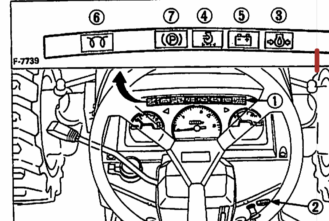

My L35 has a light on the dash, no. 4. It comes on when starting, like the oil pressure light. Now I'll have to go find what the switch looks like

would just light an indicator on the dash for operator. Others like what d2 posted would give you a visual when you do your checks.

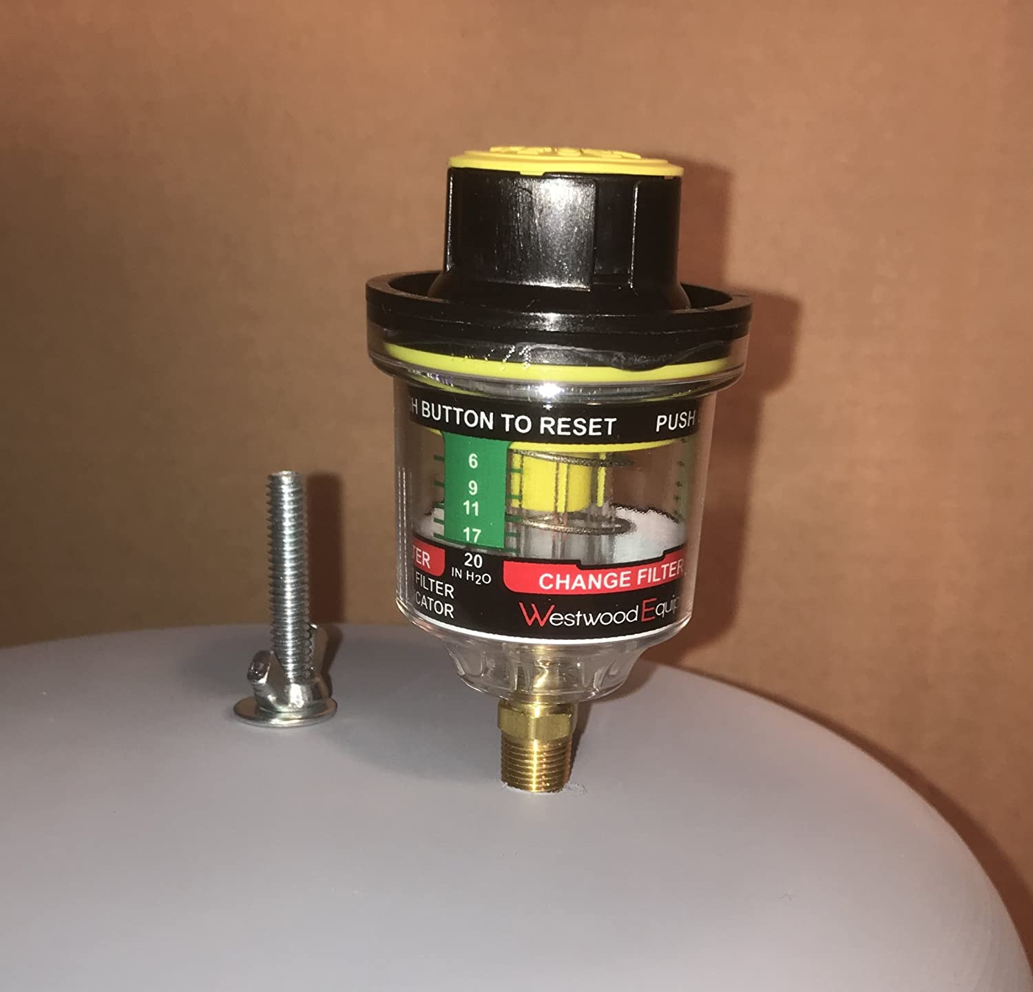

That's where you can attach a restriction gauge to show when the air filter gets plugged.
I used that same filter housing on my Yanmar genset and attached a restriction indicator there.

I'm gonna have to look into that. I bought new air filter(s) (I keep a spare) for it from the dealer. But the elements are gray. So even new they look dirty LOL. So other than obvious debris it's hard to tell if it's dirty
