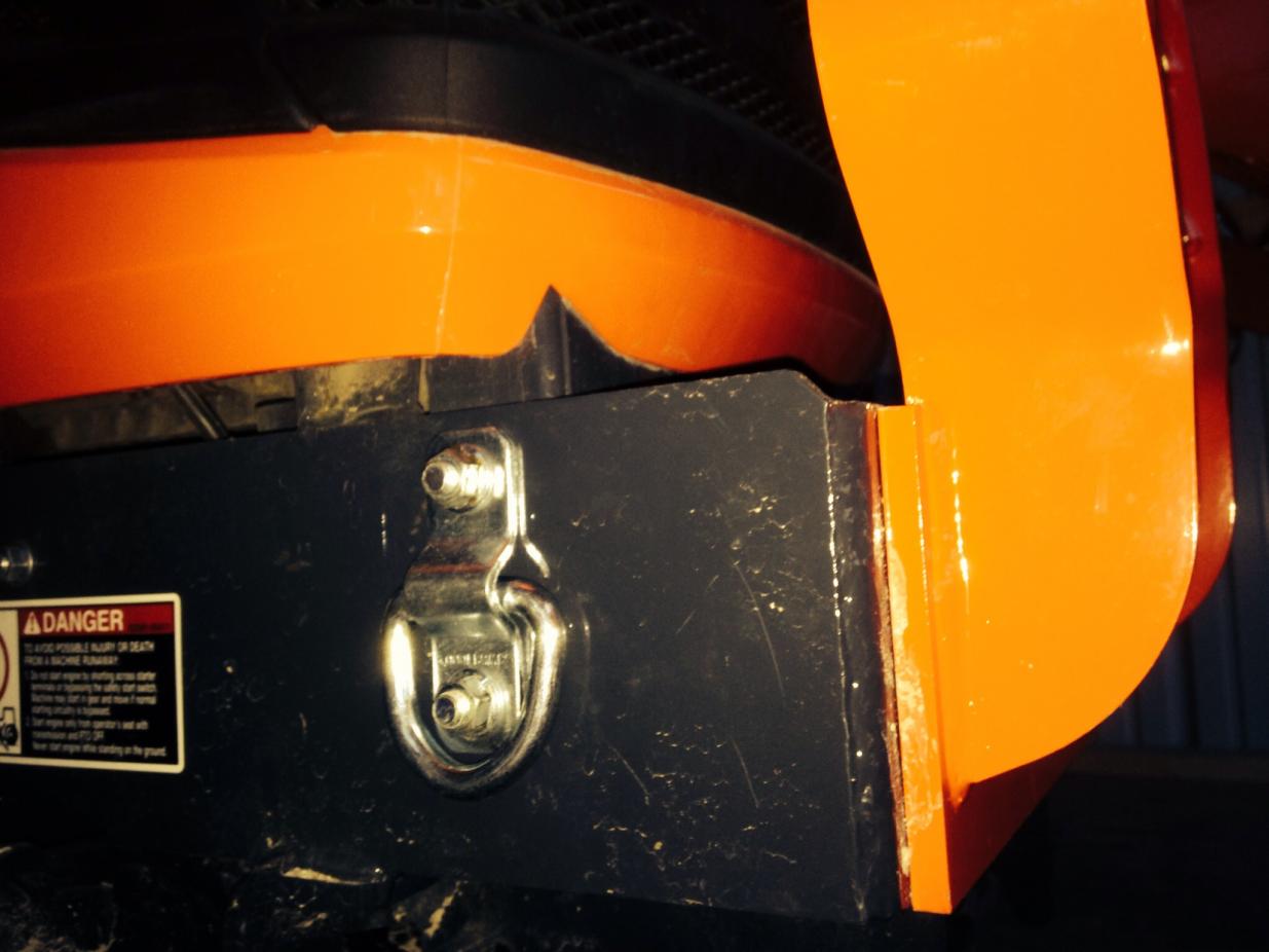

Kind of forgot about this thread, so here is an update. I looked over the 2370 and found it had 2 bolts one above the other at the front of the frame rails, they measured 2 1/2" inches apart. I went to a local tractor supply store and found a set of d rings rated at around 1800 lbs, removed the nuts from the bolts, bolted on the d rings and now have a nice place to attach the tie down straps for securing the tractor on the trailer. Total cost for both d rings was around $8.00! View attachment 11204 image.jpg
I will post some more pics when I am around home computer, pain attaching pics from iphone.
35,001
10,246
northender,
Was the D ring welded together on the joint?
I've see a few of the cheap hardware store one's that just pull apart under load.
