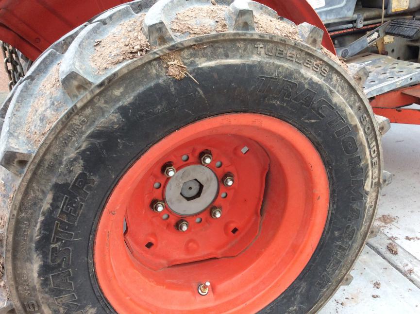

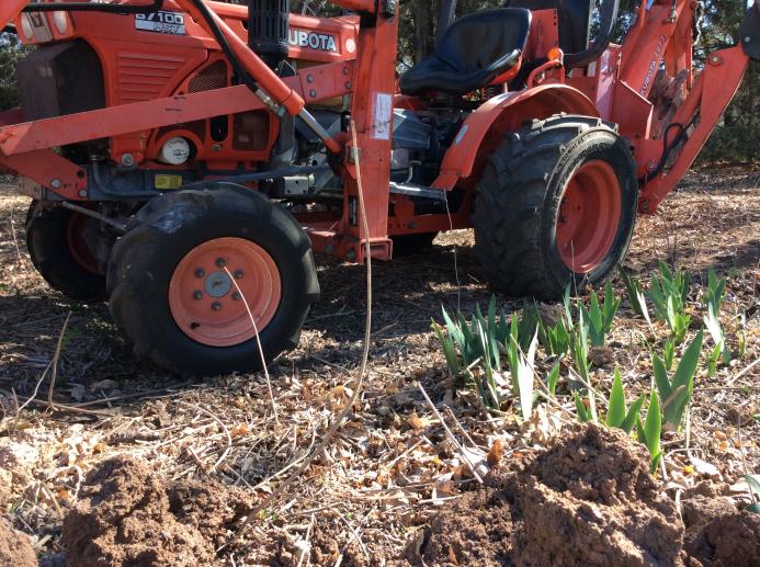

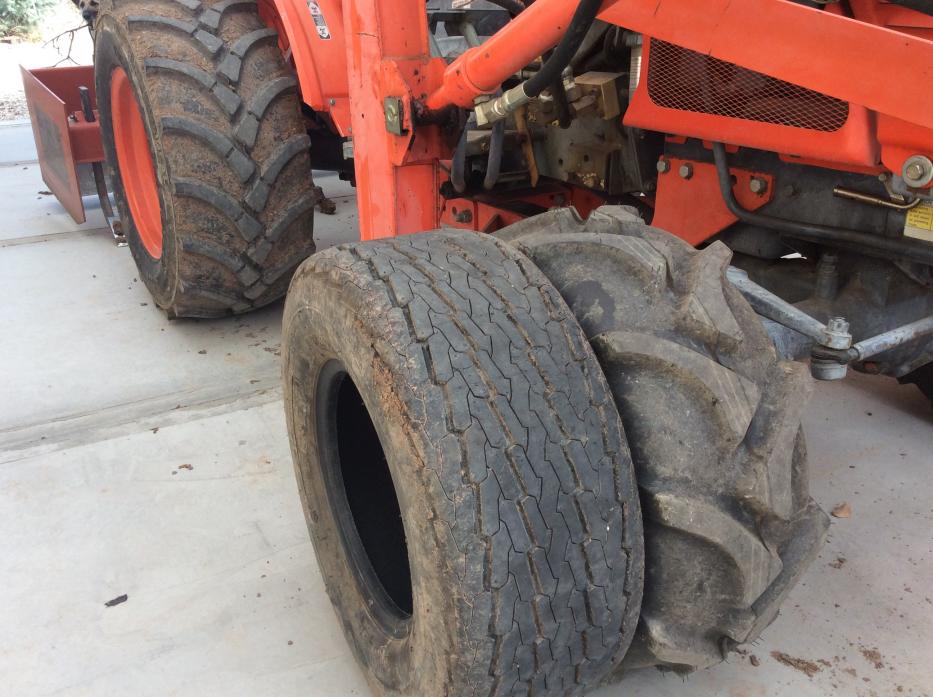

Hi Kevin, welcome to the forum. Hokie and NIW are right about the rim change if you want traditional narrow R1 tires. However, if you just want a bar tread you can keep your current rims. Hodge and others found the Kenda tires for the front and there are several options for the rear.
