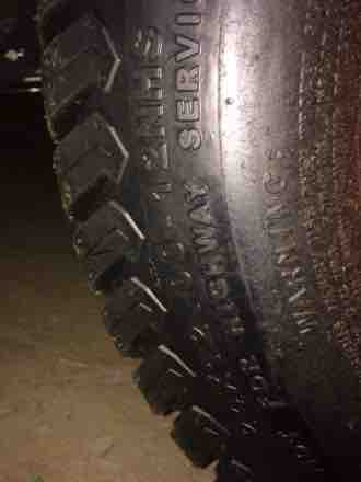

Thanks guys. My driveway is about 125 feet and I have plenty of room to put snow and dump it farther using my bucket. I really didn't want chains since my driveway is concrete but I had to use so be it. When you mean loaded rear tires I assume wheel weights? Tire size is 24x12.00 x 12NHS. If so where is a good place to get weights, I live in upstate NY so we can get blasted with snow IMG_3123.JPG

My picture also shows how chains get down in between the treads of R4 tires, but if kept tight they work well on the other side of the tire. I can’t get by without them. Been thinking of fronts too, but that can be an issue with binding the front drivetrain.
