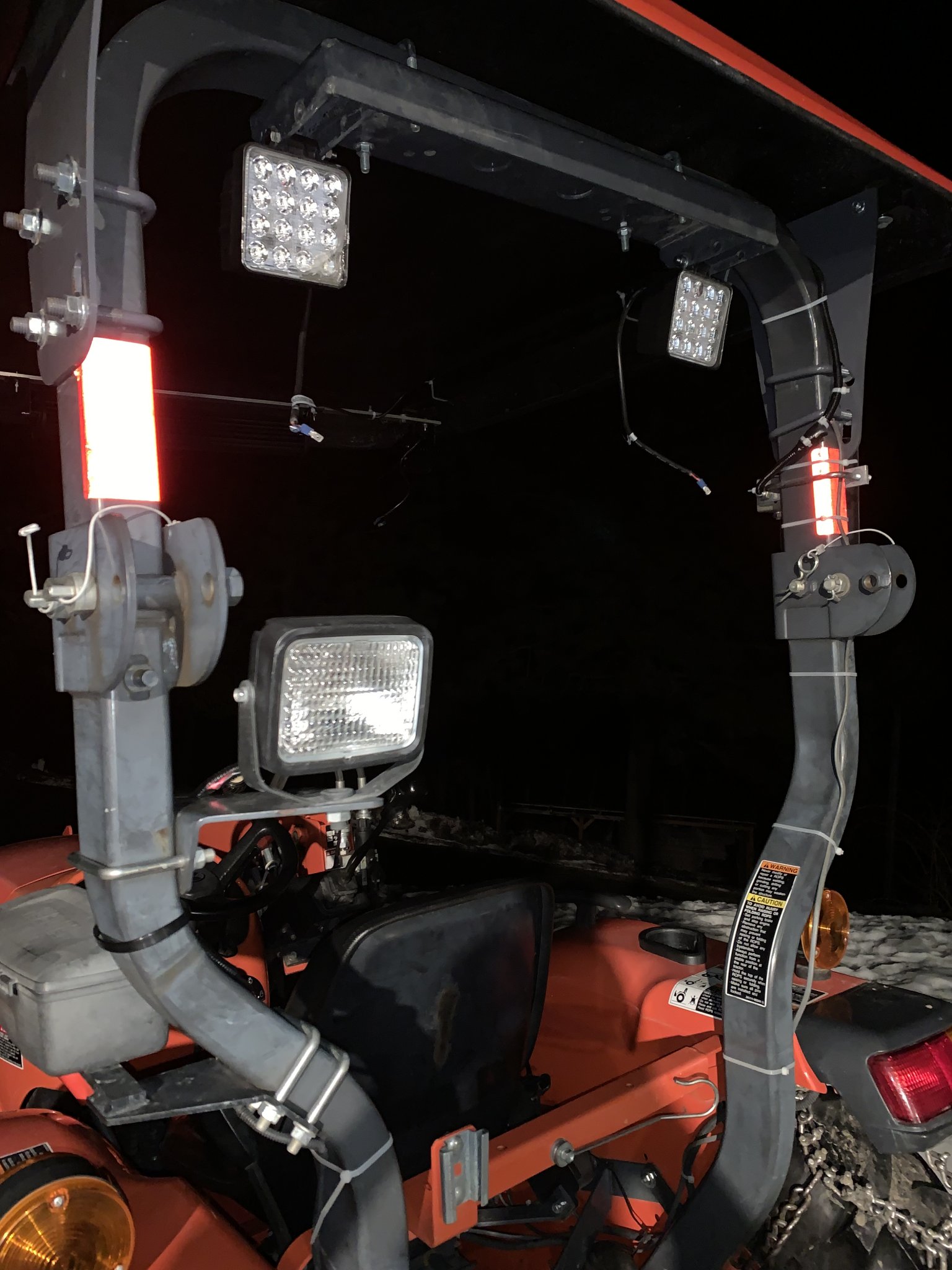

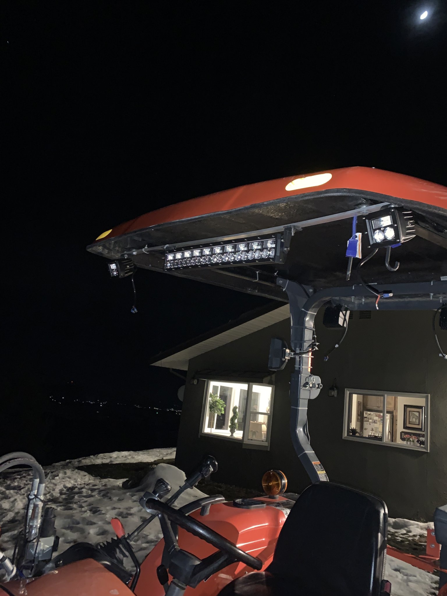

I have work lights on my 2012 l3800 that came from the dealer installed. There is a rear work light that plugs into the extra wiring plug under the left rear left fender which has its own on and off switch on the rear portion of the light. There is also a light it appears to be wired into or behind the fuse box with wiring running through the middle of the tractor under the tin. This wiring has its own in-line fuse and and on and off toggle switch for a front work light. Both are located on the ROPS. I recently added a 22 inch LED bar the front of my canopy and spliced into the front work light wiring so that both lights run off the toggle switch. It works really well and I can use the original work light to illuminate both the left and right side of the tractor as it swings almost 180° horizontally. I then decided to add 4 additional LED work lights (2 high intensity lamps I have had for 5 years) and 2 lights less intense lamps that came with the light bar. The light bar and 2 smaller lamps also came with a wiring harness with toggle switch and an in-line fuse of 15 A. I spliced the wires from the rear work light and tied in the wiring harness. immediately I heard an unhappy sound. The rear work light is wired into the fuse box in position 2 which is a 10 amp mini fuse. 6 fuses later I have decided that a need to do something different- even attaching just one light caused the fuse to blow. After spending a couple of hours scratching my head and replacing fuses I reconnected the rear work light wires properly and disconnected the new wiring harness. The rear work light works just fine now but I do not have my for additional lamps wired up. The instructions that came with the light bar and lamps show the harness being connected to the battery. I thought I could bypass this by using an already active circuit. I am definitely inexperienced when it comes to wiring and would prefer not melting a wiring harness and complicating an otherwise perfectly good day. any advice would be appreciated.
