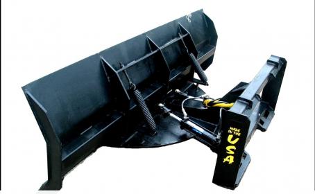

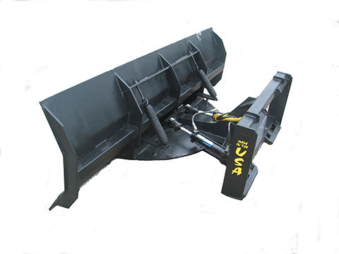

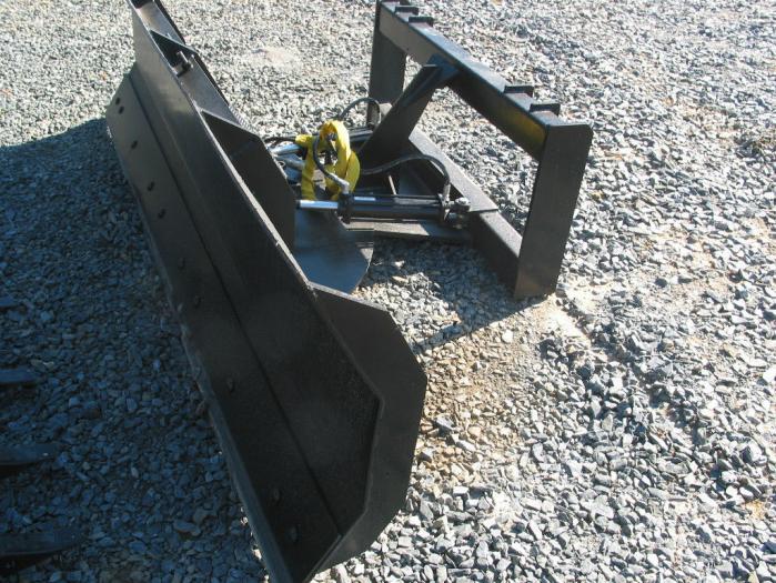

Hey guys. I'm wanting to add a 7 ft. snow plow (pictured below) with the quick attach mount to my L4060 tractor. The plow has two hydraulic cylinders with two quick connect hose ends on it. What I'm wanting to do is connect the snow plow and set my curl angle of the blade. Then disconnect the two curl angle hydraulic lines. Connect with extension hoses, the two lines coming from the snow plow. This way I can still raise and lower my plow and also using the side to side motion of my stick, to turn the snow plow from left to right.
I called my local Kubota dealer today and they said that wouldn't work. I would need to add a $1,100 3rd function system instead. As little of snow that we get here in NC, I'm not wanting to invest $1,500 for the plow and another $1,100 for the 3rd function.
Is anyone out there, other than my buddy who told me this works just fine on his Kubota M series tractor, doing this method? Seems like it would work just fine to me. Suggestions?

The cylinders on the plow I'm buying are two way cylinders. Exactly like the cylinders on my front end loader. See pic below. I just don't see spending an extra $1,100 on installing a 3rd function when I don't have to.
EDIT: With 2 way cylinders on the blade tilt, it should work fine and dandy!
Yep I changed my answer when I read what you posted, I load too many posts then start replying and you were on the end of the list, so what I was answering to was your original post! :eek:
So yes Dual action cylinders change the game completely! :D

It's got 2 double acting cylinders to control blade angle? How does that work? Are they plumbed in series?
34,342
9,578
They would be connected in reverse parallel, one pulls the other pushes, and vice versa. ;)

One thing to note:
If you did a diverter valve 3rd function, which is way cheaper than a standard 3rd function, you would still retain the ability to tilt the blade to the proper angle (horizontally) to get the right clearance and dig out of the blade. ;)
Also not to be Captain buzz kill:
But that Blade is not going to be a good snow blade, it doesn't have skid shoes on it and without being able to curl the blade it's going to be super unmanageable. That's a dozer blade. and without being able to curl it your going to run into all sorts of headache's.

I have an old Fisher truck plow and made a plate to attach to FEL in place of the bucket. It was set up with the FEL in full curl and uses the curl function of the joystick for plow angle. It has worked great for years.
As mentioned already, without skids that plow is going to really dig in. I have skids on mine and the first couple uses before the ground freezes can still have the plow digging ruts.
My buddies that have used these type plows and truck plows all tell me the first thing they do is remove the skids. They said they are worthless unless your plowing a gravel road (which I don't plan to).
I also watched a youtube video with Paul Short. He has a ton of plowing experience. Check out this link below. Fast forward it to 9 min and 15 seconds. He talks about how to place the plow and using float mode.

That is not a dozer blade. Dozer blades don't have spring trips on them. However, I would doubt that the ground is frozen hard enough in NC to run a plow without skid shoes to keep from ripping up the dirt.
Very true and you are correct. Our ground is rarely that frozen here in NC. When I've plowed in the past using ATV's and my RZR, I only used the skid shoes when I plowed gravel roads. Do you guys use skid shoes on pavement? Seems like it would eat your skid shoes up quickly. Plus, I've always had more success with the plow directly on the road surface.

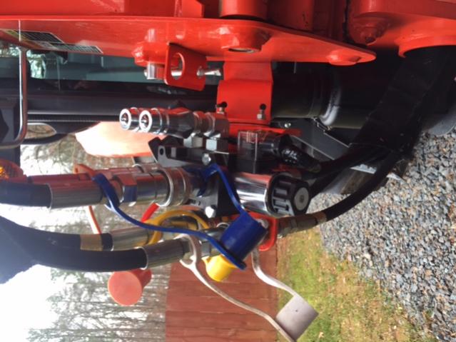

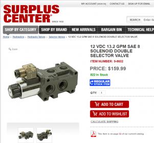

UPDATE- Hey guys. Decided to go the diverter router for my snow plow. Cost me $172 after shipping and looks like I'll spend about $75 in fittings. End cost around $250. Much more acceptable than the $800-$1,000 price tag for a 3rd function.
If I were a grapple user, I could see the expense of the 3rd function valve and expense. Since there will never be a time I will need to curl my snow blade at the same time I want to angle it, the diverter just made good sense to me.
Picking up my hydraulic fittings today and plan on finishing up the install this weekend. I'll update with pictures when I finish. Pretty happy so far with the install.
Here is the diverter I went with after several suggestions from forum users.

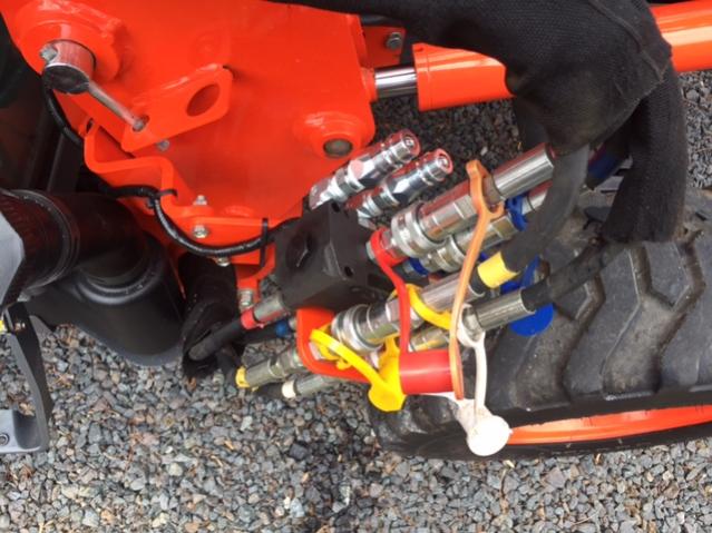

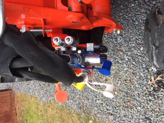

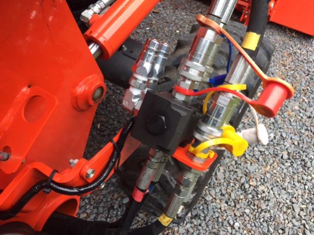

Update- Well, got the hydraulic diverter installed yesterday. Took me less than an hour. Key advice is to take the diverter as I did to a hydraulic shop and have them give you all the correct fittings to make sure everything matches up. That's what I did. I have $75 in the fittings and $175 in the diverter. $250 total. Very pleased with the install and function.
I posted a video when I finished up. Also took some photos.
https://youtu.be/E9Xu1cKTbj0
