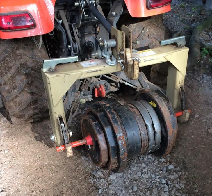

Three foot steel bar, one inch diameter, with two holes drilled in it. The bar is now full, about 425 pounds.

That's exactly what I'm looking to do, except without the implement. I'd like to hang them directly on the lower part of the 3pt hitch. Since it's a BX2370, the 3pt hitch holes are 7/8 inch so I'll have to put a 3/4 inch bar across them.
34,347
9,582
Use the spring clamps on the insides to keep the plates for shifting around.
Drill 2 sets of holes on the ends, one set on the inside of the three point arm and the other on the outside.
On the inside holes use a hair pin and on the outside use a lynch pin, this will keep it in place and cut down on movement.
Also if you can find some rubber belting or a scrap rubber tube, put some pieces in between each of the plates to keep the rattle down. :D
