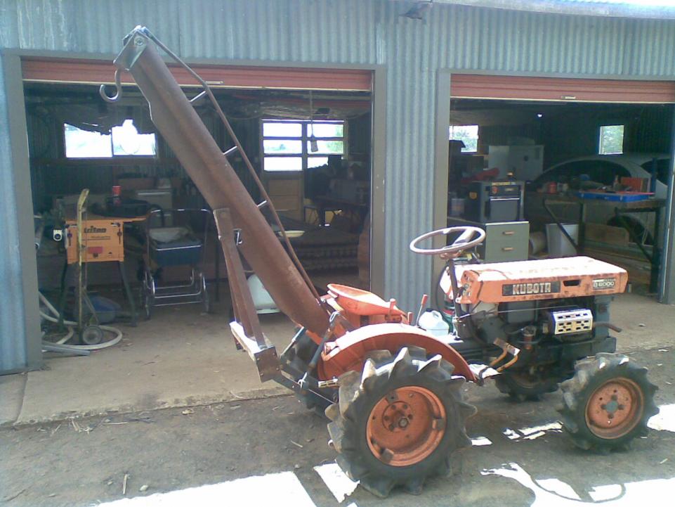

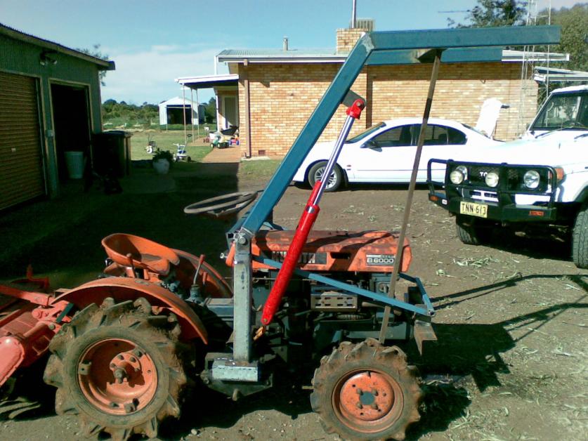

Anyway I built a three point linkage crane for it (see attached photo) and now want to build a front end loader for it as well. The first process is identifying where I can get hydraulic power from. I've seen others connecting to the port underneath the seat (not sure where return goes though) but mine doesn't seem to have a valve just a 'plug' like the 'Iranian' models listed in the B6000 parts manual. I'd also like to use the 3 point linkage and loader at the same time so am not too keen on this option. I've also seen other B series tractors (B7100) and read on this forum (B61000) about using an integration block on the hydraulic lines running from the motor to the back end. unfortunately my tractor doesn't have the integration block and I'm wondering what exactly this is and does it have a part number?
