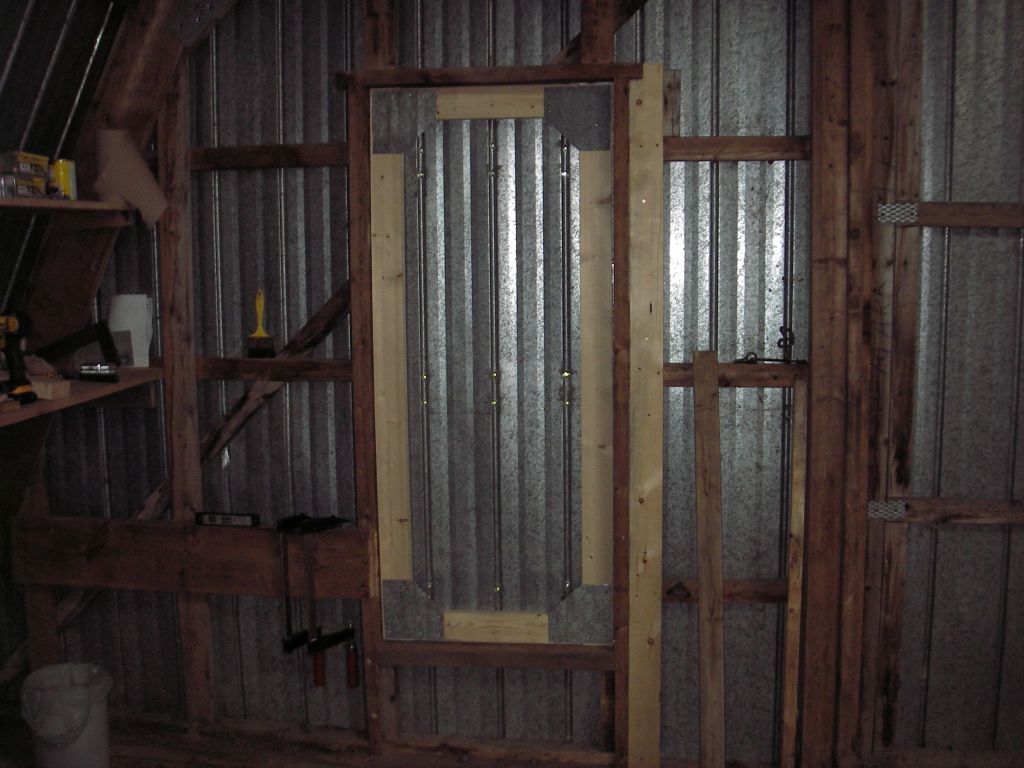

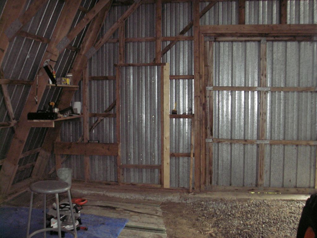

My dad built this shed 45 years ago and had framed in a man door just in case.
I don't know if I've invented a new way of adding a door but it worked so well I'm posting it.
Here is the rough opening after I removed the 2x3s to which the steel was fastened.
Next I attached the door frame to the inside of the steel with a 3/16" gap all round.

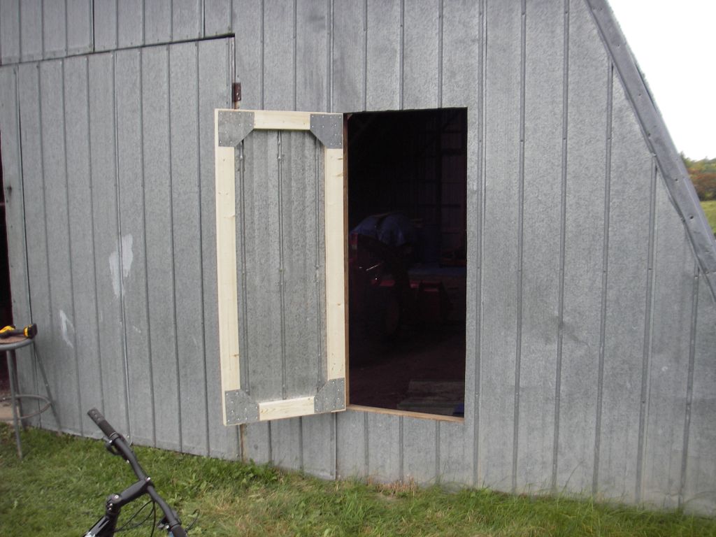

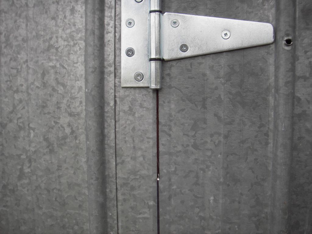

I drilled holes from the inside at all 4 corners and drew a sharpie line on the outside of the steel. I cut the steel with an angle grinder only where the hinges go and screwed the hinges on. If you look close you can see the cut.
So now the door is built and hinged but 80% of the opening is still uncut.

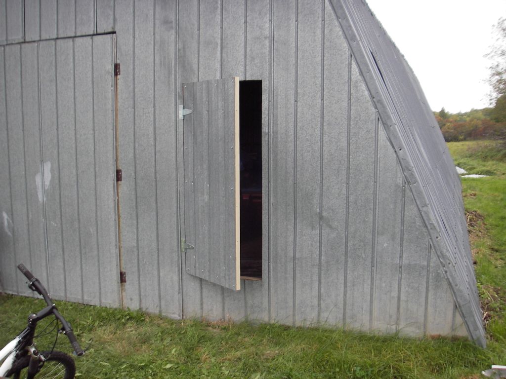

I went round the rest of the door with the angle grinder and swung the door open!
How cool is that? Perfect fit!
The edges need filing to get rid of the steel shards and then it will be just as safe as everything else in the shed. (Which isn't very.)

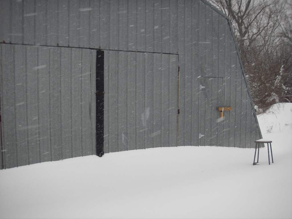

Now I'll be able to get inside during the Winter when ice and snow keep the main doors shut.
Great idea!
You must get heavy snow accumulation.

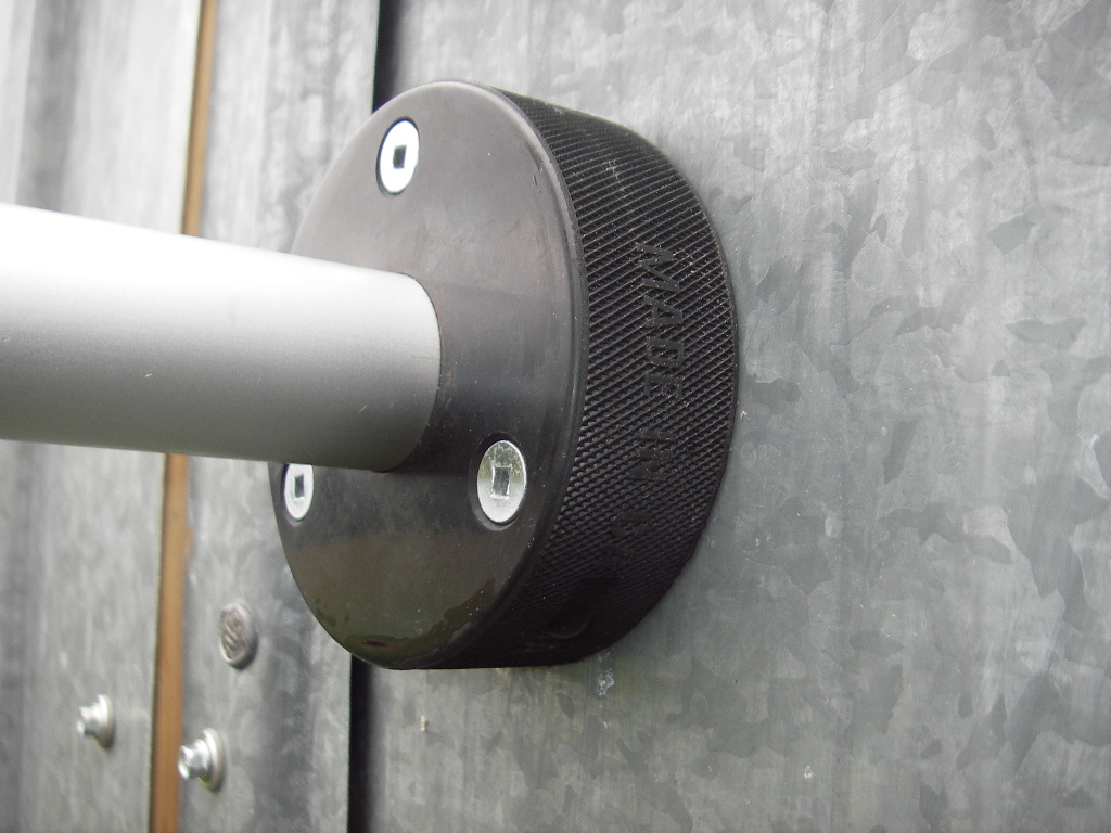

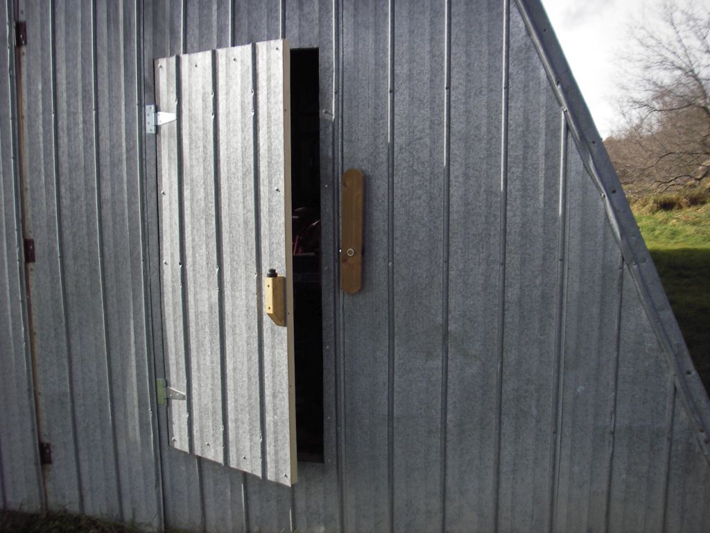

I finished the door today by putting a latch on it. If you look up "Cottage latches" you will find all sorts of interesting solutions but way too pretty for a shed.
I don't recommend the hockey puck idea, they are pretty hard if you get one in the ankle but not great to drill 1" holes in.
Outside closed:
Outside open:
I can operate it from the inside too so I can't get locked in:

I like your hockey puck use! Did you use a forstner bit for the 1" holes?
Pawnee
L2501
Jul 1, 2021
356
321
Ontario Canada
^Thanks Larry.
I drilled the puck in 3 steps with S&D bits. The last 1" drill bit left the hole too small so I had to bore it out some.
I got new pucks, maybe old ones would be a bit easier? The smaller holes were not difficult.

^Thanks Larry.
But the new pucks add that nice touch of class to the finished looks!! 😄 Great idea! This area is full of hockey fans. (UND College) Over Halloween weekend there was a non-conference destination hockey game in Nashville, TN and 13000 UND fans showed up for it. Crazy!

Great idea!
We usually do Ok, it depends a lot on the weather doing things in the right order.
Right now Ontario is getting heavy snow.
I can still open the new door without it touching snow but another few hours will change that, I just left a shovel down there.
