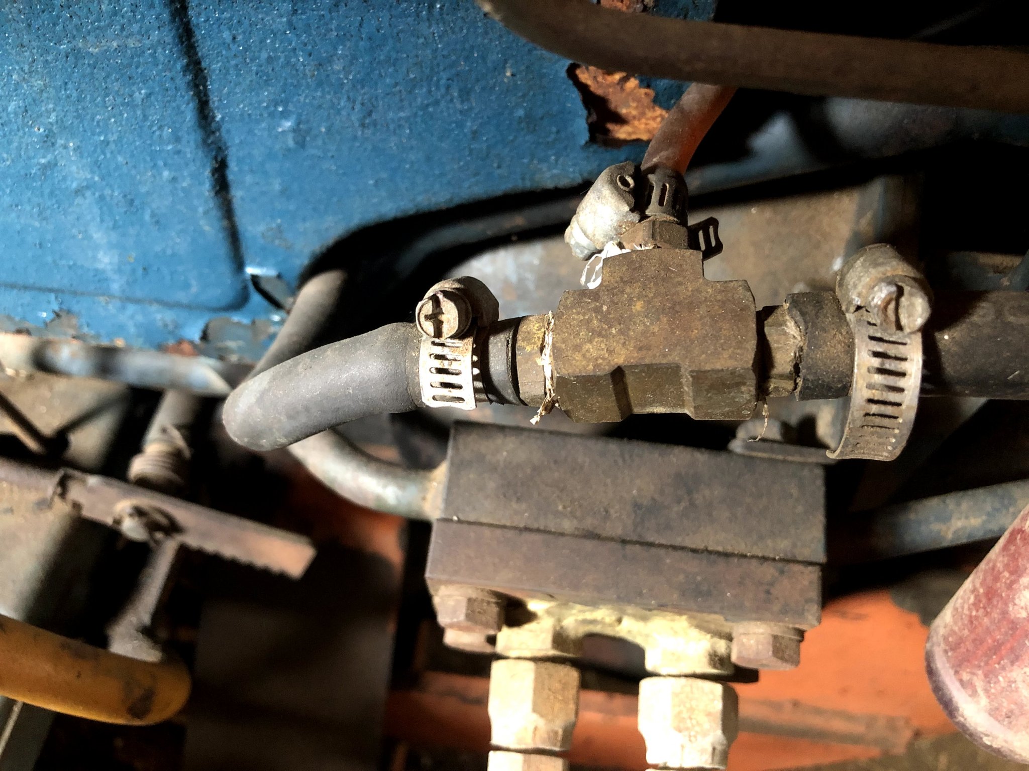

You do not need to drill holes in the tank for a sight guage.
1. cut fuel line just before fuel filter and install a "T" fitting.
2. Connect a piece of clear fuel line to "T" . Run it under tank and up the left side.
3. Cut fuel return line a top of tank and install "T" fitting'
4. connect end of clear fuel line to top "T"fitting.
That's just too cheap and easy. There must be something wrong with that plan! 🤣

re:
NOTHING ! I did the same for my 2000 gallon water tank for the wife's veggie patch.
