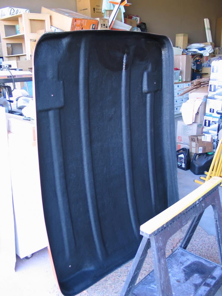

I tried a few mods to my tractor when re-building the hood.
I shot the inside of the whole engine cowl with stone chip (WallyMart DuPont I believe) to give the metal some mass and then painted it. Zero difference. I have foam isolation material and heavy rubber sound deadening material with heavy foil on one side that I thought about putting on the cowl but most of the noise comes out of the HST. And, the strut for the cowl would never hold 40 lbs of deadening material. Headphones are lighter.
The previous owner also severely cracked the fiberglass roof in the accident and I didn't know how bad it was so I pulled the hood but left the roof on. The year of use expanded the cracks and when I removed it for repair, I was shocked. After the extensive fiberglass repair, I shot the inside with stone chip and just left it that way. Looks great and it may kill a little noise but not so much that I could tell. The fiberglass is pretty heavy.
