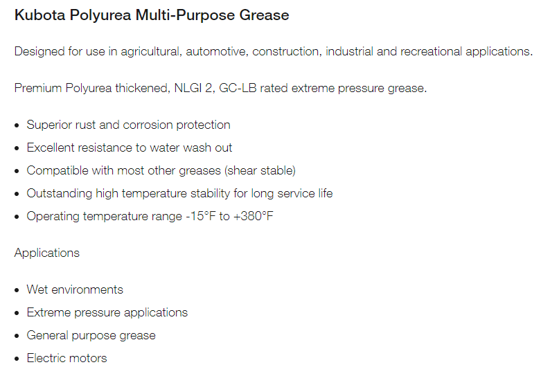

The loader recommends EP grease, and suggests 3%moly. Kubota recommends polyura as an EP multi use grease, as does John Deere. Is it suitable? To me it is as long as it is for the scut/cut plated/chrome/Nickle loader pins sub 1.5”. Would a moly provide more protection? Possibly would, do I need that amount for the loader, probably not. You get more film strength from a higher weight oil, but you get more windage loss too. Every thing is a compromise. I grease often, if I didn't moly would probably be used. KUBOTA does not have to clean up my tractor or pay for pins... I do.
